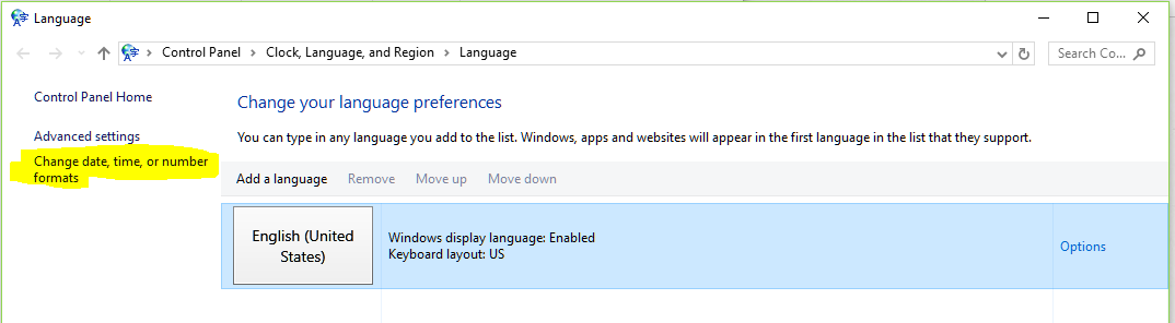

    2/ You aren't suffering from the windows language setting issue in simtools - ie your windows is setup for us english

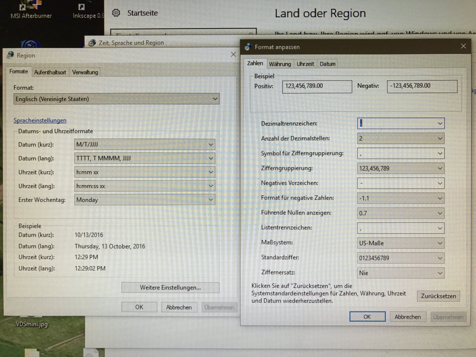

    Double checked what you wrote- everything as described... for the language bug : I have set my system to us time format but system language is still German- do I have to change this too?

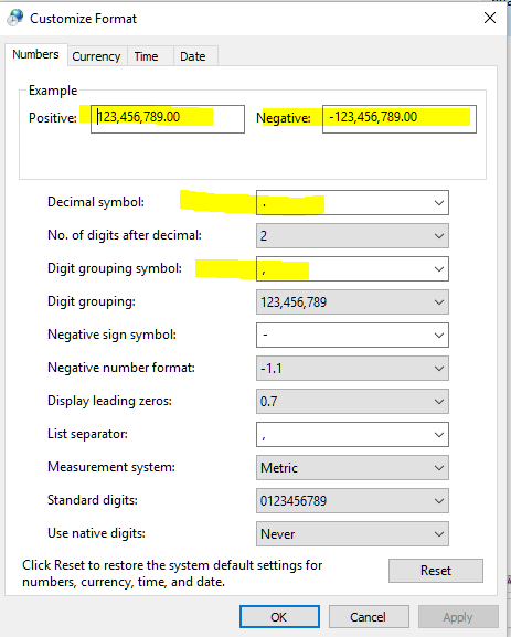

    The language issue is when numbers are printed/displayed using a comma as the decimal point, simtools doesn't recognise it and is looking for a full stop as decimal point so it sends strange values. I believe fixed in the new simtools 2.0 when released.

    Are you sure your windows language settings are not using comma's for the decimal place?

    Checked time and format - it's as you posted
    So this doesn't seems to be the problem.
