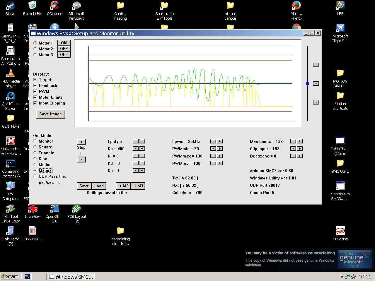

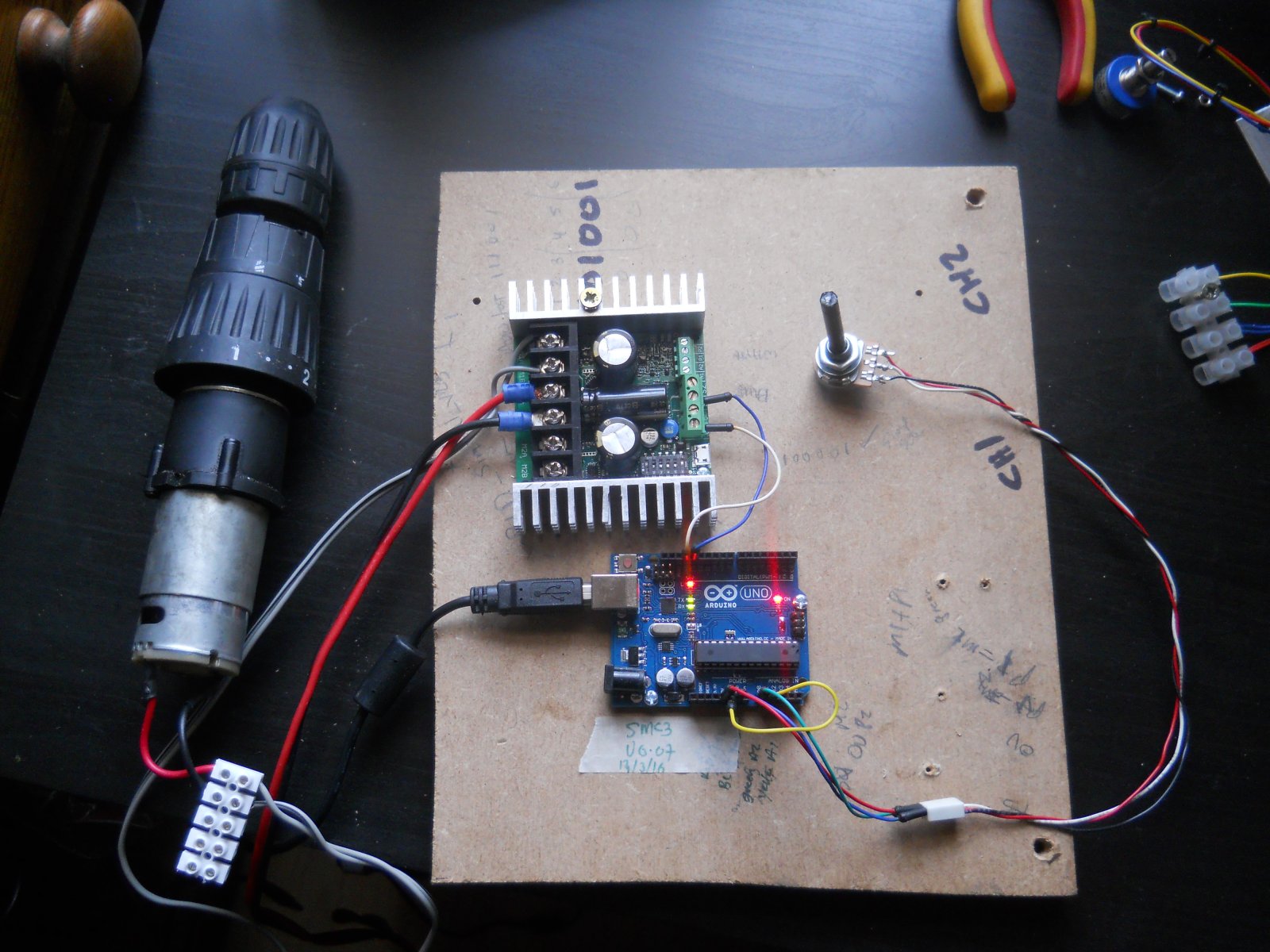

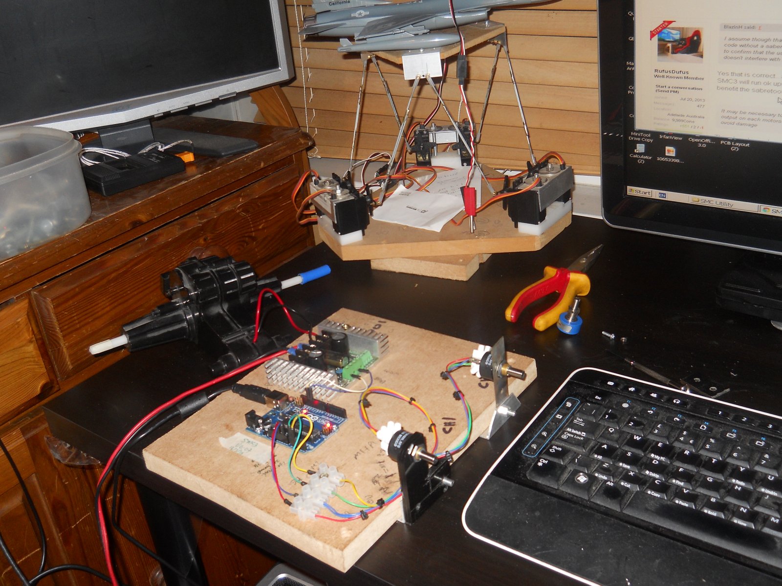

    Hi @RufusDufus.. Finally got a chance to load SMC mode 3 version for the Sabertooth and having a minor issue so need some assistance when you get a chance Please,
    So Ard code loaded, Coms Checked with SMC Code for Mode 3 and SMC utility Program & confirmed as OK,
    I can see the Pot value Line changing as i alter it manually , and Got PWM signal visible in SMC utility .
    Have set up the Parameters as suggested in the Initial setup section of your tutorial ( see attached Pic ) and the DIP switch settings (1-6) are 100001 , i have tried Hall sensor For feedback and now fitted standard 10K ohm rotary Pot , ( PS for the these initial tests, i Grounded the unused A1 Input to stop it floating ,,
    No smoke yet :) but once i power up my sabertooth 2x32 the motor is spining ??? when it should be stationary .. All the Values are set to Zero as per instruction but as always i may have missed something silly ,,
    I have had this situation before with the sabertooths and its typically to do with wrong dip switch settings ..
    later on during testing i bumped up the KP value to the recommended 400 and upped the PWM Max , now the motor goes Loopy ( very rapid back and forth) fighting i suppose for direction ( now i smell Burning at the motor but least no smoke ) so quickly stop the test ( tried with 2 different motors same result , so im thinking controller setup issue!) ..
    am i right in thinking that once i get the motors running i should be able to control speed and direction based on where the POT is set? and its only once happy with this level of control would i link the pot Physically to the Motor..
    you guys know me always with the long posts but just trying to explain where i am with this trial at the moment ..

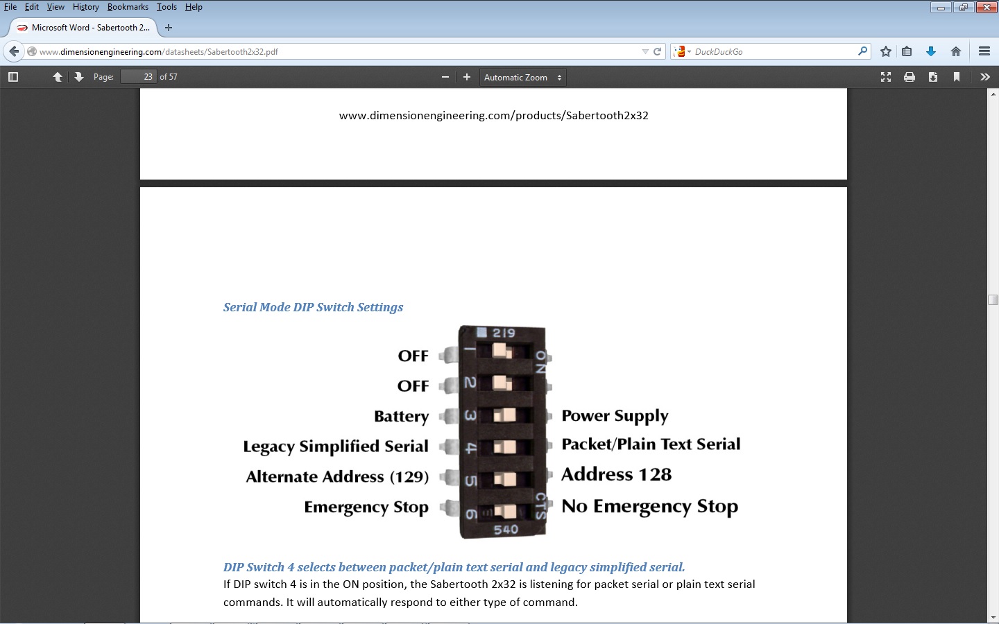

    Yep! That's at least one of your problems. The newer 2x32 has some nice new features but they broke backwards compatibility with older sabertooth models to do it. Therefore, I suggest you start reading up on the documentation for your model. http://www.dimensionengineering.com/datasheets/Sabertooth2x32.pdf
    Note: The SMC3 sabertooth sketch uses Simple Serial, now called Legacy Simplified Serial.

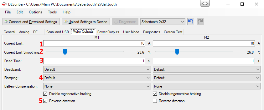

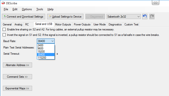

    The SMC3 Sabertooth is set up to use a 38400 baud rate. In order to do that on a 2x32 you must use Describe to program the "user-defined setting" to 38400 and then set dip 5 OFF.
    Or, for initial testing, set dip 5 to ON and change the baud setting in the SMC3 sketch to 9600.

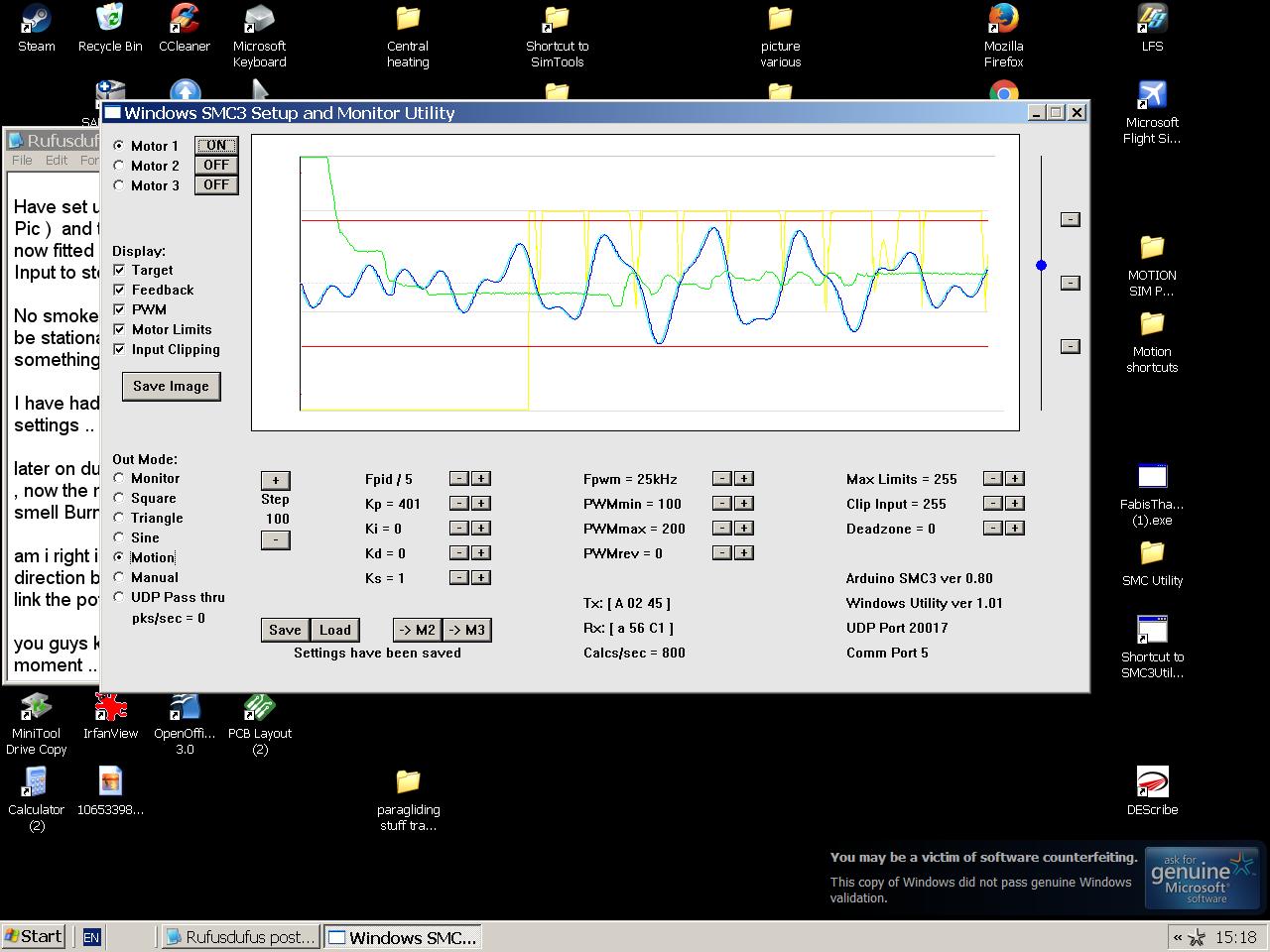

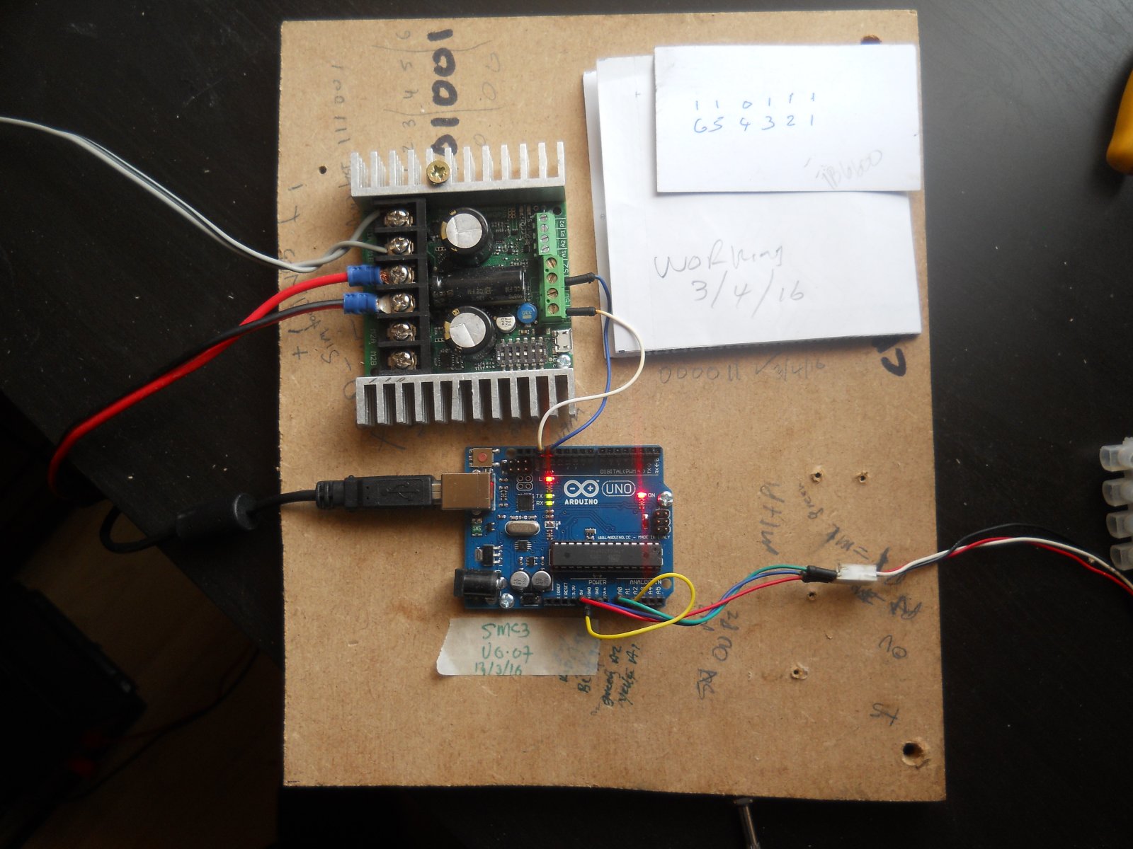

    OK Mini Update , Thanks for the tip @BlazinH had a play this morning double checked DE settings and Once again changed the DIP switch Settings ..also changed some of the SMC utility parameters and Voila :) she lives LOL
    OK so my setup is as Follows
    Ardunino Uno
    SMC Utility V0.7
    SMC Code With (Mode 3 Revision)
    12Vdc Car Battery ( as temporary Test Supply )
    Sabertooth 2x32 ( Dip Switch settings 000011) Describe Baud rate set as 34800,
    Ard TX ref pin 13 to Sabertooth RX S1 & Ard Gnd to 2x32 0v Terminal
    10K pot connected to Ard as per Standard SMC Config . Will Try Hall effects sensor later today
    Good News is i now have the whole lot Running ( No Smoke , No Dodgy Motor Movements, and Motor direction /speed now under full pot control ( Phew) , so i just need to do fine tuning to get the optimum settings for SMC Utility Testing ,,
    See Attached screen shot of my Sortta Working parameters ( all of which will need to be refined ....
    Once i understand how to get the best out of SMC Setup , my intention is to use SMC to test my Linear actuator Project ..
    Once again i'd like to Thank you guys for getting me this far with and the promise of good things to come ,, Special thanks to@Rufusdus & @BlazinH For this Sabertooth Controller Option , Early days in testing at moment but looking good even with my rough and ready test setup :) Cheers Guys

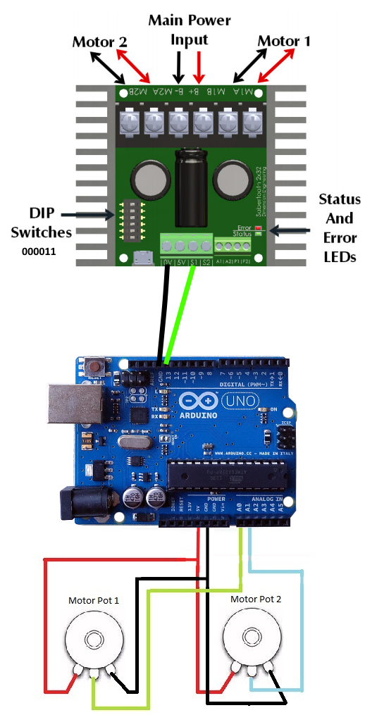

    Mode3: Design for Sabertooth. The common Sabertooth 2x32 is a dual channel motor driver capable of supplying 32 amps to two motors, with peak currents up to 64 amps per motor. It can be operated from radio control, analog, TTL serial or USB inputs. It uses regenerative drive and braking for efficient operation and supports baud rates up to 115 200 baud.
    Important: When SMC3 is in MODE3 it can only drive two motors.
    Installation:
    1. Wiring details for Sabertooth 2x32. Pin 13 on the Arduino is the Tx serial line that connects to the Sabertooth
    2. Set the DIP switches on the Sabertooth to 000011
    3. Use the default Windows SMC3Utils software to configure the PID parameters
    4. Set Fpid / 5 so that it does not overload the serial comms to the Sabertooth
    5. Set PWMmin to 0
    6. Set PWMmax to 255
    7. Set the Sabertooth to simplified serial mode using 38400 baud (Describe software):
    8. More Describe Settings:
      1) Current Limit: This setting sets the maximum current for the motor output. If the system tries to draw more current than the setting, the output duty cycle will be reduced. For Sabertooth 2x32, each motor output can be limited individually in a range between 0A and 64A. This is a soft current limit, and will slow acceleration but allow motor motion to continue. There is also a fixed hard current limit above approximately 70 amps which protects the Sabertooth from a shorted motor.
      2) Current Limit Smoothing: This setting changes how quickly the current limit responds. More smoothing will cause the Sabertooth to ignore small overcurrent spikes for smoother operation.
      3) Dead Time or Deadband: no changes needed.
      4) Ramping (can be useful for less aggressive movings):Changing the selection to Customallows for a pre-defined, fixed ramp speed. The Ramping time is the time it would take to go from a full reverse command to a full forward command. Try values between 0 and 0.2s if needed)
      5) Reverse Direction: This check box will reverse the motor output for this channel. No need for rewiring!
