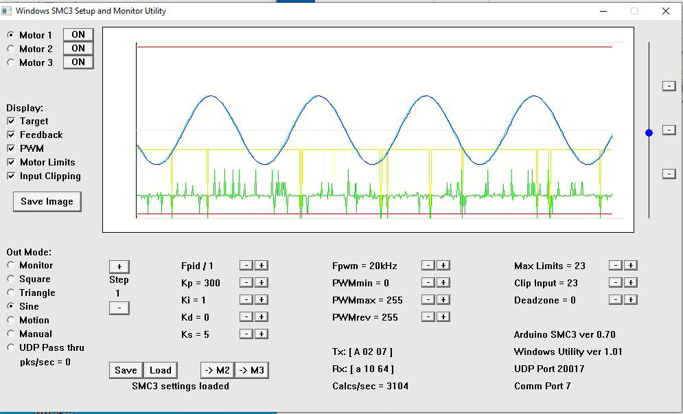

    I have just swapped my sim over to a new computer
    the actuators seem to be a bit lively and dont sit still
    opening up the SMC3 util program shows a noisy potentiometer trace
    the pots are hall effect multi turn
    the problem can be shown in the attached image
    so the only new thing is the computer - Am I right to assume this noise is from the PC power supply going into the usb ?
    has anyone had a similar problem and how did you cure it ?
    (I have tried an isoltated USB hub and the problem still seems to be there)

    While possible I am more inclined to think some cables got moved and may be the source of interference.
    So check cable management and pot connections and consider clip on ferrite magnets, if you are not already using them, and see if any of that makes a difference.

    Hi Noorbeast - you were right
    the computer was plugged in to the same power cable as before, but I was using an extension lead with a usb hard drive caddy, the power supply was not earthed and was giving off a lot of noise - unplugged the coiled up extension and the usb/drive/power supply -- problem gone :)
    motion back to being silky smooth

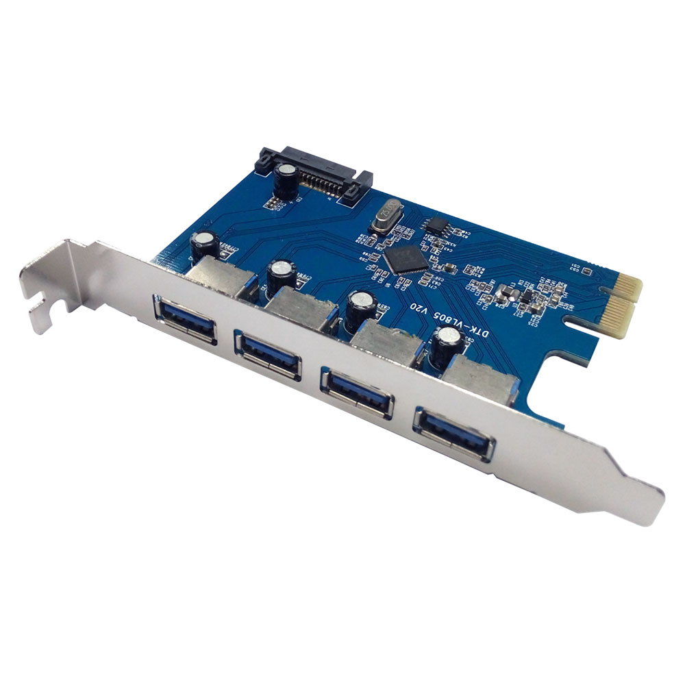

    power supply, when i try to connect my rig to laptop its smooth but in my gaming pc there is alot of stutter in the green line , i tried to remove all usb from the computer and use the motor usb only but still same, i'm thinking now in grounding the pc case (cable from powersupply screw to wall), you think its good sulotion or i should buy Pci to usb like this one

    but i tried everything nothing fix, i will try to ground pc and see what happend if not helped also i will but Pci to usb
