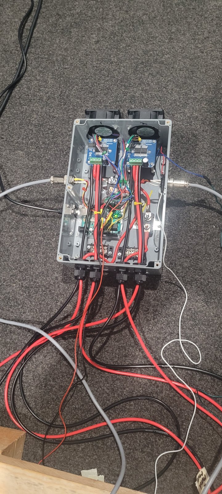

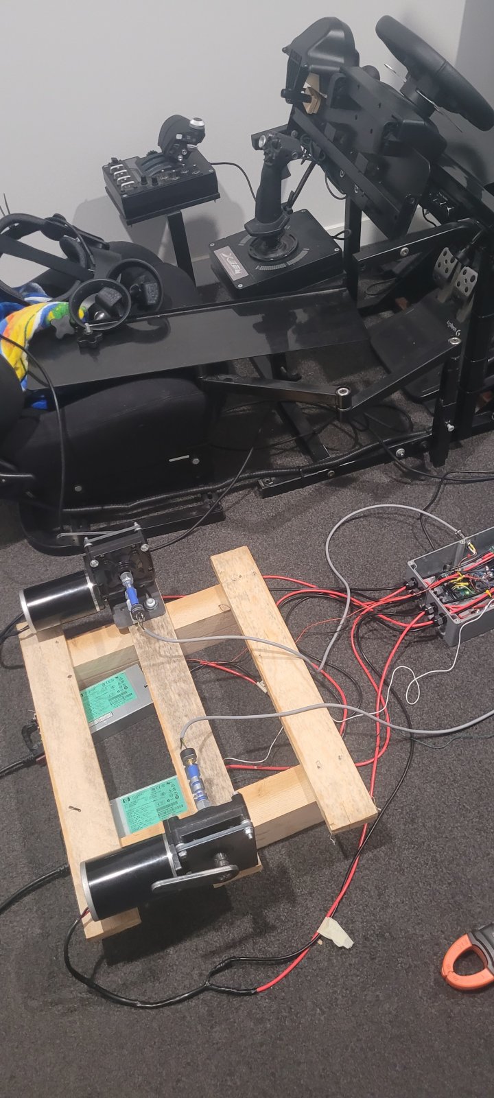

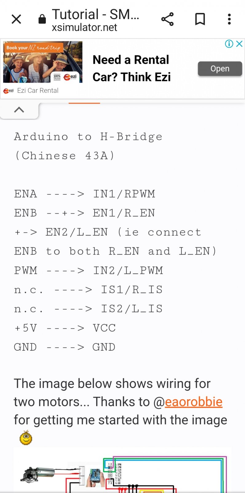

    Hi guys
    Well 6 hours later and my 1st demo run did not go so well.
    I really am struggling to set up the smce utilities and get the correct file in the sketchpad.
    Problem is I keep downloading the smc3 files and although I have the correct comm port in notepad when smc3 opens the comm port is wrong.
    My head is completely done for now,just going around in circles.
    Does someone have an idiot proof tutorial for setting up a sketchpad folder and getting smc3 installed
    My rig info is as follows
    2x 12vdc motors from motion dynamics
    2x ibt 2
    2x dps1200 server psu
    2x 180 degree hall pots

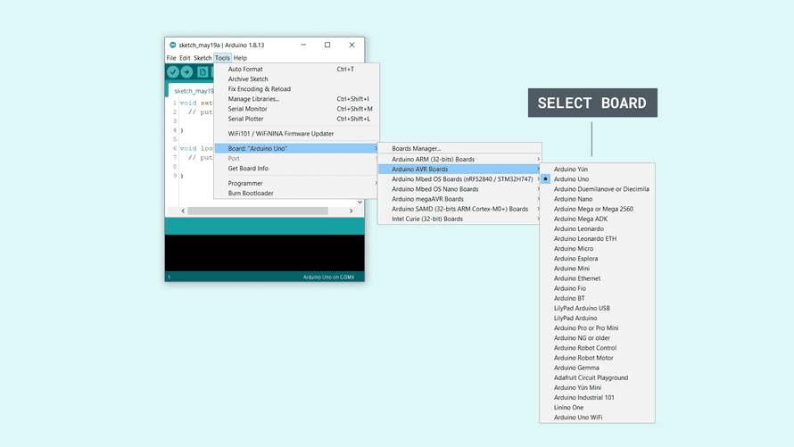

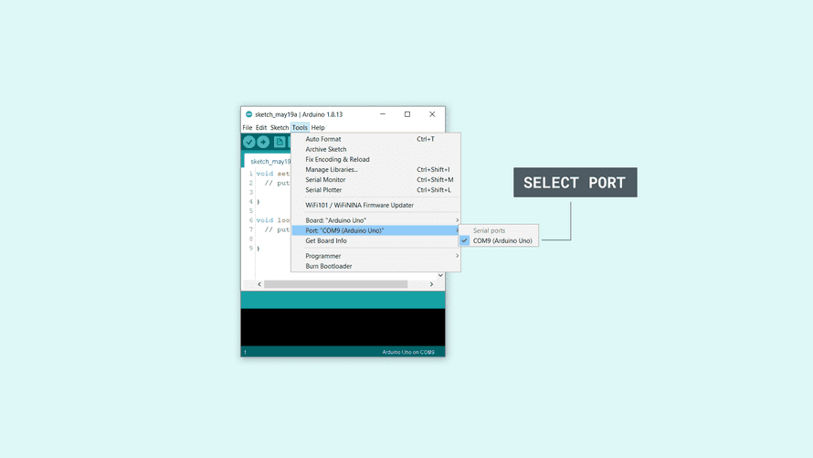

    Have you set the correct Arduino IDE Board: Tools > Board > Arduino AVR Boards > Board > Boards Manager
    And Arduino IDE comport: Tools > Port

    Yes all good

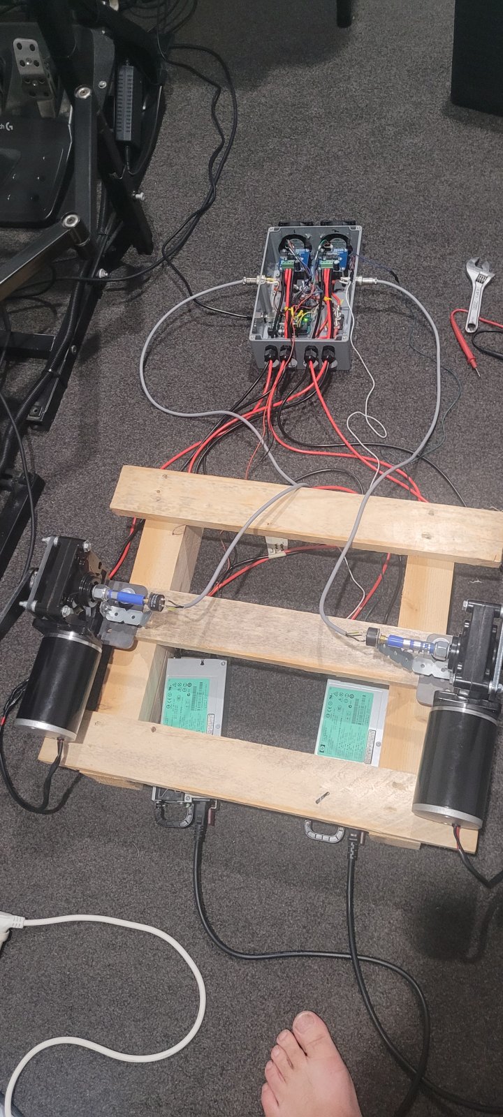

    So now have one motor working as expected.
    Unfortunately motor 2 is not playing ball.
    If I move the pot by hand I get an expected signal.
    When connected and say on sine it just stays flat it does not move the motor or try to track the sine at all.
    21,513
    150,698Coins
    +11,018 / 55 / -2
    If one motor works and the other does not then first check the wiring.
    If the wiring seems OK swap the hardware from one motor to the other and report if the problem follows or not.

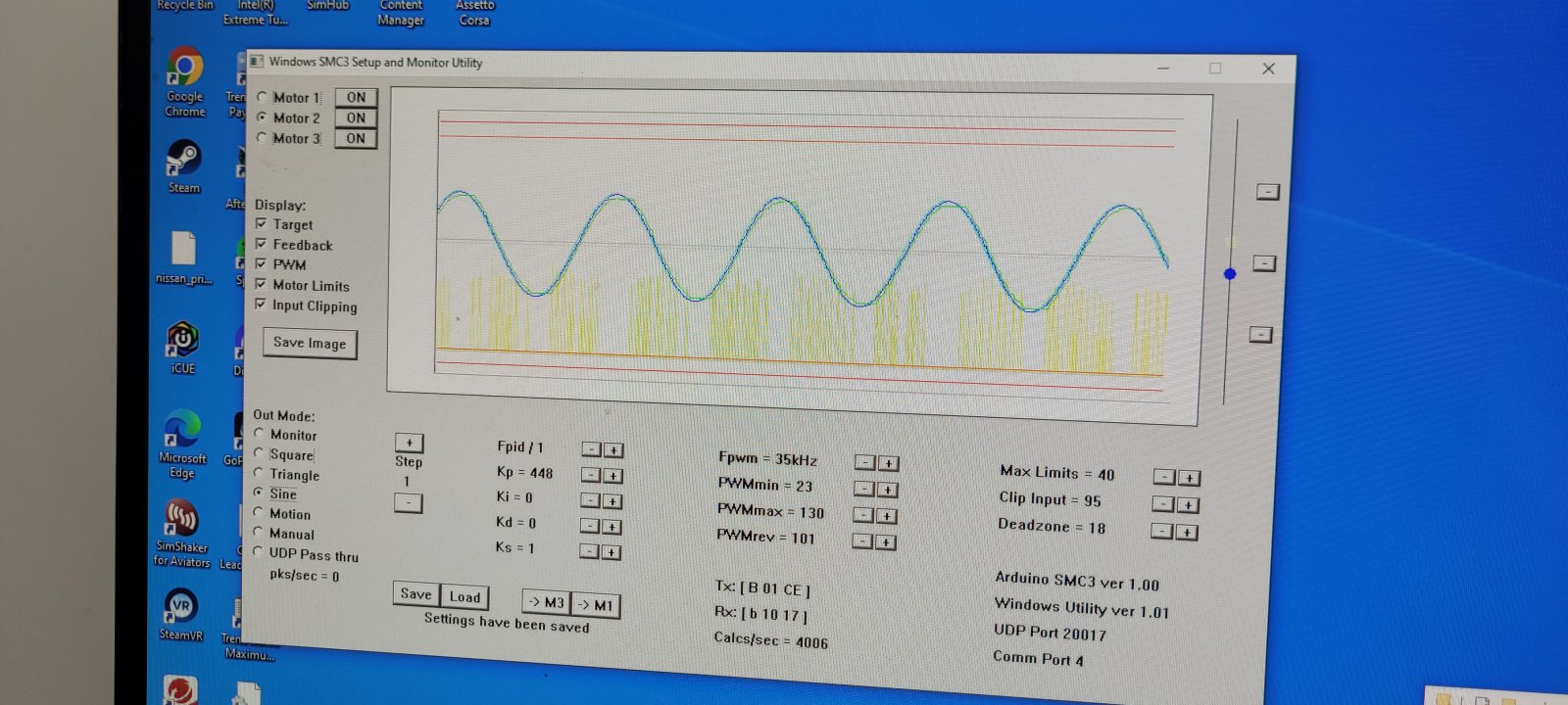

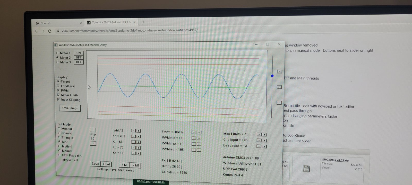

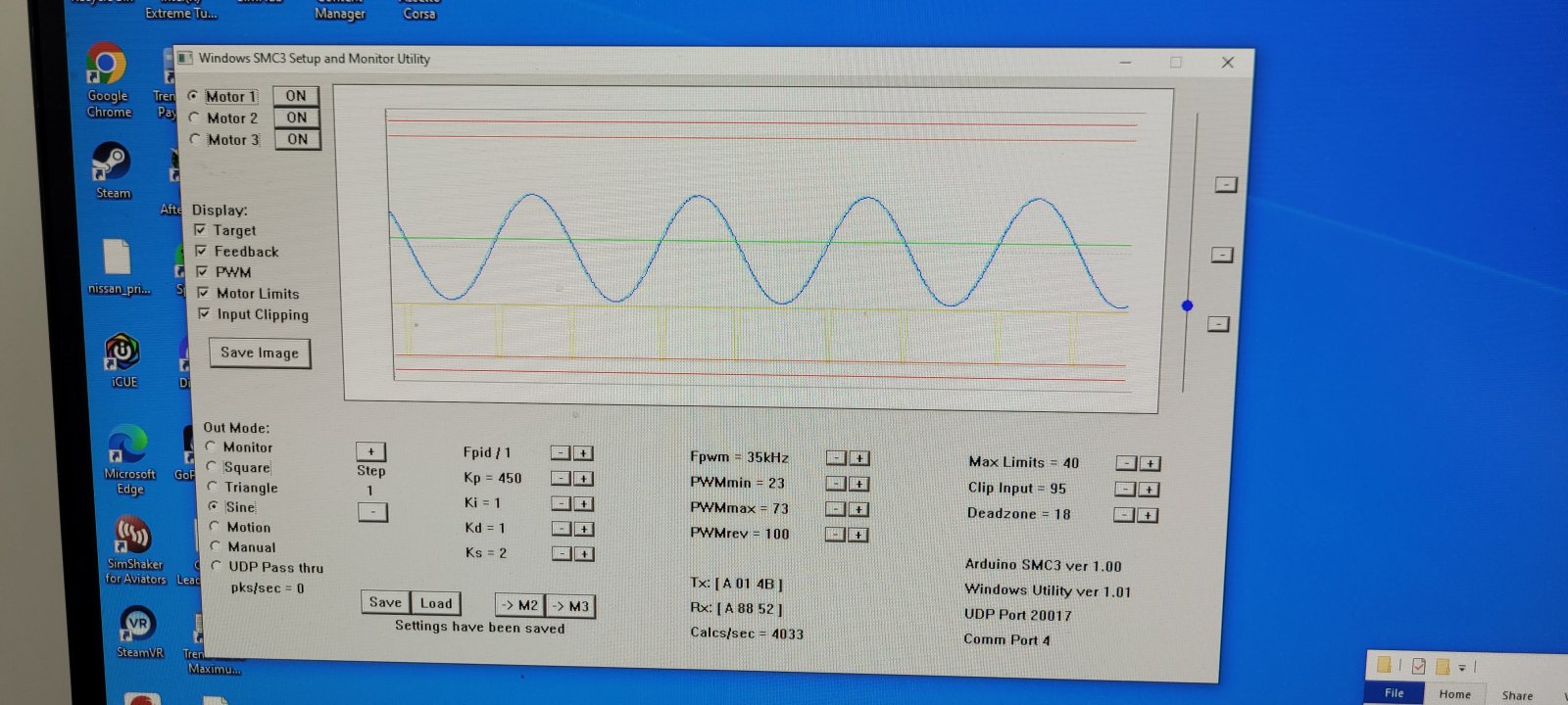

    OK guys I'm now 15 hours in and no closer to finding the fault.
    I have 1 motor running on my 2 dof mock up rig all ok...
    But the 2nd motor is no go...
    I have swapped power supplies,ibt2 over,potentiometers over and still no go.
    I have included my sine of both motors ,one motor tracks great the other has a solid green line.
    The green line for the pot moves fine if I move it by hand,I get the expected results.
    Unless I have dodgy code the only other thing is maybe the arduino uno maybe.
    Any help at this point would be great fully received 20230423_135600.jpg 20230423_135528.jpg 20230423_085627.jpg 20230423_135600.jpg 20230423_135528.jpg 20230423_085627.jpg 20230422_173731.jpg
    21,513
    150,698Coins
    +11,018 / 55 / -2
    When you swapped hardware did the problem follow or not?
  12. Richardamo1
    Richardamo1 Member
    Apr 2, 2023
    61
    307Coins
    +12 / 0 / -0
    No.
    I have now swapped the 12v motors from one side to the other.
    So the motor curcuit that was all good and working,I just connected the pos and neg wires to the motors over and swapped the pots as well.
    Same result.
    You would think motor maybe,but across 12v it goes fine..

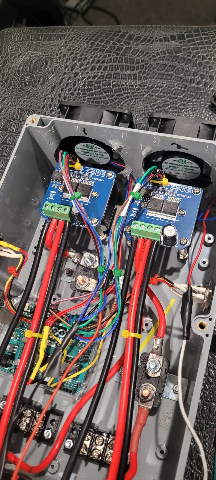

    Did you swap the IBT2s side to side and is the Arduino genuine?
  14. Richardamo1
    Richardamo1 Member
    Apr 2, 2023
    61
    307Coins
    +12 / 0 / -0
    yup ibt side to side and yes genuine,
    im now considering a potential motor failure ,when testing it will not move under sine or manual ,if i just nudge the lever it has tension on it ,just like voltage is holding it but not moving it,if i nudge the lever on the motor a little bit more it will rotate until it goes outside clips

    OK new uno board ...still no go.
    I am totally out now,is it possible there's a code error?
    motor 1 works fine.
    As I say there is some sort of holding voltage on motor 2 its just not reacting at all.
    Have checked wiring again and us all good,even checked continuity between single wires all good
    Help..
  20. noorbeast
    21,513
    150,698Coins
    +11,018 / 55 / -2
    The code has been used by heaps of people so the only change that could affect it is any you have made. But to be sure you can download and install the SMC3 code again.
    Can you check the voltage output with a multi-meter, to be sure power is supplied as it should be to te motor that is giving trouble.
