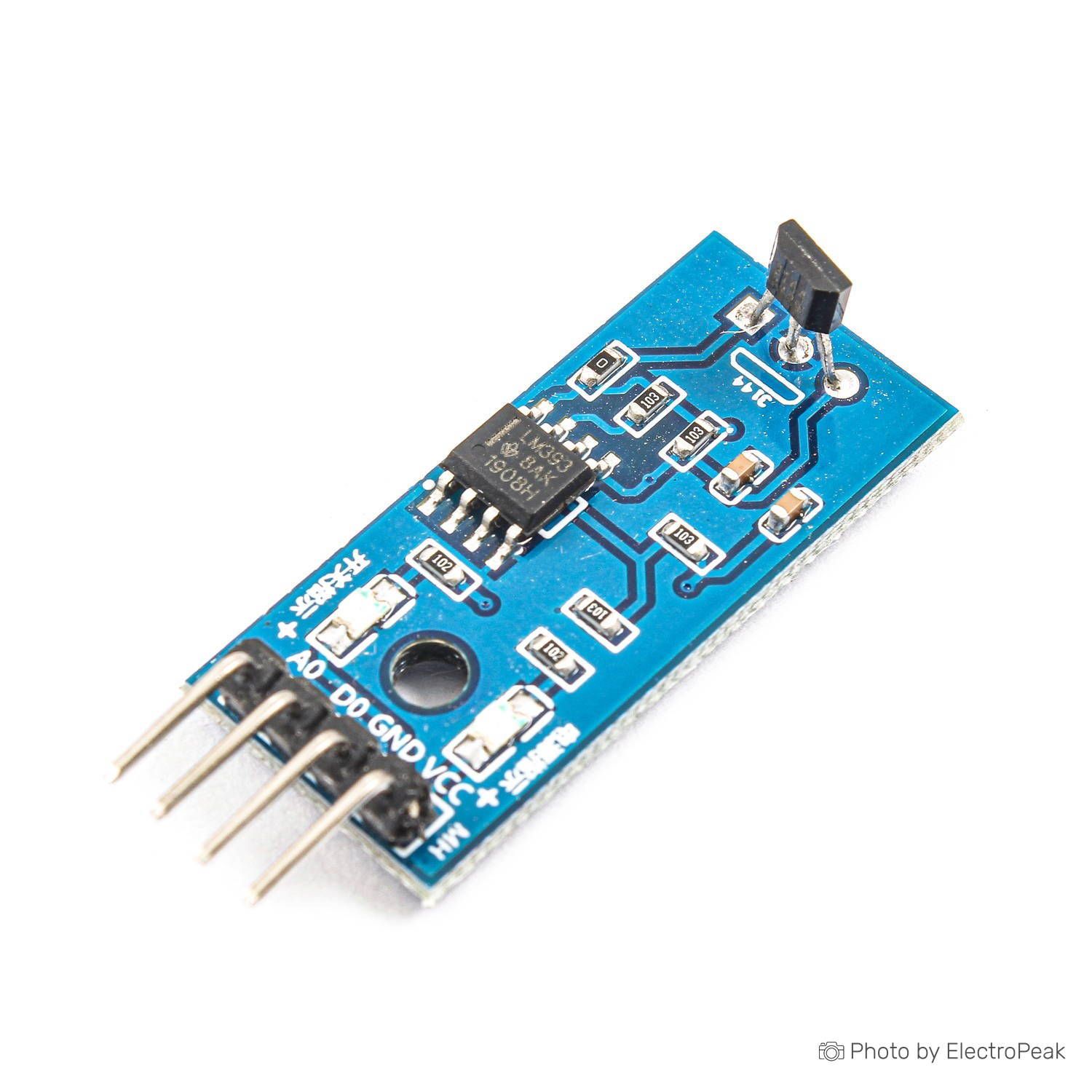

    Hi, i have a problem with the hall sensor in the SMC3 (MODE2) program. I bought hall sensors on the LM393 PCB with analog and digital outputs because I have to limit the angle of the motor due to its design, I decided to buy them because they are relatively cheap compared to hall pots. Everything works fine on ordinary pots, after connecting the hall sensor, the engine does not respond and gets strange readings in the SMC3 program. Need to change something in the code? Or should I use a different sensor?

    Can I check the hall sensor is centered at rest and confirm what number of degrees is its range?

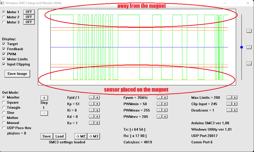

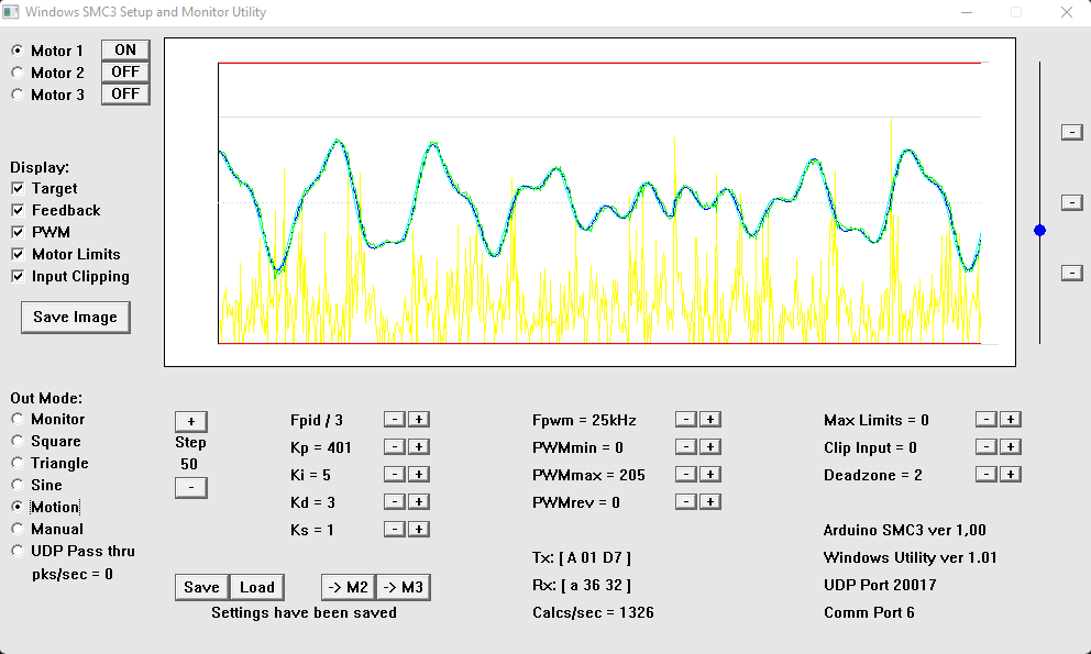

    Sorry for long reply but during this time I bought the proper hall sensors and did something like an inverted potentiometer. everything works quite fine, after the initial configuration i get a graph like below, is it okay? The only thing that bothers me is a slight squeaking from the motor, so far only one is plugged in. The swing range is about 40 degrees (20 up and 20 down) or a little less

    Looks good - is it the gearbox making the squeak ? Try some wd40 or grease

    Try lowering the KD and Ki to get rid of that squeak that engine noise motor noise or change the Fpwm to a different frequency
