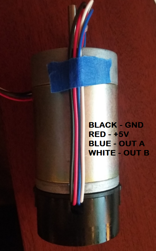

    I have been following this forum for awhile now and am going to start my DIY build with a table-top size simulator first to get familiarized with all the software and electronics before I invest into a large scale rig. I am going with a 3DOF seat mover design (two motors in the back for roll/pitch and one on the bottom for yaw or heave). Ultimately, I'd like to use linear actuators (like SCN5 or SCN6), but I plan on using 24V Hitachi DC motor with encoder (and possibly make them into linear actuators) for small scale.
    I am following the SMC3 guide written by RufusDufus.

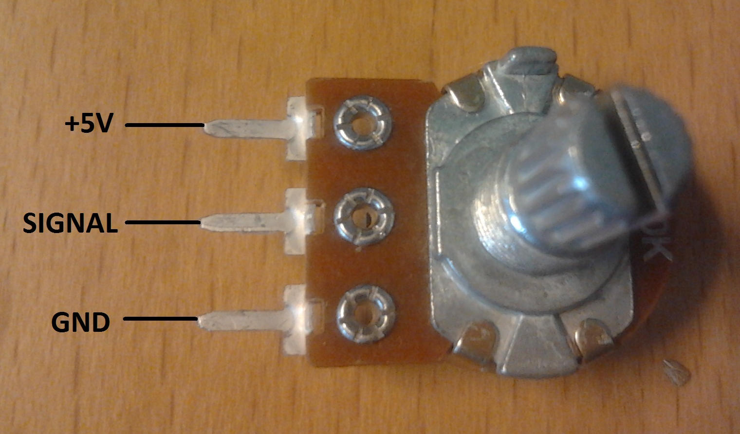

    Although I have 10k ohm potentiometers, I am wondering how I can go about using the encoders on the motor. Would SMC3 be compatible with the encoders? I know for potentiometers/halls (3 pins), the feedback pins are A0, A1, and A2. However, the encoders have 4 pins, two of which are Output A and Output B (see images). This potentially means I need to use A0 and A1 for Motor 1, A2 and A3 for Motor 2, and A4 and A5 for Motor 3.
    This is my first time working with the encoder so I am not sure if I need both Output A and B. If it is possible to use the encoder, what code/components do I need to modify?

    It's not impossible to use encoders but would be a reasonable change to the SMC3 code.
    Quadrature encoders send pulses on both the A and B signals which need to be monitored and depending on the current state and which one changes dictates which way the encoder/motor is turning. So the first thing you would need to do is write some functions (most likely ISR's) to do this - or find some prewritten libraries.
    Next this just gives a direction and step count, not an absolute position. So you need some way find a known position at power on and then keep track of all the steps from there. This is usually done by driving the motor one way until it hits a limit switch and then use that as reference zero.
    The next challenge is the ppr count on the encoder. The poor little arduino is working pretty hard on the PID calculations so if the ppr of the encoder is too high it might have trouble keeping track of all the pulse changes.
    I have seen somewhere that there was code for driving stepper motor... this might be a better place to start as I think they kept track of the steps of the stepper to track position - but I could be wrong.
