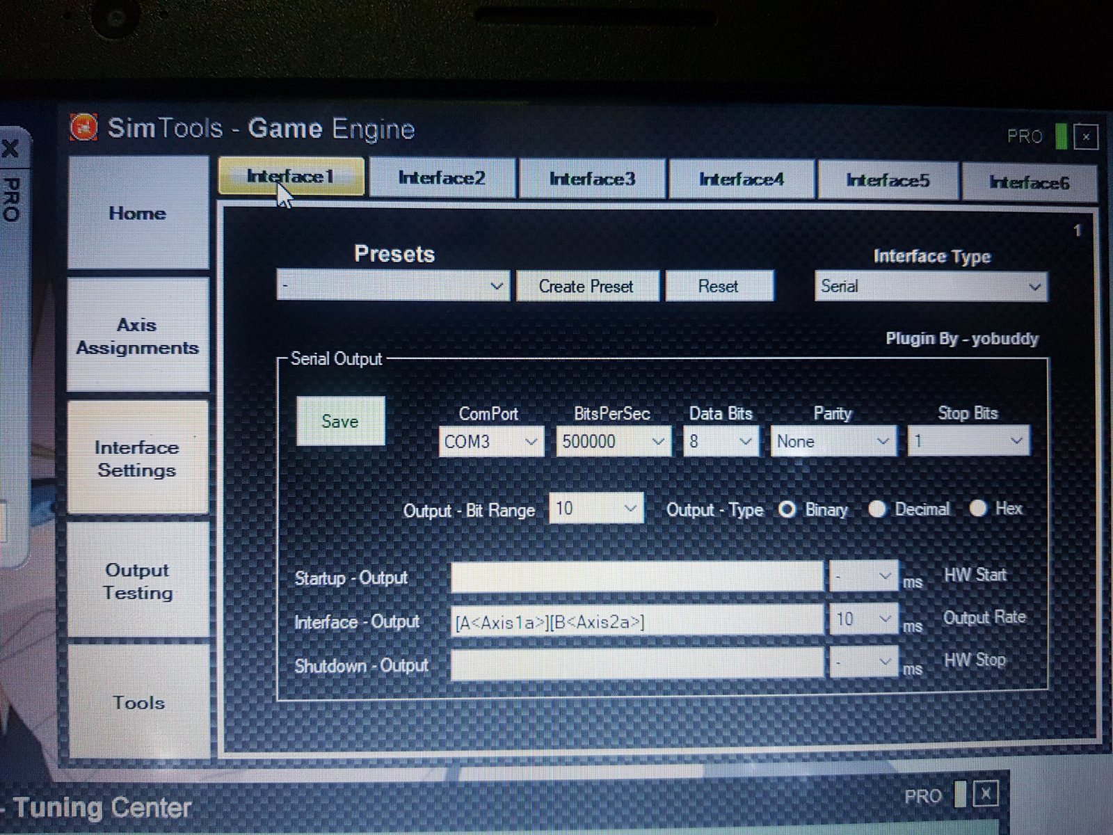

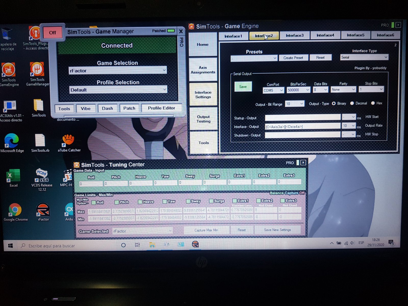

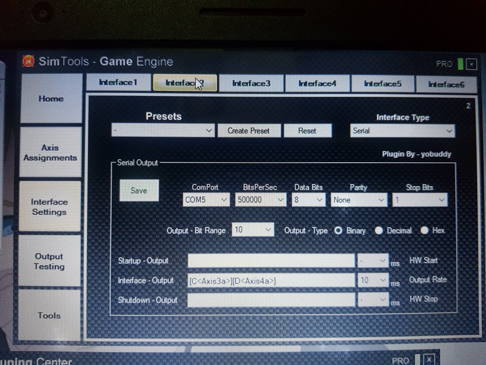

    One question I am about to test the 4 motors ... but at the moment I want to assign the com port to interface2, the com port 5 does not appear, which is the one that marks the second arduino. com 3 is engine 1 and 2 and com 5 is engine 3 and 4 but in interfaces 1 and 2 it gives me only com 3 port .... because it will be. I already have it fully configured with the smc3. There I could fix it ... it was to restart the machine just ... another question I have movement in the interface1 port com3 motor 1 and 2 and I have no movements in the interface2 com5 motor 3 and 4 these settings are fine. 20201128_203404.jpg 20201128_203345.jpg
  12. noorbeast
    22,048
    153,884Coins
    +11,154 / 57 / -2
    What are your corresponding Axis Assignments?

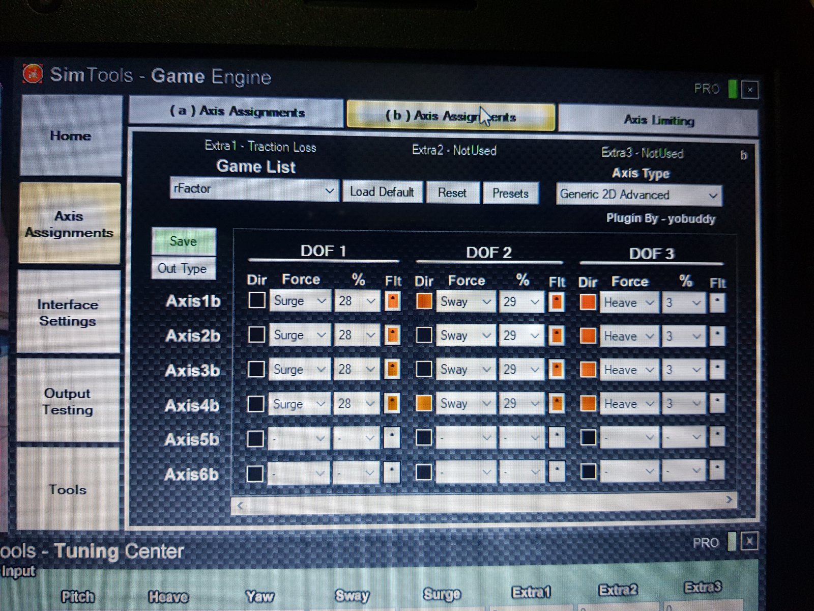

  13. moaale
    moaale IAN MRTIN
    Jun 29, 2011
    170
    NN
    ARGENTINA
    96Coins
    +41 / 0 / -0
    2DOF, DC motor, SimforceGT

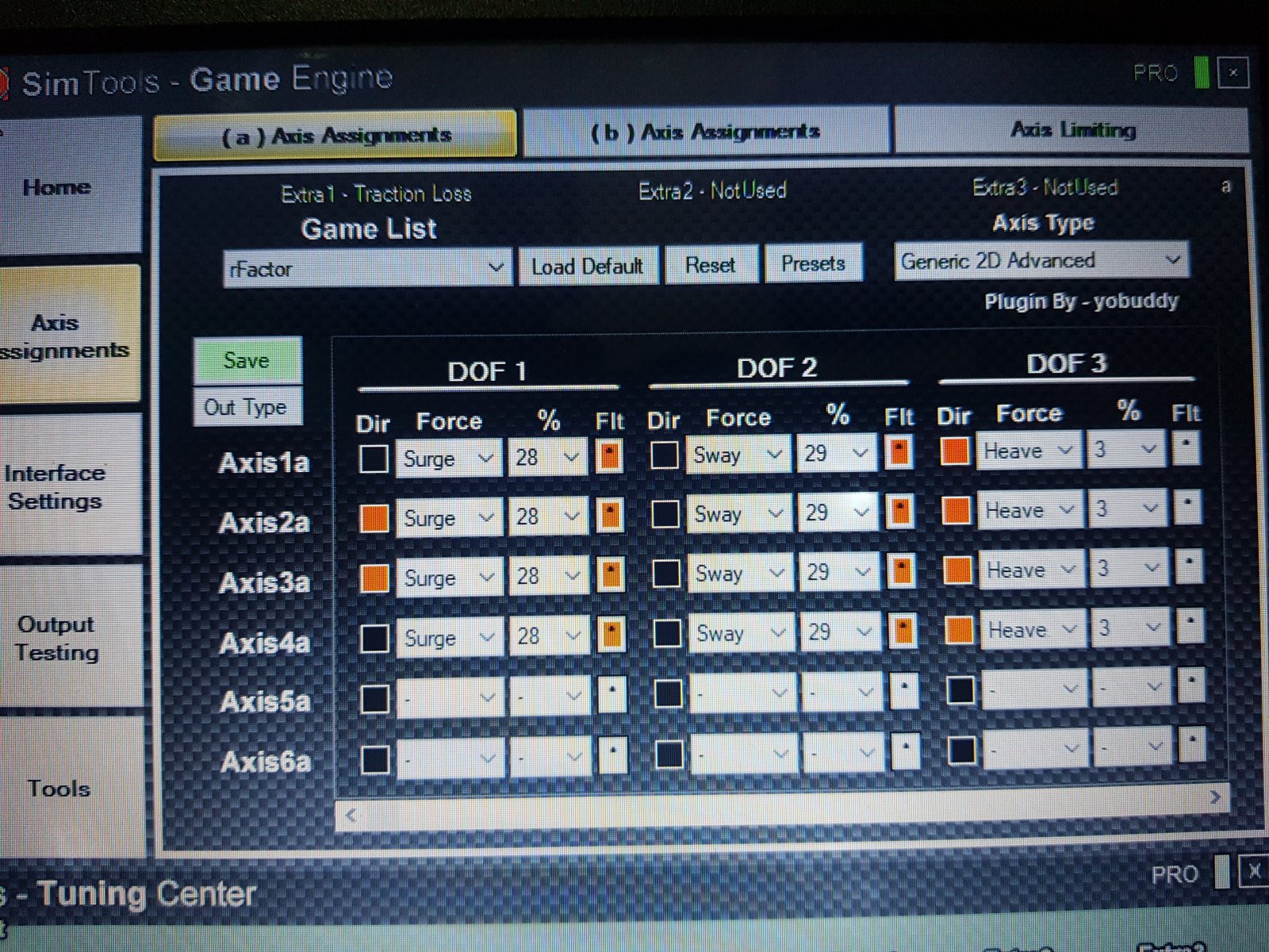

    these are the assignments I have axis assignments. 20201129_012840.jpg 20201129_012831.jpg
    22,048
    153,884Coins
    +11,154 / 57 / -2
    You should not use (b) Axis Assignments.
    You only use the (a) Axis Assignments as you have here:
  15. moaale
    moaale IAN MRTIN
    Jun 29, 2011
    170
    NN
    ARGENTINA
    96Coins
    +41 / 0 / -0

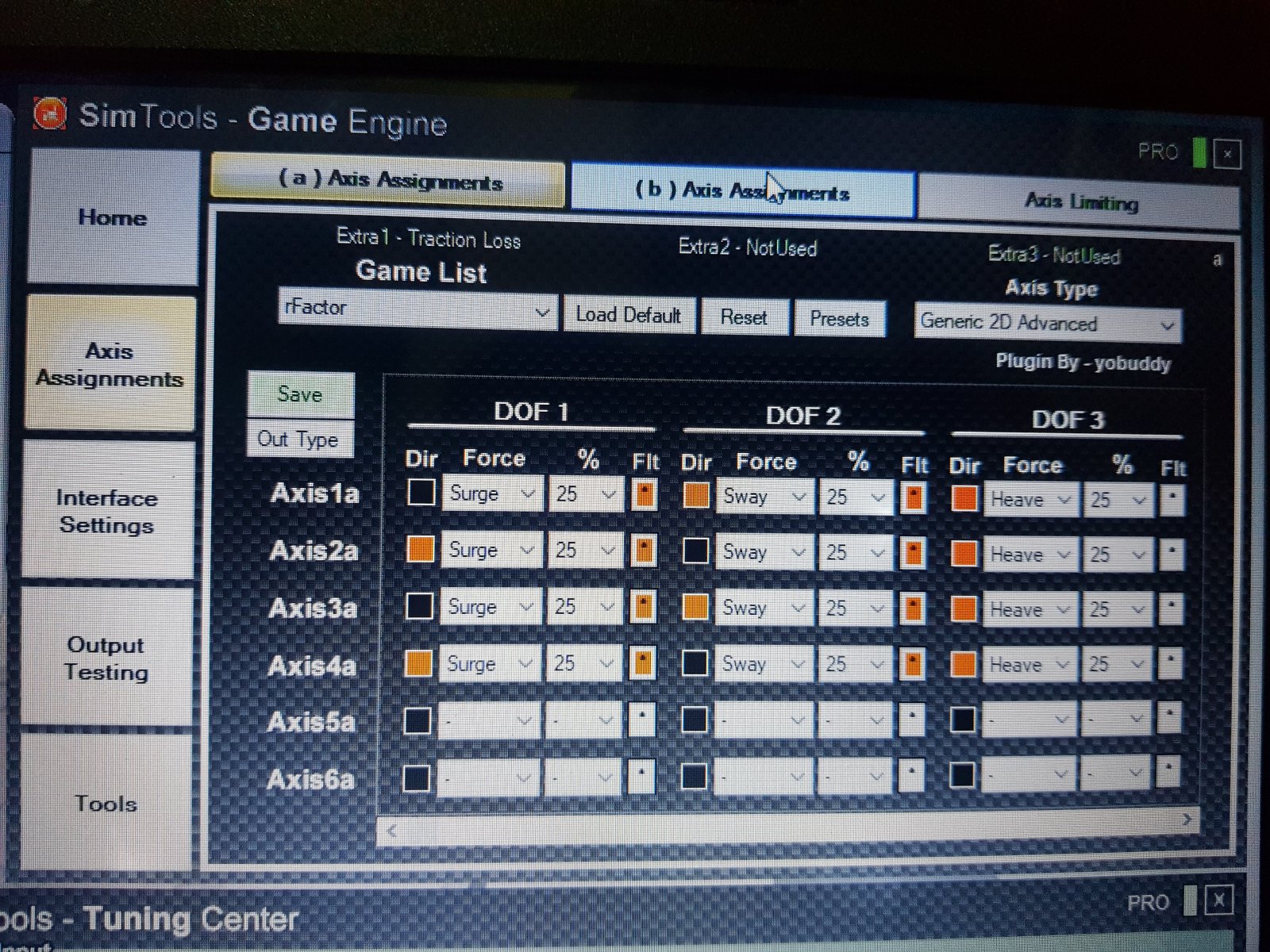

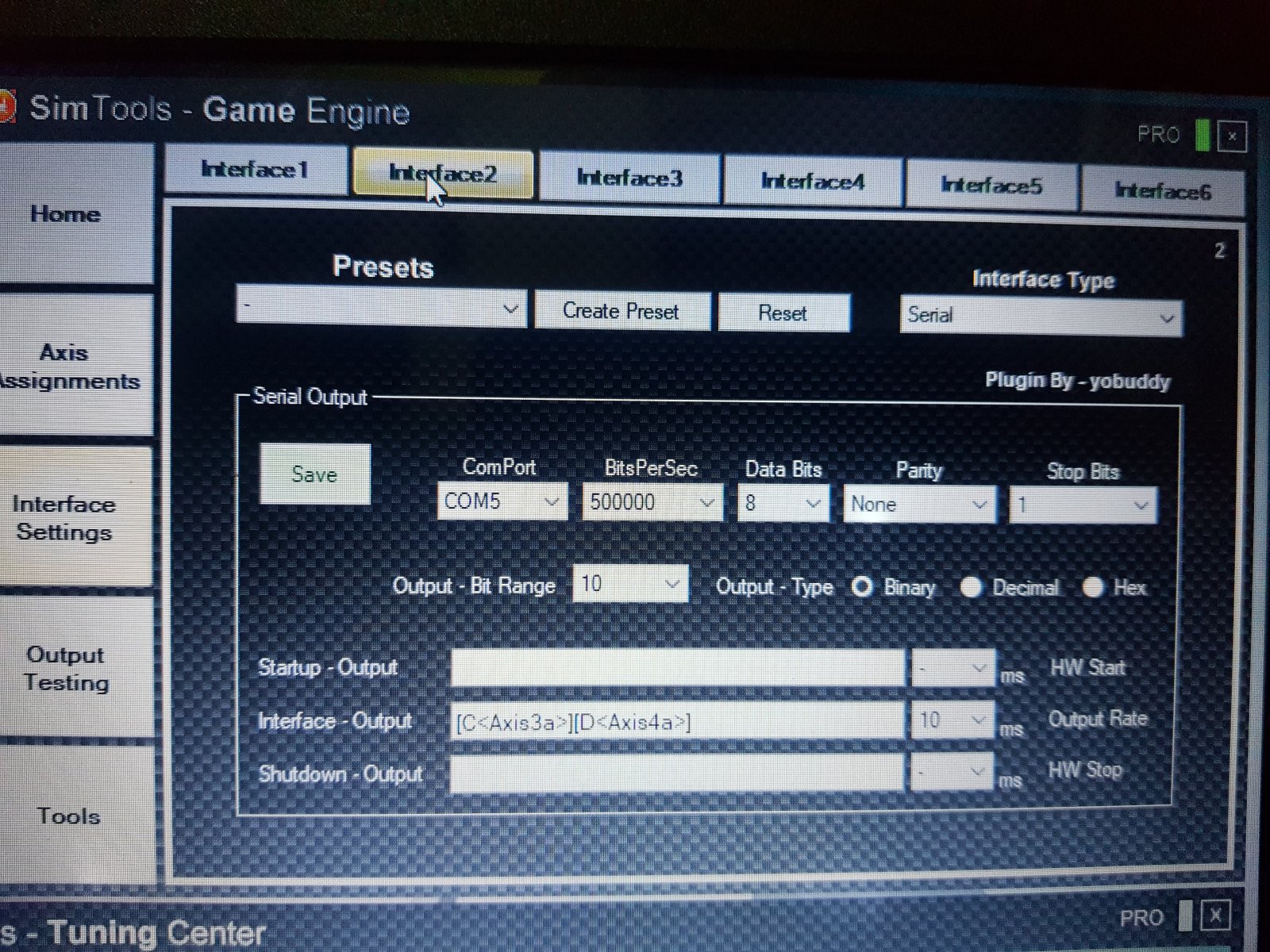

    Hello sir, there is cancel the assignments b and leave the a ..... 20201129_113628.jpg but I still do not move .... in the smc3 engines 3 and 4 are perfect ... a question in interface2 are the parameters fine. 20201129_113700.jpg
    I put the interface - output of engine 1 and 2 [A <Axis1a>] [B <Axis2a>] in engine 3 and 4 and they work perfect, all 4 do not work together with these parameters INTERFACE1 [A <Axis1a>] [B < Axis2a>] AND INTERFACE2 [C <Axis3a>] [D <Axis4a>].
  16. noorbeast
    22,048
    153,884Coins
    +11,154 / 57 / -2
    Double check the port is correct, as the rest of the Interface Settings looks OK.

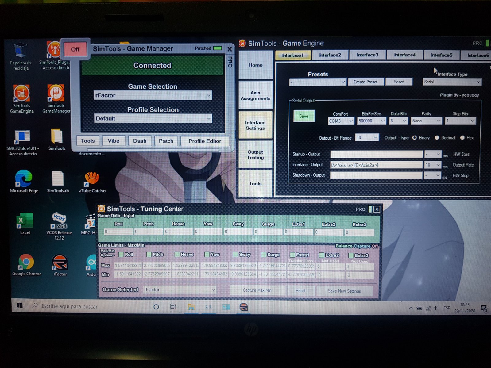

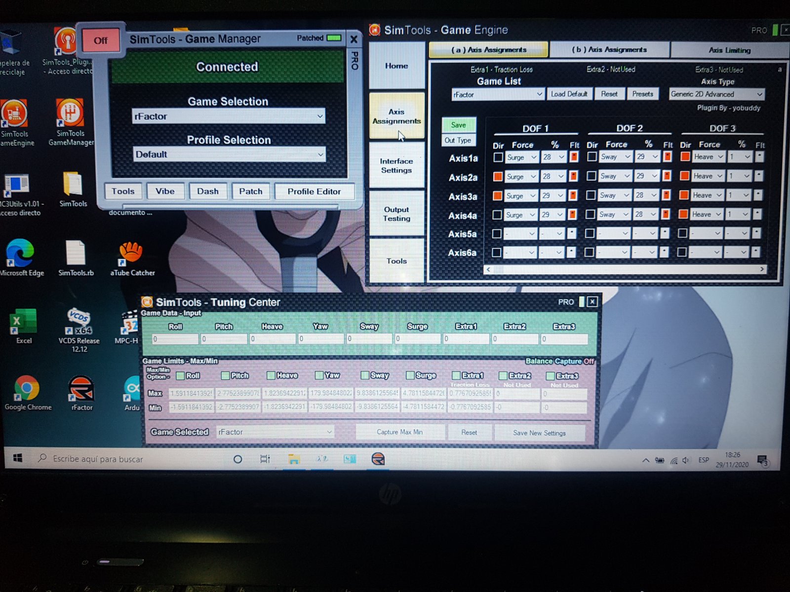

    Everything is as seen in the photos but I have no movements in axis 3 and axis 4 that would be the two in the back with the second arduino the MM and the 2 new motors 20201129_182546.jpg 20201129_182600.jpg 20201129_182616.jpg
  18. noorbeast
    22,048
    153,884Coins
    +11,154 / 57 / -2
    The Tuning Center is not getting any data. Before messing with RF can you please verify Output Testing and in Live For Speed, as both are specifically for diagnostic and testing purposes.
  19. moaale
    moaale IAN MRTIN
    Jun 29, 2011
    170
    NN
    ARGENTINA
    96Coins
    +41 / 0 / -0
    There I have been testing different configurations in the 1 and 2 interface and I could find the configuration that I think goes when I move arises in output testing the two forward motors are lowered when I brake and the rear motors are raised and when I move the motors 2 and 4 on the side sway Right they get up and those of the left 1 and 3 go down, the only thing I have to do is change the C and D of interface2, I was put on Aaxis1 Baxis2 Caxis3 Daxis4 and those of interface2 had no movement ... and now the axis1 and axis3 with A and axis2 and axis4 with B in conclusion, the configuration was like this Aaxis1 Baxis2 Aaxis3 Baxis4. 20201129_202943.jpg 20201129_202935.jpg
