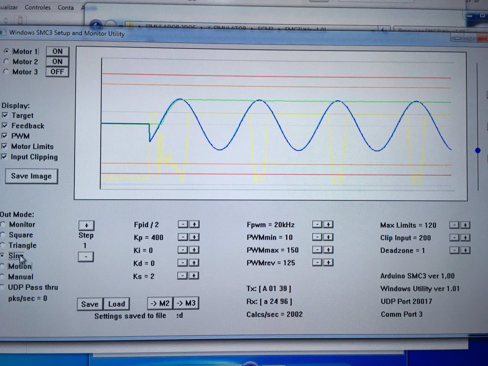

    Hello, please help, I test my engines on the SMC3, start the cycle but stop, it seems that they lose strength, does anyone have an idea of what it could be?
    The engines are weight free in this test.
    Thank you.

    Your green line (the pot feedback) is stopping sending information, or i get it wrong?

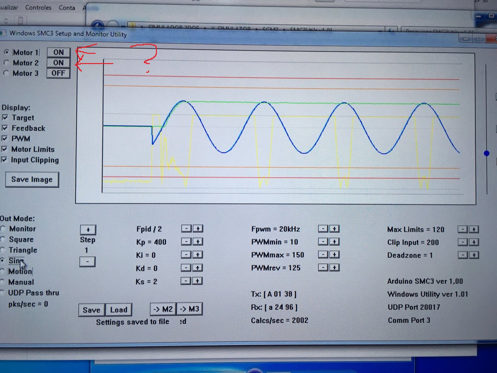

    Hello, I manually activate the potentiometers and the same effect happens, the motors stop.
  9. Bastiuscha
    Bastiuscha Active Member
    Apr 1, 2017
    291
    750Coins
    +191 / 2 / -0
    Do the switches still stay "on", or they turn into "off"? (like on the picture i created)

  11. Marcos73

    Yes, they remain on, and when I operate the pots manually, I cross all limits, but I do not move, it seems that there is not enough energy to move.

  12. Bastiuscha

    Then it looks like it's your motor driver. Or really your power supply is the reason. What you use as driver? There is no error led active?

    OK, THE SOURCE IS OK, I WILL OPEN THE BOX AND CHECK THE H BRIDGE (MONSTER SHIELD). THANK YOU.

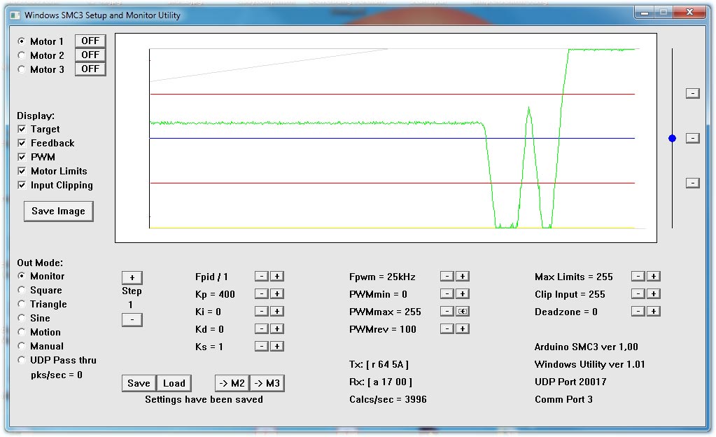

    I build the Same as Mode 2. Arduino Uno R3 with 2 IBT-2.
    I completely wired one IBT-2 to the motor and the arduino board.
    Before i uploaded SNC3 to arduino. If i start SNC3 Utility i can set all to 0 like
    mentioned in the tutorial. After that i power up the motor.
    I went PWMmax to 255 but the motor do nothing. Only one grey line goes up.
    If i manualy circle the pot the green line is moving.
    Is there something in the settings which i made wrong?

    EDIT:
    Nevermind. It is up and running. I now understand max limits and clip. The Potentiometer
    was fully on one side so it allways clips directly without starting the motor. Great.

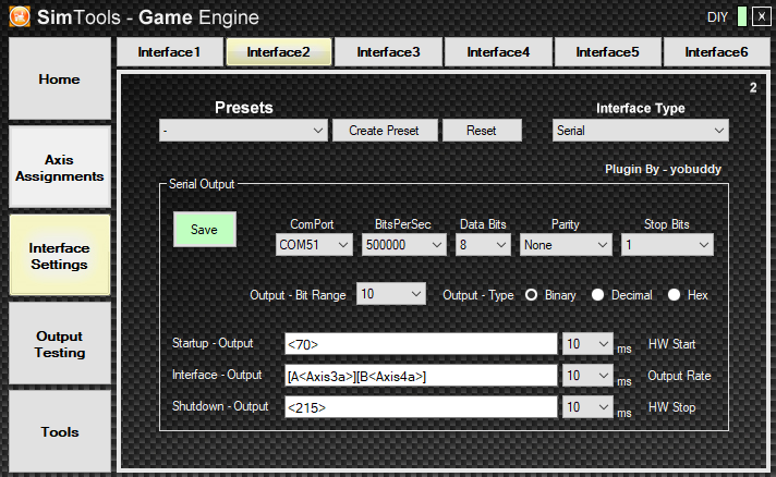

    Hello. I have a serious problem. It seems like everything works. Everything works fine in the SMC utility, but when I load simtools game engine the platform movements become very strange. When I start output testing and start moving the sliders, with a value of "1" the platform moves almost to the maximum and the difference between the values of 1 and 100 is not very significant. I have a 2dof platform. It's almost impossible to play. The platform jerks from one maximum to another (((Once again, in the test utility, everything works smoothly and the platform deviation angle is correct. The SMC and SIMTOOLS "centers" are different. That is strange too ((((
    When I take the slider in simtools to minus, it works from zero of simtools . When I take the slider to plus, it seems to work from zero SMCUtil. The difference between zero of simtools and zero of SMCUtil is this jerk. :sos
    As I see it - the problem is just in different centers between the simtools and SMC .
    SOLVED You have to change Win Regional Settings to English )))))

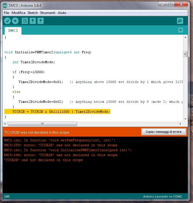

    Arduino Leonardo doesn't have Timer2, so change TCCR2B to TCCR3B in the code.
