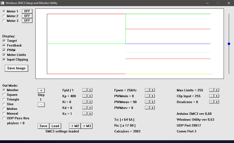

    Hi Juan Pablo ! That happened to me as well, and it was either up or down. What I did was to turn the pot manually until the green line was in the middle, then turn ON the motor. I think that the program itself shuts down the motor when the values are off chart if that make any sense :) Hope it helps !! Good luck !

    Thank you for your help! It works!!!

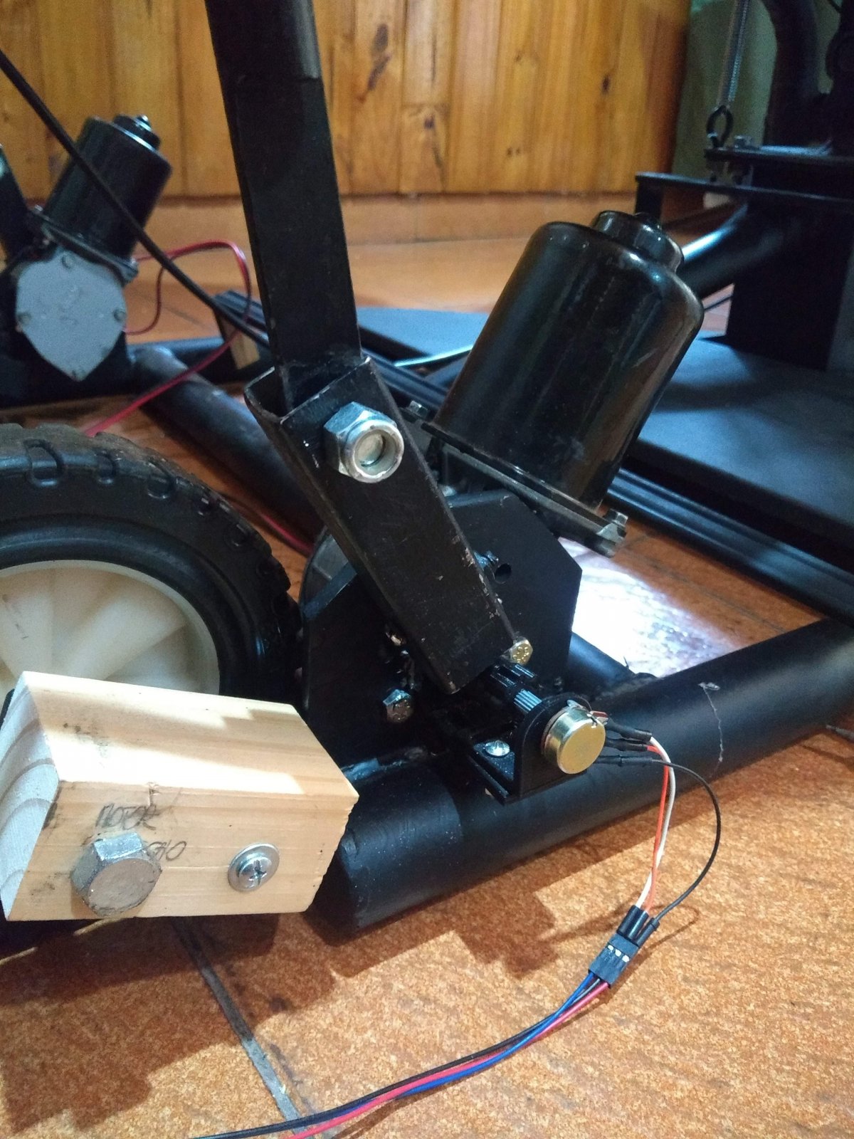

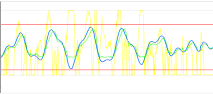

    Argentina
    33Coins

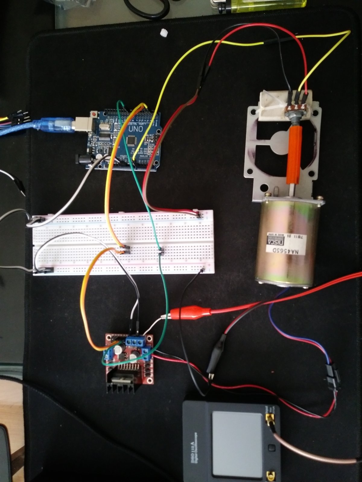

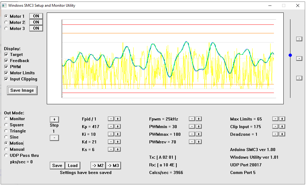

    Hi everyone, I got the motors work. I'm moving them with a jostick because CCD does not provide telemetry. I need to smooth some moves of one of the motors.
    I think the chart is not bad, I’ve placed a safety stop as you can see so the pot base won’t break. That’s why the feedback do not reach the minimum values.
    But that’s not the problem. When the motor goes up there are some vibrations instead of a flowing movement. probably a structural problem of the simulator.
    I don’t know what parameter can soften motion.
    I’d appreciate your help.

    Increasing Ki will give a motor some boost in reaching the target position and may decrease the vibrations. But worm gear motors have a lot of friction and sometimes the only thing you can do to minimize vibrations is to lessen the weight on them with a counter weight mechanism.

    When pushing the motors, as @BlazinH suggests, you may reach a point where you need to monitor how hot they get and might need to consider some form of cooling.

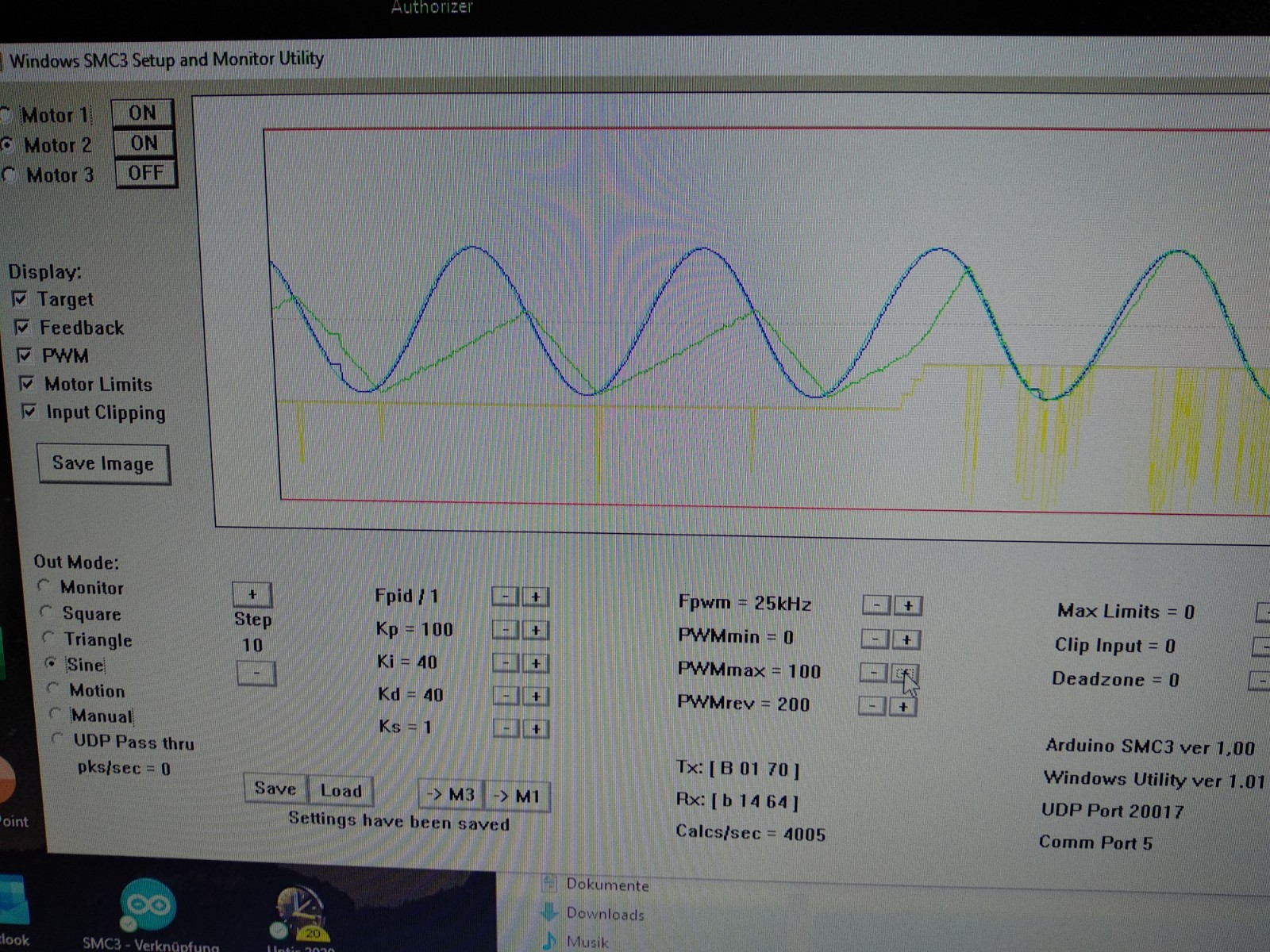

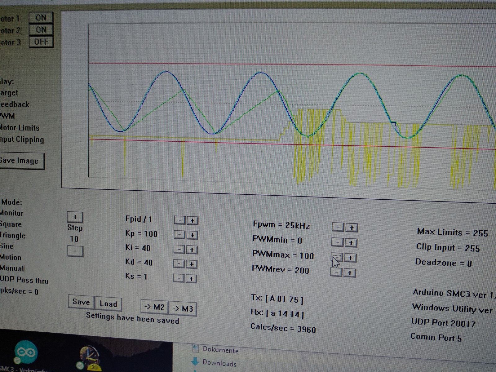

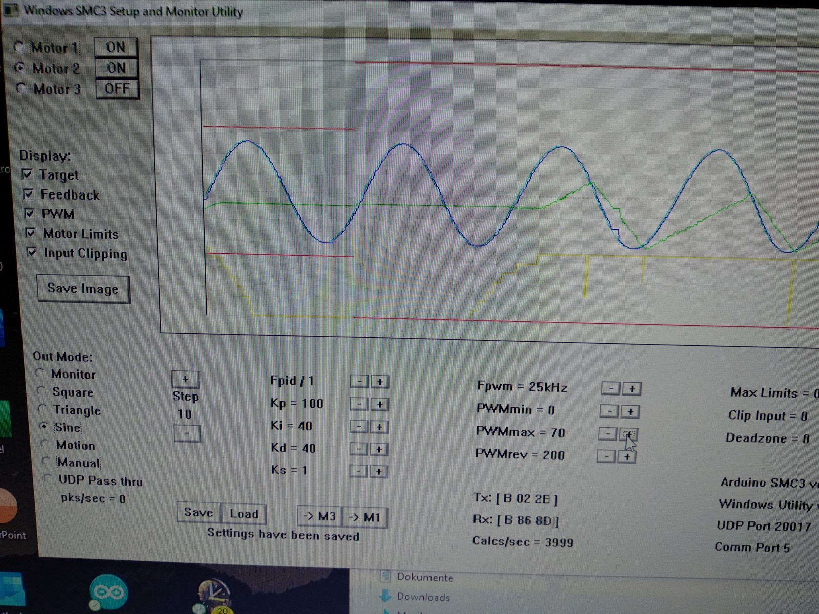

    Hi@all.
    After a long time i am Back again.
    New motirdrivers: ibt4.
    Code changed to Mode 2
    Motors Ground isolatet.
    Powersupply: ho dps800
    At 70 pwm Motors start Tübingen VERY slowly.
    At 100 pwm Motors shaking arround and Stutter.
    Yelow lines are shaking wildly
    Pics come tomorrow.
    Any ideas?
    Thanks martin
  15. BlazinH
    BlazinH Well-Known Member
    Oct 19, 2013
    2,145
    Oklahoma City, USA
    16,650Coins
    +1,839 / 32 / -1
    Ibt-4 is not supported. The supported Ibt-2 is driven thru the EN pins which are missing on the Ibt-4.
  16. Martin.Berger
    Martin.Berger Member
    May 6, 2014
    71
    204Coins

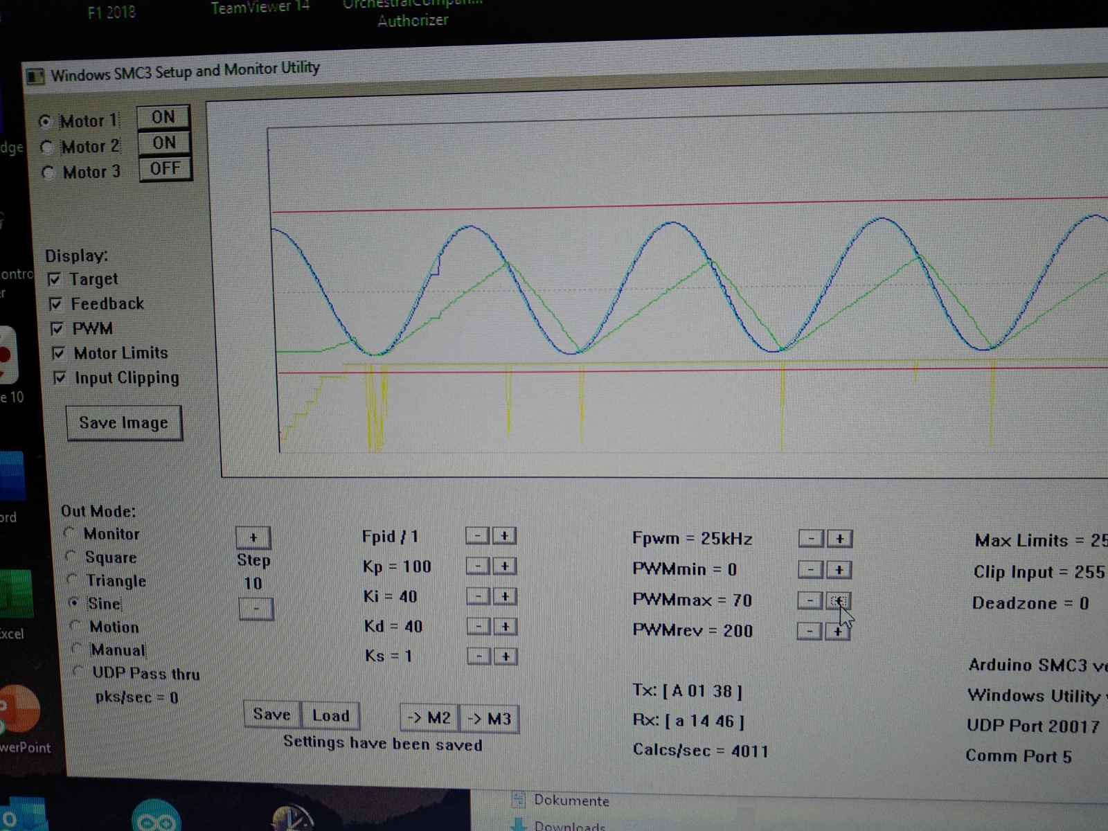

    Hi.
    That was a mistake. I use ibt2 such as in the picture posted in the beginning of this thread. I also use this wiring.
    Any ideas why my pwm(yellow Line?!) is doing strange things going Up to lets das 100 pwmMax
    Martin
  17. Martin.Berger
    May 6, 2014
    71
    204Coins
    Here are some pics:

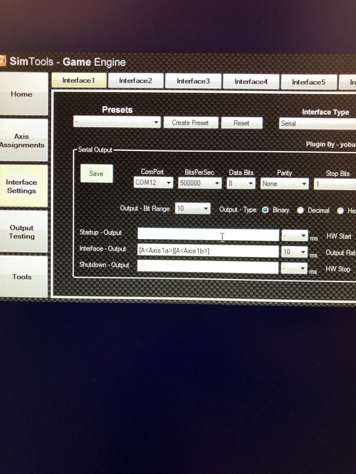

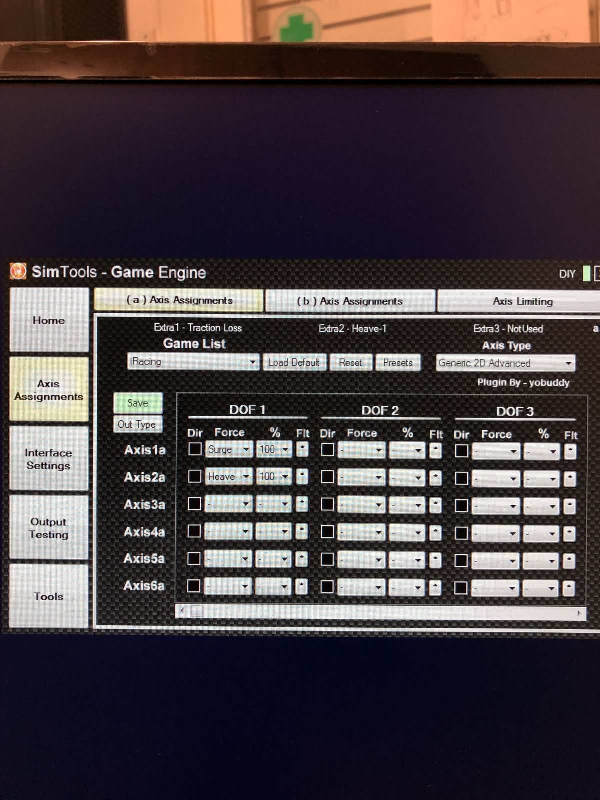

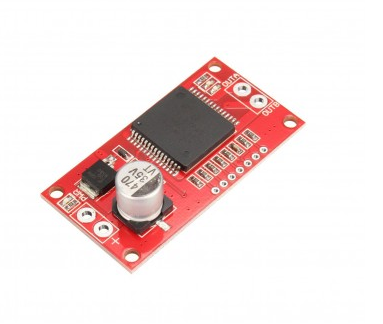

    Hi guys, hello again, i have trouble to made work the 2 dof motors.
    I start use the arduino uno and put the code, i use the smc3 for check and all works fine.
    I use the motormonsters and pods.
    But in the xsimtools i cant make in the output to send the second dof for the second motor.
    i select surge for the first motor in the Axisa1
    And heave for the second dof.
    i try to select in the same dof and selec surge for axisa1 and heave axisa2
    And try in separate dof
    and in the output write
    [A<axis1a>][A<axis2a>]
    but in the output test
    I cant control the second motor.( heave)
    any suggestion ?
    Thanks guys for your times.
    Xavi

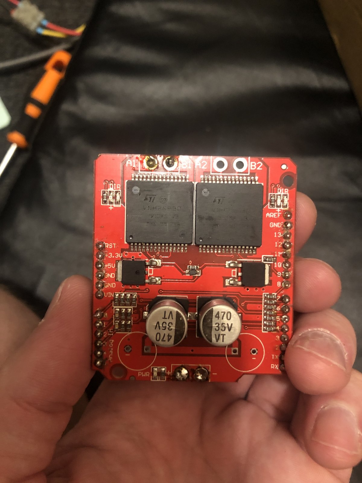

  19. noorbeast
    21,493
    150,578Coins
    +11,017 / 55 / -2

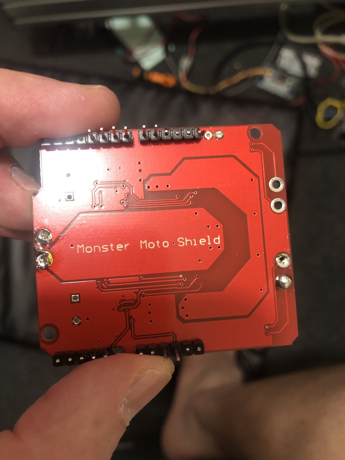

    If you are using clone MMs then you need to test them, as they are often faulty: https://www.xsimulator.net/community/faq/reputable-monster-moto-suppliers-testing-before-use.158/
