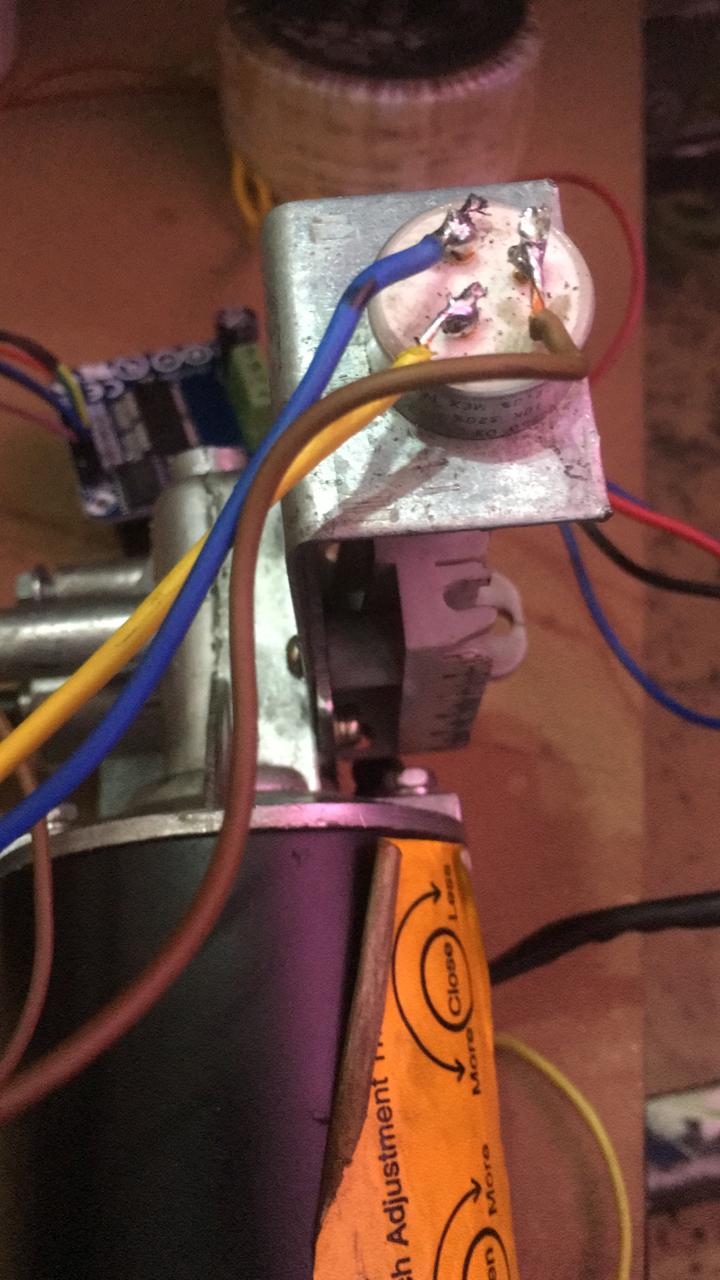

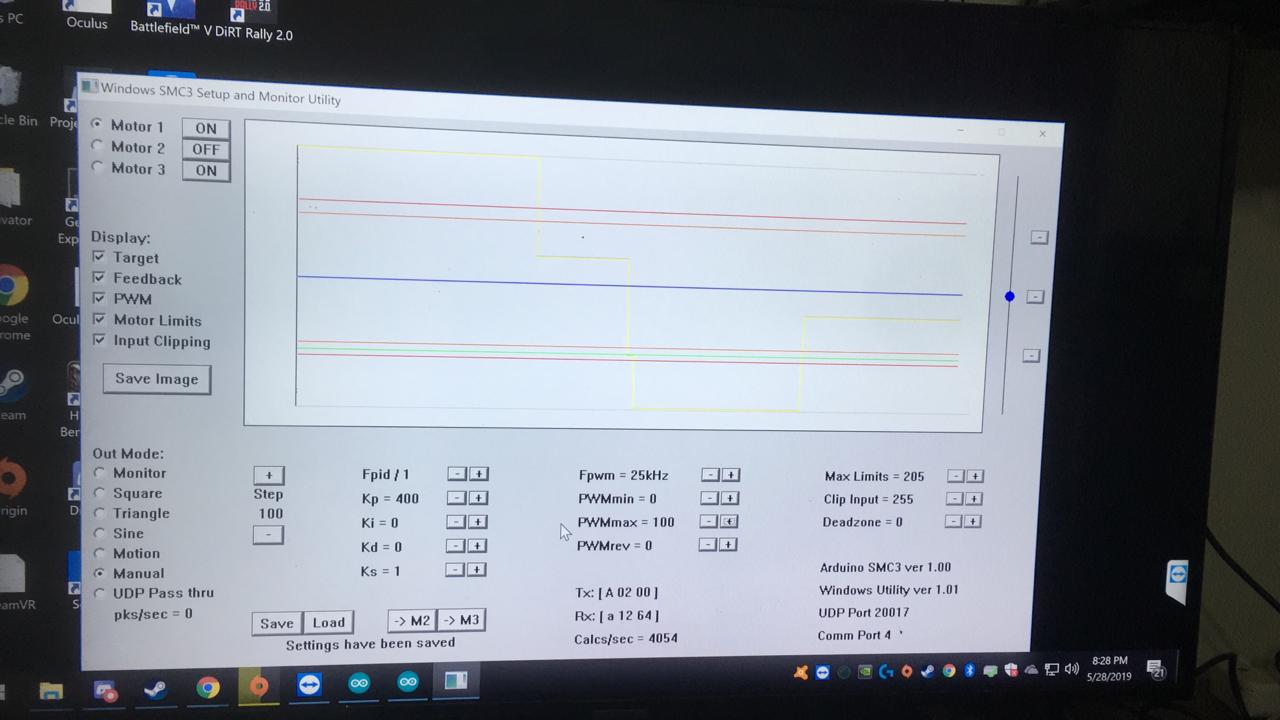

    I don't know what I'm doing wrong, I have Loaded SMC3 Version 1 on my arduino connected my to IBT2 BTS7960 43A bridge H, Change the cod in the Arduino to mode 2.
    Opened the SMC3 Windows utility the utility connects to the arduino board with no issues I followed the instructions on the first post to the letter but the motor does not move when I increase the PWMmax, I have also tested the potentiometers and moved them by hand and the green line on SMC3 moves but i cannot get the motors to turn.
    I also used the wiring diagram for mode 2 on the first post and double checked it multiple times.
    If i connect the motors directly to 24v they work perfectly.
    Thanks in advance for the assistance

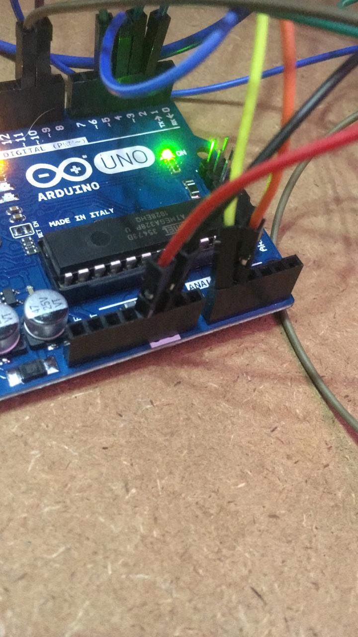

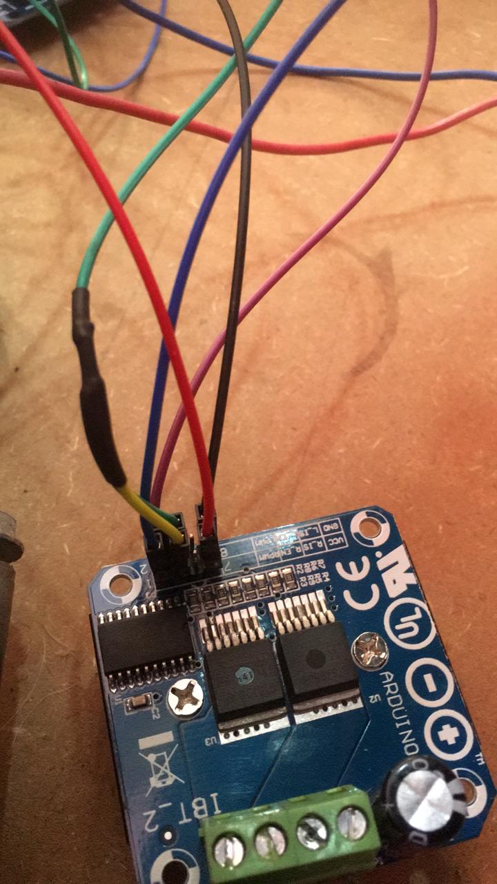

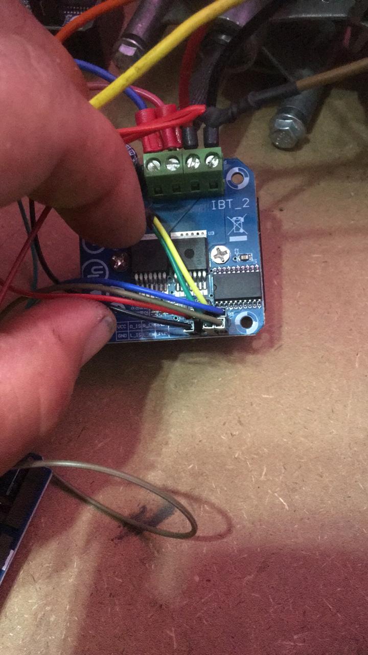

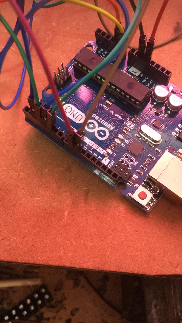

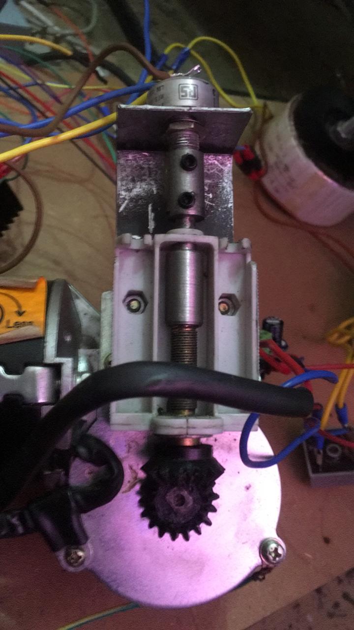

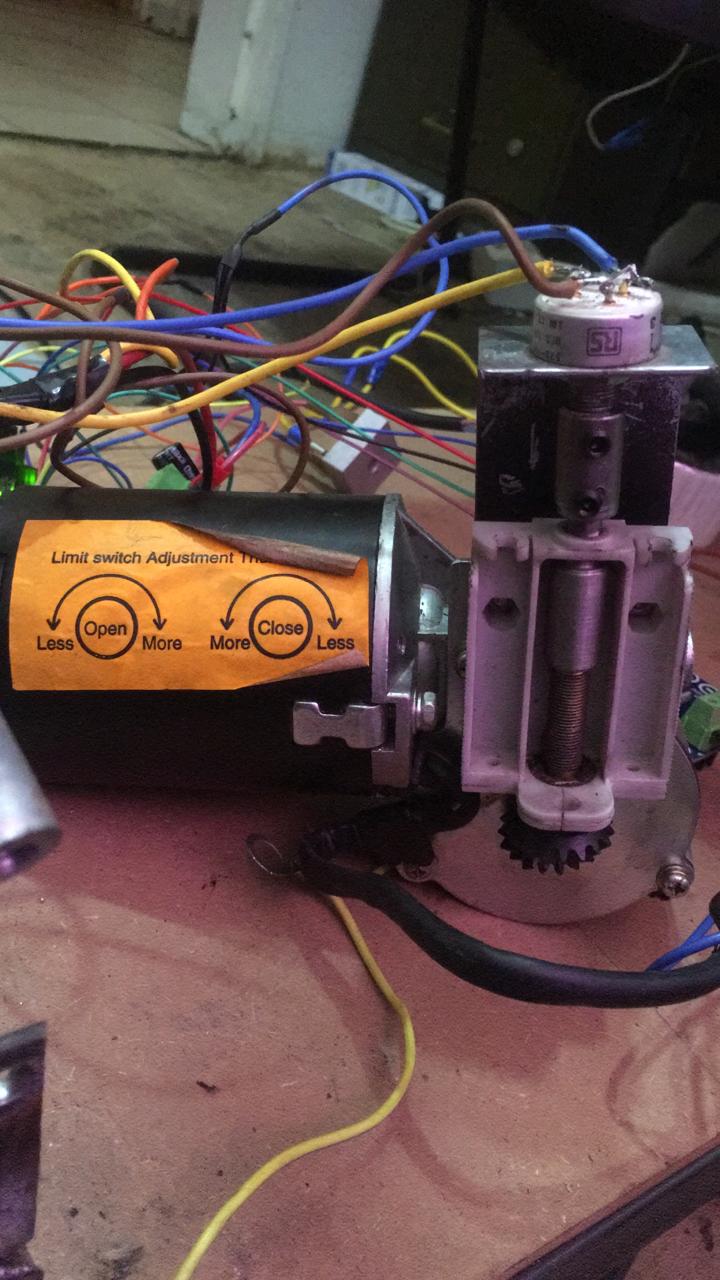

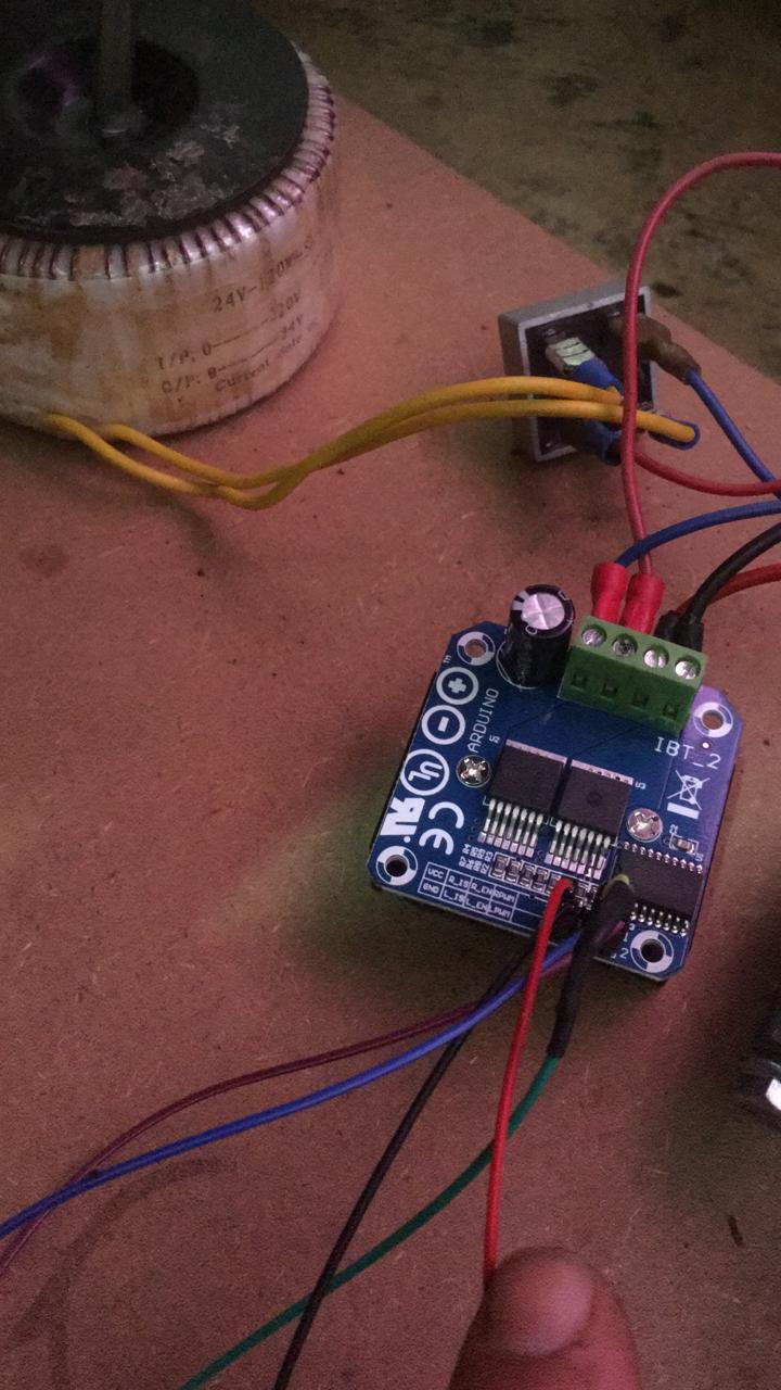

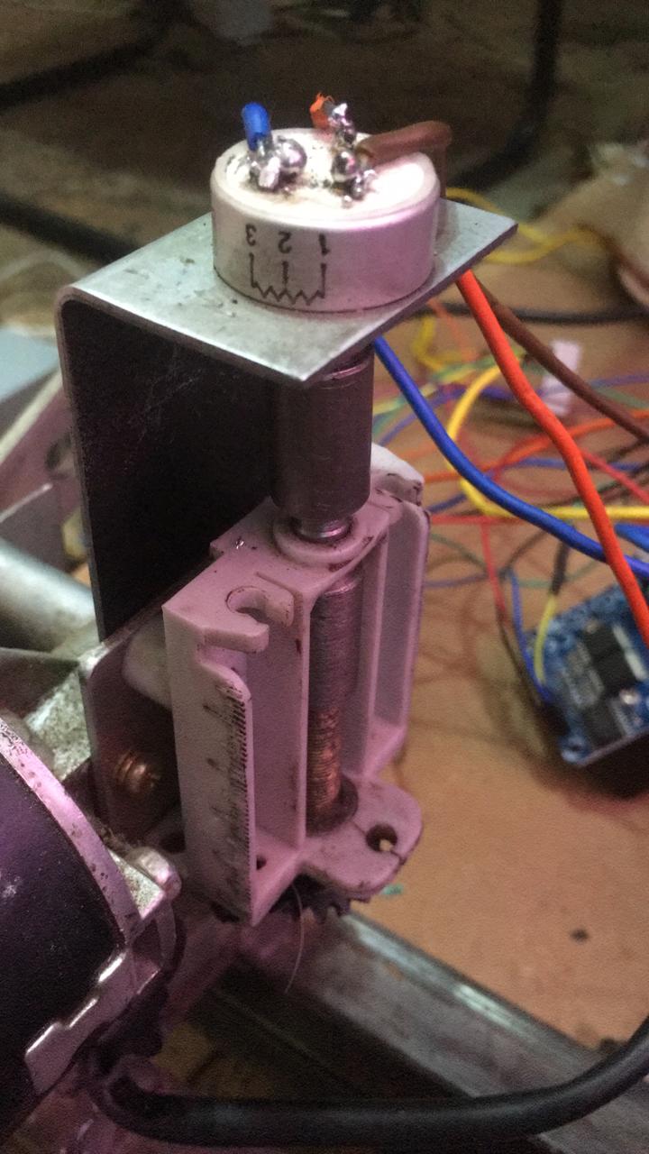

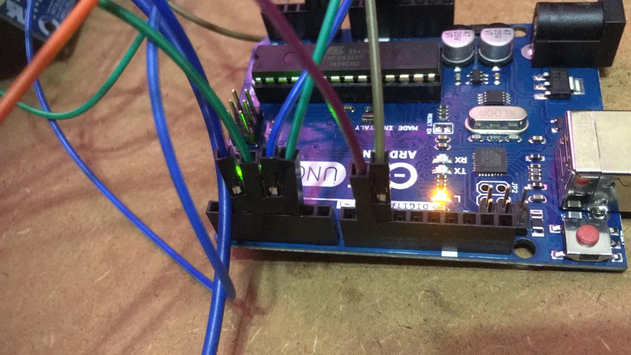

    Hi Arazok here are the images of my setup.
    when i connect the motor directly to the powersource the motor turns but when i run it trough the motor controller board and the arduino nothing happens

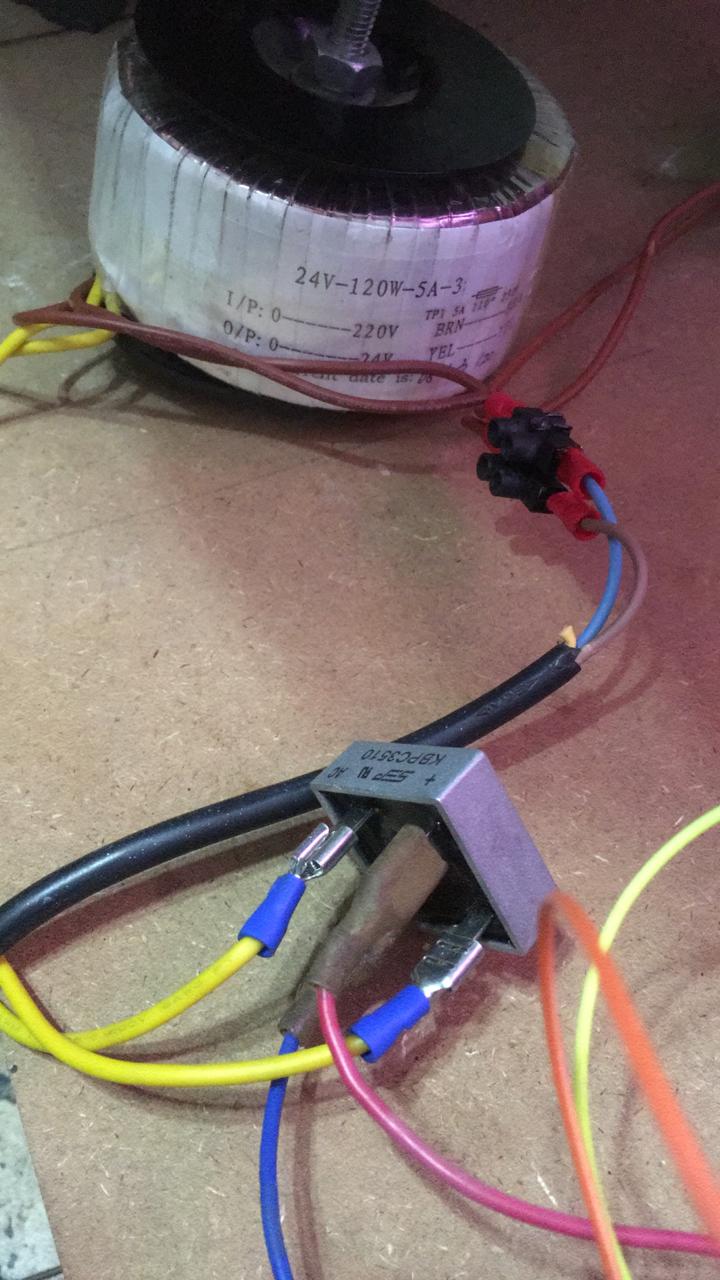

    Hey guys
    I found the issue last night, The power supply we were using was giving 24v when not connected to anything but the moment we connect them to the motor driver boards it reads 33v no idea why. So I'm assuming the boards are going into over voltage lockout as the IBT2 boards have over and under voltage protection.
    I connected a 12v power supply to test and everything started working as it should however my motors are not running as good as they can, I will buy a new 24v PSU 350W should do the trick that is around 14.6A.

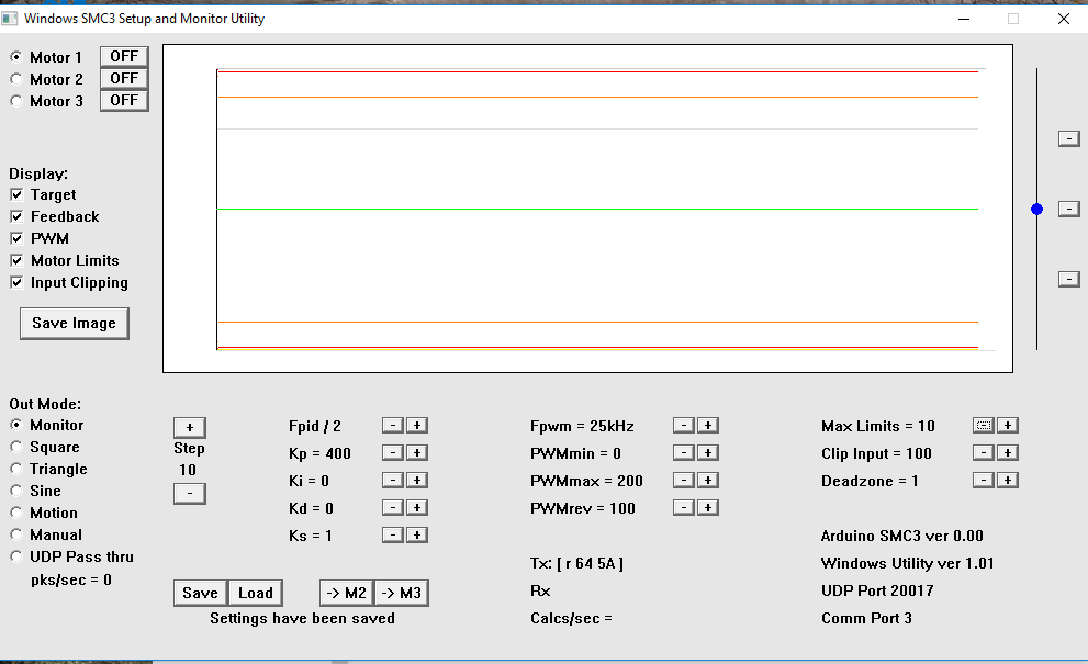

    congratulation about the effort but your setup doesnt seems very tidy so try to duble checks all wirring and connections and take a look of cold soldering...then IMO separate the potenciometers from motors and test if it was OK then put in the place.
    change the SMC utility as picture below first and then change it as desire.not bad if you also checks motors ground.
