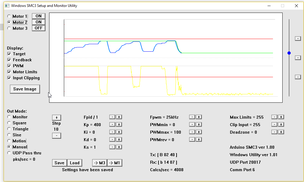

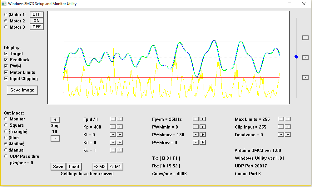

    Tried PWMMax up to 255 and still having the issue. There's definitely something fishy going on as it's only happening after the motor is left idle for a while, more than say 20 seconds. I did some more testing with PWMmax set to 180 below (I did the same with 255 but the screenshots are from my 180 test).
    This is the "motion" setting with me sitting in the chair. It had plenty of power and ran flawlessly for over 5 minutes:
    After this, I performed some testing in manual mode where I made it take large steps at a time. I didn't let it stay idle before trying this and it worked just fine:
    I then let it sit for about 20 seconds and tried some more steps and it very quickly became unresponsive:
    So the trigger to this seems to be letting it sit idle and then trying to make it step a large distance.

    It's definitely possible there's something wrong with it. After more testing it is just this one driver (before I thought it was both). It seems to be tripping one of it's internal protections as far as I can tell. The "reset" for the protection seems to be a double swap of the direction (to the opposite polarity and back). Dropping the PWM to zero and back does not reset it.
    It's only on large step inputs and only after sitting idle for an extended period of time. It can run the square wave test forever once it starts. From a practical standpoint I'm not sure I'll ever see this condition during normal use and even if I do it will fix itself quickly after a direction swap. I think I'm just going to keep using it for now and cross the "replacement" bridge if/when I get to it. I would likely replace it with a sabertooth since it would be months to get another monster moto shipped. However, any money saved here is more money I can put into my other hobbies...
    On another note, would there be any reason NOT to put PWMmax to 255? It doesn't seem to be causing any issues now and makes the motion in the seat pretty snappy. I have pretty heavy cooling on the drivers (heatsink + 120 mm fan) if heat is a concern.

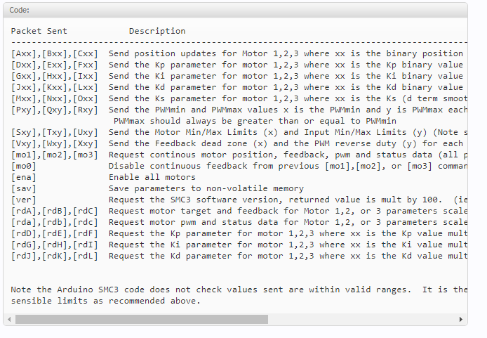

  20. BlazinH
    BlazinH Well-Known Member
    Oct 19, 2013
    2,145
    Oklahoma City, USA
    16,678Coins
    +1,839 / 32 / -1
    You're worrying about things that aren't important. Just follow the setup instructions for now. All you need to concern yourself about the sketch is changing the default mode if it needs changing.
    Btw, when you make settings changes with smc3 utilities they are also saved on the arduinos eeprom at the same time so the sketch can use them.
