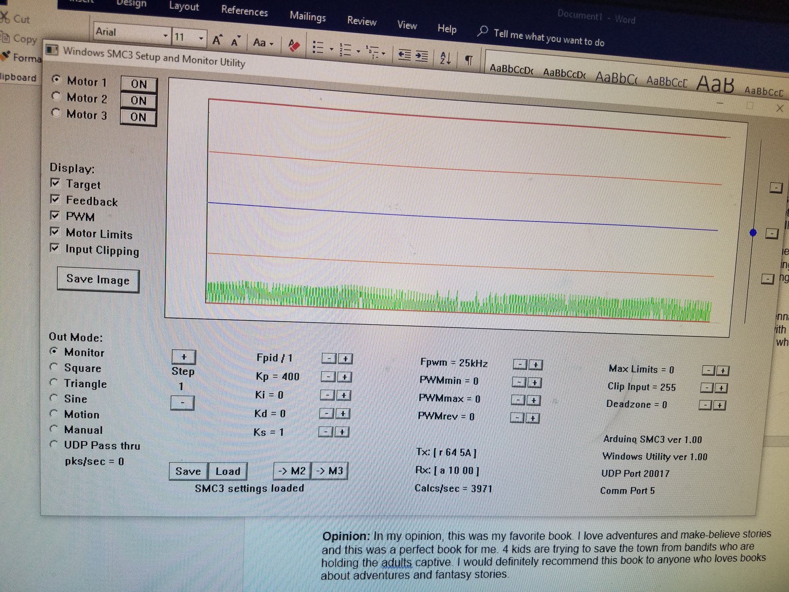

    it starts up good. after a couple minutes i gets this. after a few minutes the motor runs off and stops and get whats in the 2nd picture. when i restart it starts good but then ..... rinse and repeat... any ideas? Not sure whats going on here any ideas.jpg
  6. elnino
    elnino Active Member
    Apr 1, 2010
    245
    Computer Geek
    Adelaide, Australia
    1,551Coins
    +138 / 1 / -0
    That almost looks like a faulty pot.

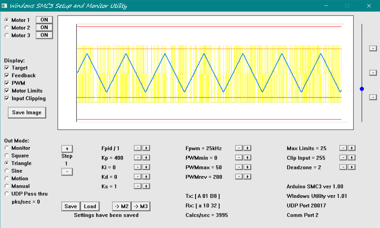

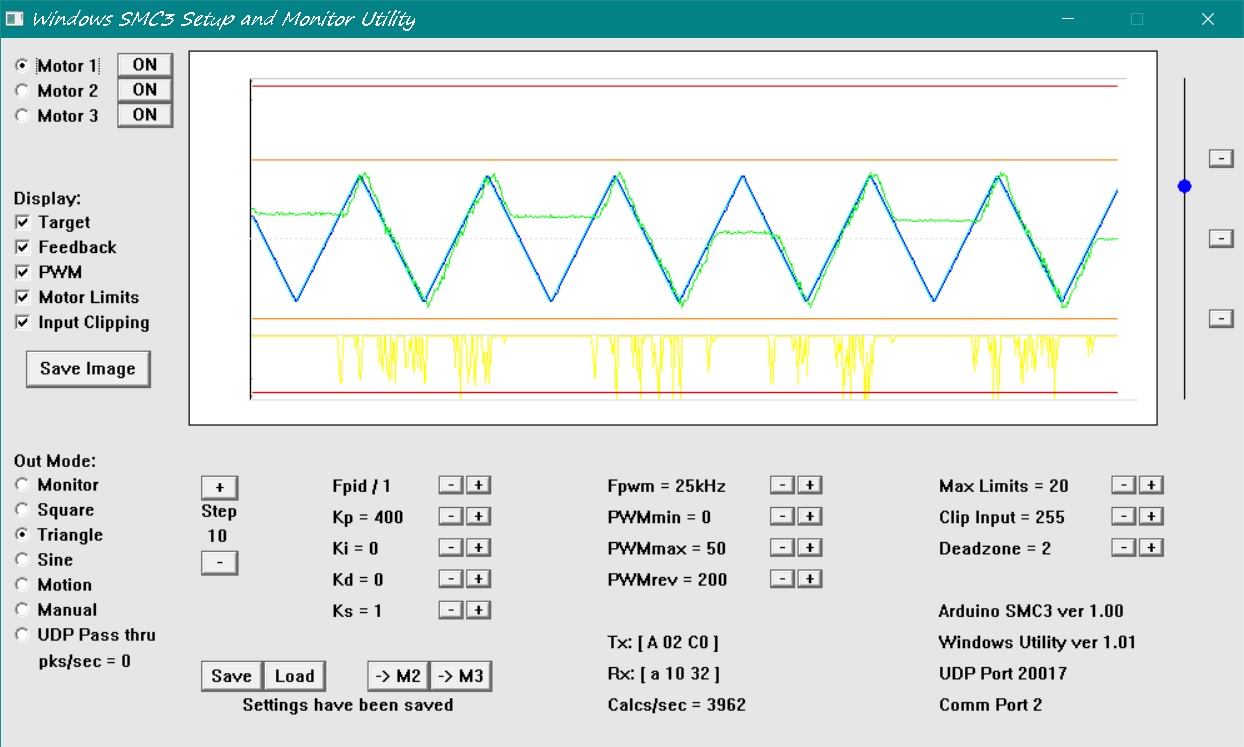

    Two questions regarding persistent Simtools values and the Arduiono that I could not find the answers to:
    1 - When min/max for clip, pwm, smoothing are set, the settings are saved automatically to the Arduino and apply when using the Simtools/games, correct?
    2 - I need a smaller clip range, so I set the value (Motor1_Clip=400) in the setting file and load it. The value is depicted on the graph, but the clipping trace always seems to remain at the 255 max value. Why?
    3 - Is my clip=400 being saved to the Arduino OR does SMC3Utility block that clip value from being saved? Would this explain why when I close and re-open SMC3Utility the Clip 400 is replaced by the max clip of 255 or the last "good" clip value? I want to keep my 400 clip.
    R
  8. BlazinH
    BlazinH Well-Known Member
    Oct 19, 2013
    2,145
    Oklahoma City, USA
    16,665Coins
    +1,839 / 32 / -1
    1. Yes
    2. & 3. You answered your own questions that max clip value is 255 so you can't set it higher than 255.

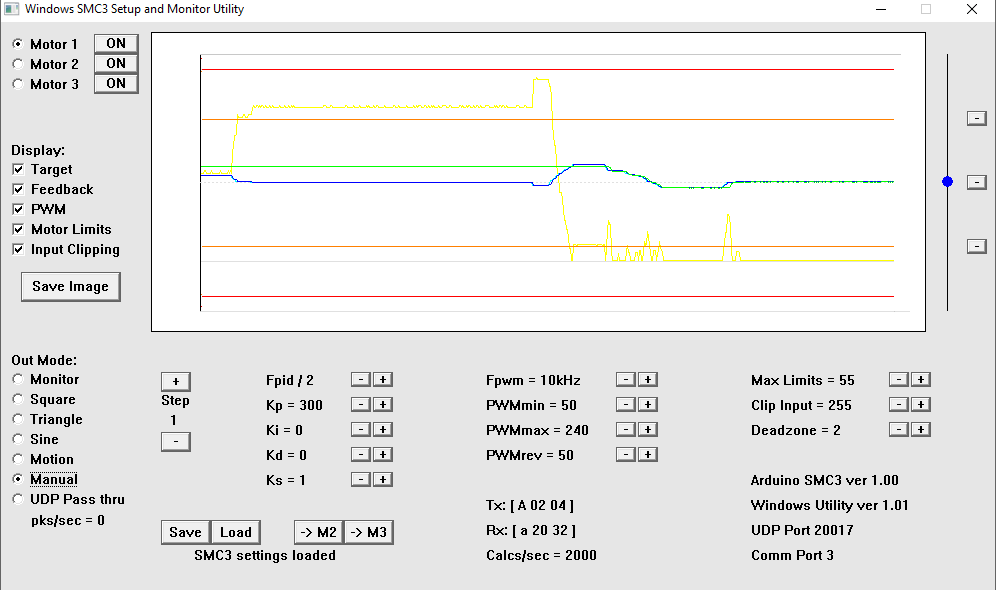

    TooSlow.png Sorry. I was trying to see if the limit was controlled by the code in the Arduino OR the .exe. It appears that it is in the .exe. It would be great if a future release allowed the larger clip to be saved...Thanks for the response.
    Do you feel that the stoppage shown above is due to hardware or a software setting shown? No matter my settings, the movement will only resume if I move the manual line back to the green line then the motion tracks with the target until it moves too fast. Shouldn't the movement keep attempting to reach the target no matter how far away from the target the indicator shows? Of course the gold power bar shows power SHOULD be applied, but nothing happens until I move the manual target back to the green position. Does this just mean I am moving the target too fast?

    Any ideas why the tracking would be lost mid-movement? It seems that the tracking only gets picked up again if the position indicator lines up exactly where it did previously, but jumps off track again. I am picking up a replacement Arduino just in case. Maybe the clones done handle the comm speed well?

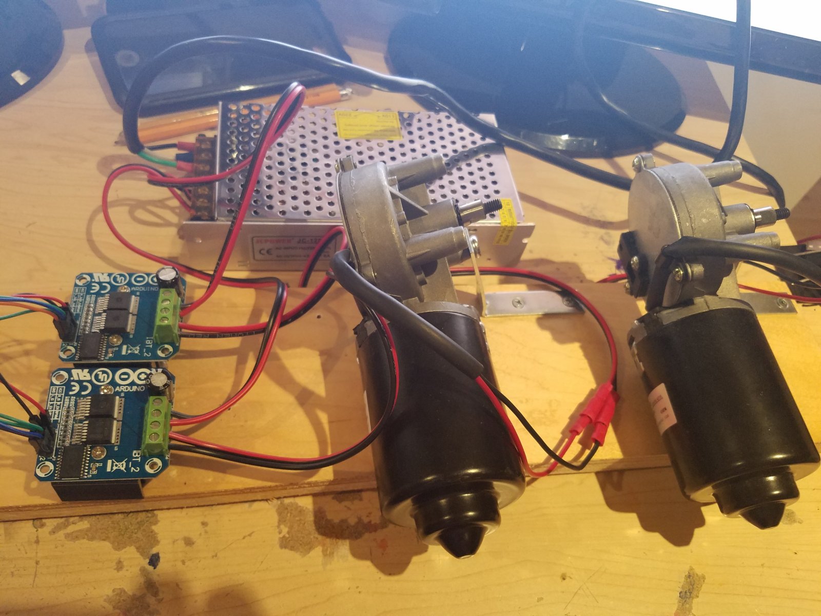

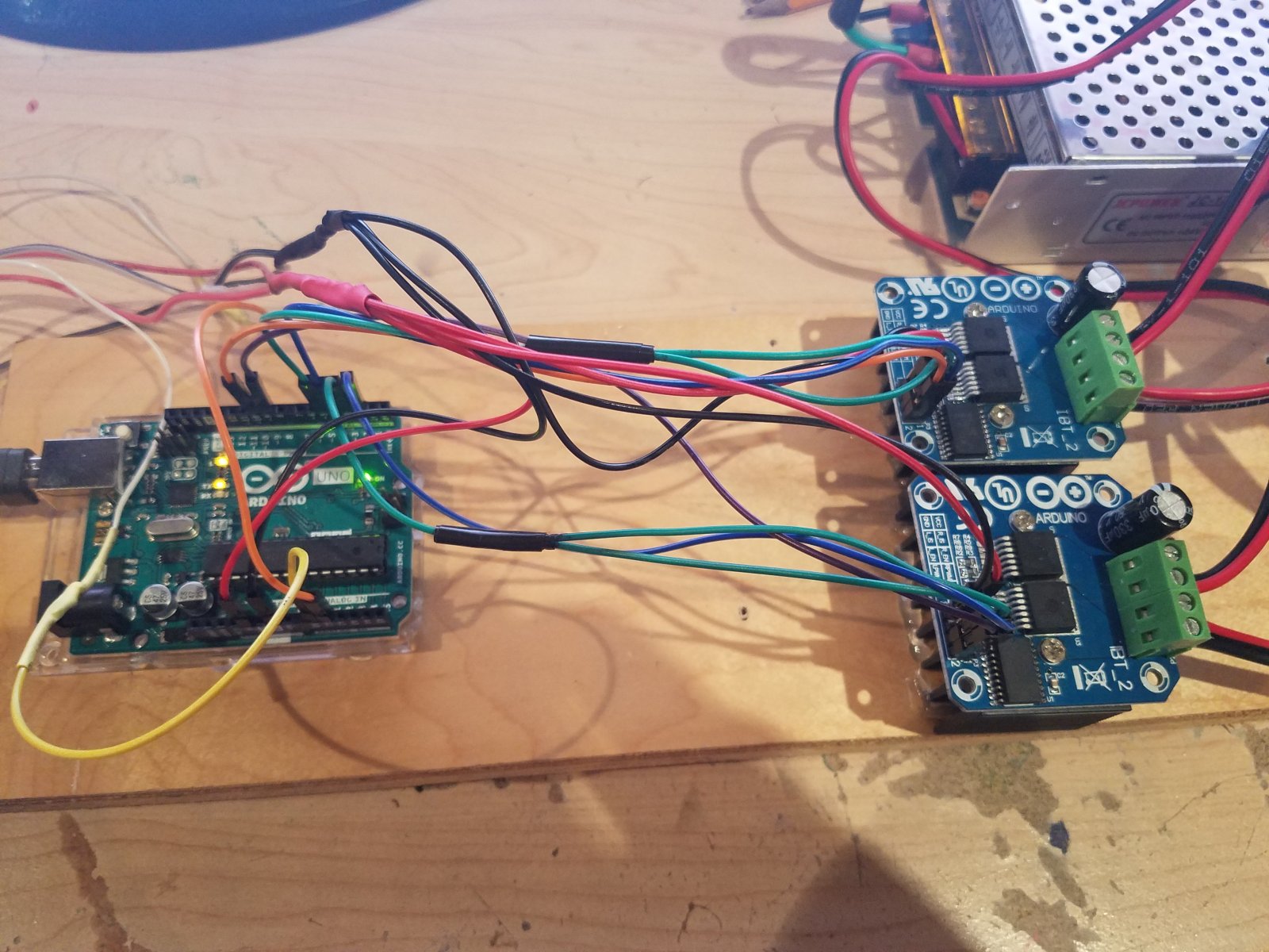

    DC motor
    Hello Guys...
    My Motor monster + audrino combo I have built is giving me weird issue.
    The motor mounted on it will only spin non-stop unless PWMmax is set above 200.
    I have double checked all wiring and connection , it seems like it is correct and conducting signals..
    Please help....
    Heres a short video of it :

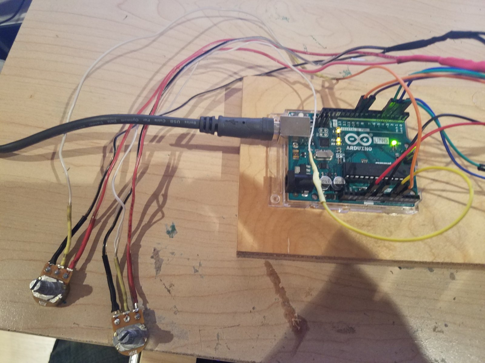

    Hi, i am building my rig using MODE2.
    I am totally new at this and am learning as i go.
    I can make both motors run using SCM3 and everything seems to be OK but the feedback is on the bottom of the screen. I have replaced and re soldered the pots twice, tested continuity on all wires (All OK) but nothing changes.
    I am using a B10K pot with a solid core wire. Is this the correct one?
    I am using #define MODE2 and #define ENABLE_POT_SCALING (i dont know if i need this since i dont understand what "enable analogue input AN5" means).
    Any help is deeply appreciated.
  13. Marcos Loeps
    Marcos Loeps New Member
    Sep 26, 2018
    7
    178Coins
    Adding the pic for SMC3.

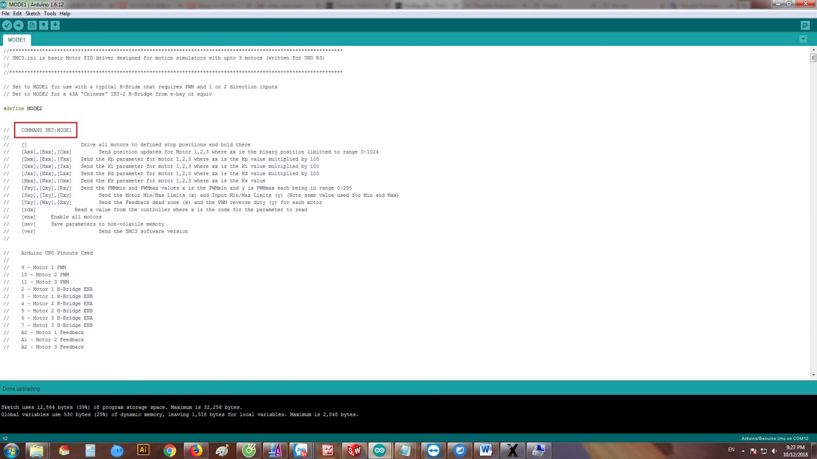

    3. my problem with smc3 code .Tôi use MODE1 you can help me 1 code complete?
    4. please download code here
    5. thank you RufusDufus
  20. phonghornet
    phonghornet New Member
    Aug 19, 2018
    27
    190Coins
    2DOF, 3DOF, DC motor, Arduino, 4DOF, 6DOF
    I want to use mode1.
    edit as the correct or wrong file image?
