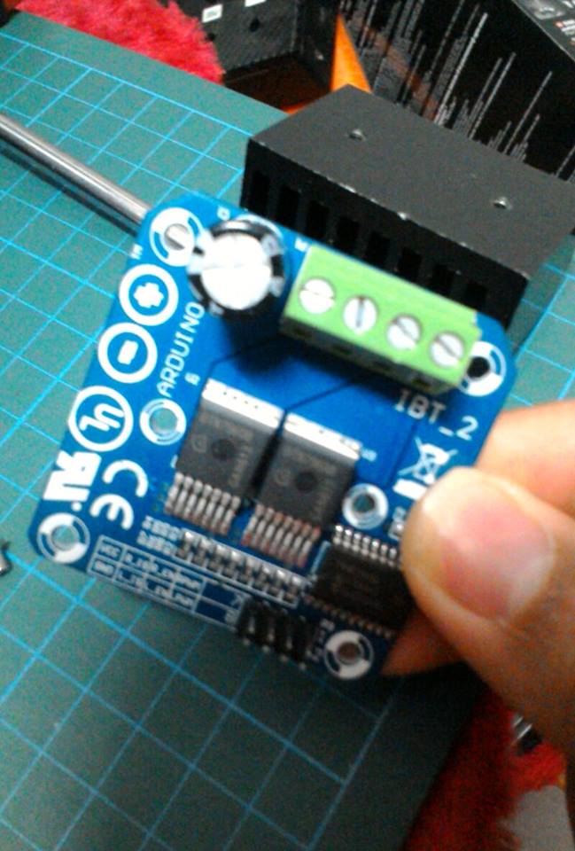

    By the way we smoked some BTS boards while testing just by changing the motor direction a bit nervously. Does someone had the same experience with these cheap boards?

    Hi Guys,
    My moving stuff with mode1 moto monster shield was working for only 4-5 hours.
    Then the moto shield went wrong. First motor 1 output, then 2 also.
    I was using cooler board and vents also on the chips. Maybe tat controller was bad...
    So what you suggest to me, the same mode1 MM shield or mode2 Hbridge solution?
    For mode2 can I use the same PSU?
    Cheers,
    George

    Yes I use these boards, the most important thing is to remove the heatsink and add some heatsink grease between heatsink and PCB, also add small heatsink direct to chip and keep cool.

    If it worked and then failed during use the most probable cause of failure is too much current causing internal heating and failure. The mode has nothing to do with the problem as long as you are using the correct mode for the controller you use. You can try reducing PWMmax but depending on your rig that may reduce motion performance. Ideally you want the least power required to to drive the motors with enough torque to track the input signal. Any more than that and you are overdriving the motors/drivers for no reason.

    how you paste your thermal compound ?
