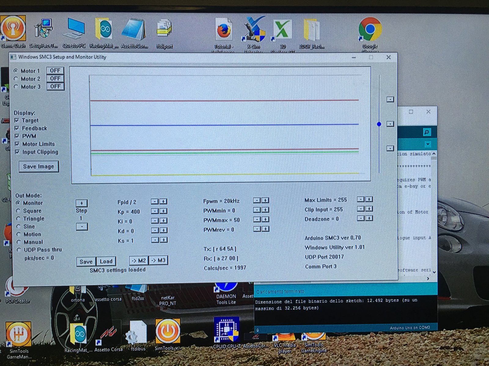

  7. luky_90
    luky_90 Member
    Mar 3, 2016
    106
    276Coins
    +16 / 0 / -0
    I installed SMC3 utility , followed step by step instructions , but the motors are at a standstill , I tried to move the hand potentiometer and the green line moves, but the engine remains stationary .I also did another house right where there wrote Motor1 , motor2 , Motor3 if I press the power button does not switch to ON

  13. RufusDufus
    RufusDufus Well-Known Member
    Jul 21, 2013
    681
    Adelaide Australia
    16,516Coins
    +1,018 / 10 / -1
    The video shows that the motor is already in the target position (blue line and green line on top of each other, therefore the motor does not need to and won't be moved.
    It is best to do this test using square wave or sine wave output.
  14. luky_90

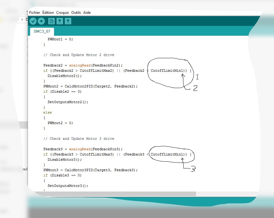

  20. ericRacer
    Jun 11, 2009
    251
    Pilot
    Canada, Quebec
    922Coins
    +147 / 2 / -0
    @RufusDufus Hi !
    I think i found a little error in the software . ( i am not sure, but i found it on my original version). Maybe it is already fixed. here is in the attached file. SMC3_07  Arduino 1.6.5.jpg
