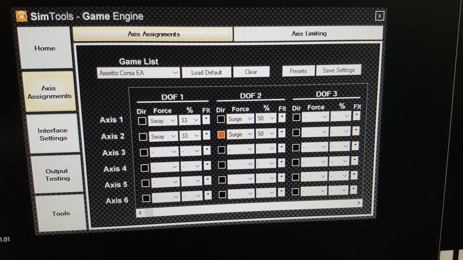

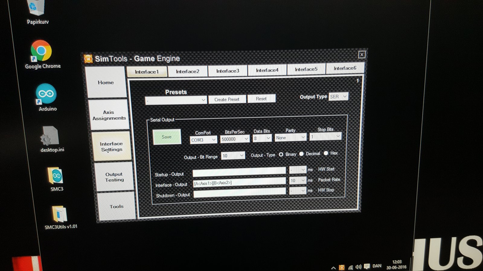

    Can anyone help me how to connect smc3 to unity. Now I'm using serial port but I'm loosing some data also my unity crashes quit often. Please help me out.

    I need a tutorial on how to communicate arduino with unity. Now I'm connecting through serial port but often my unity is crashing.

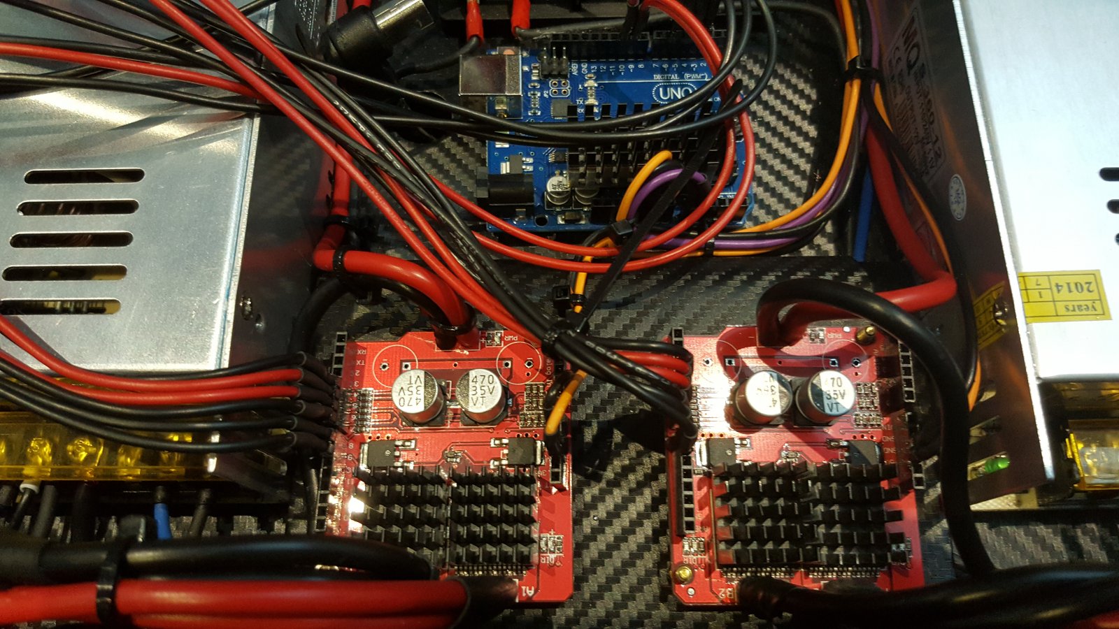

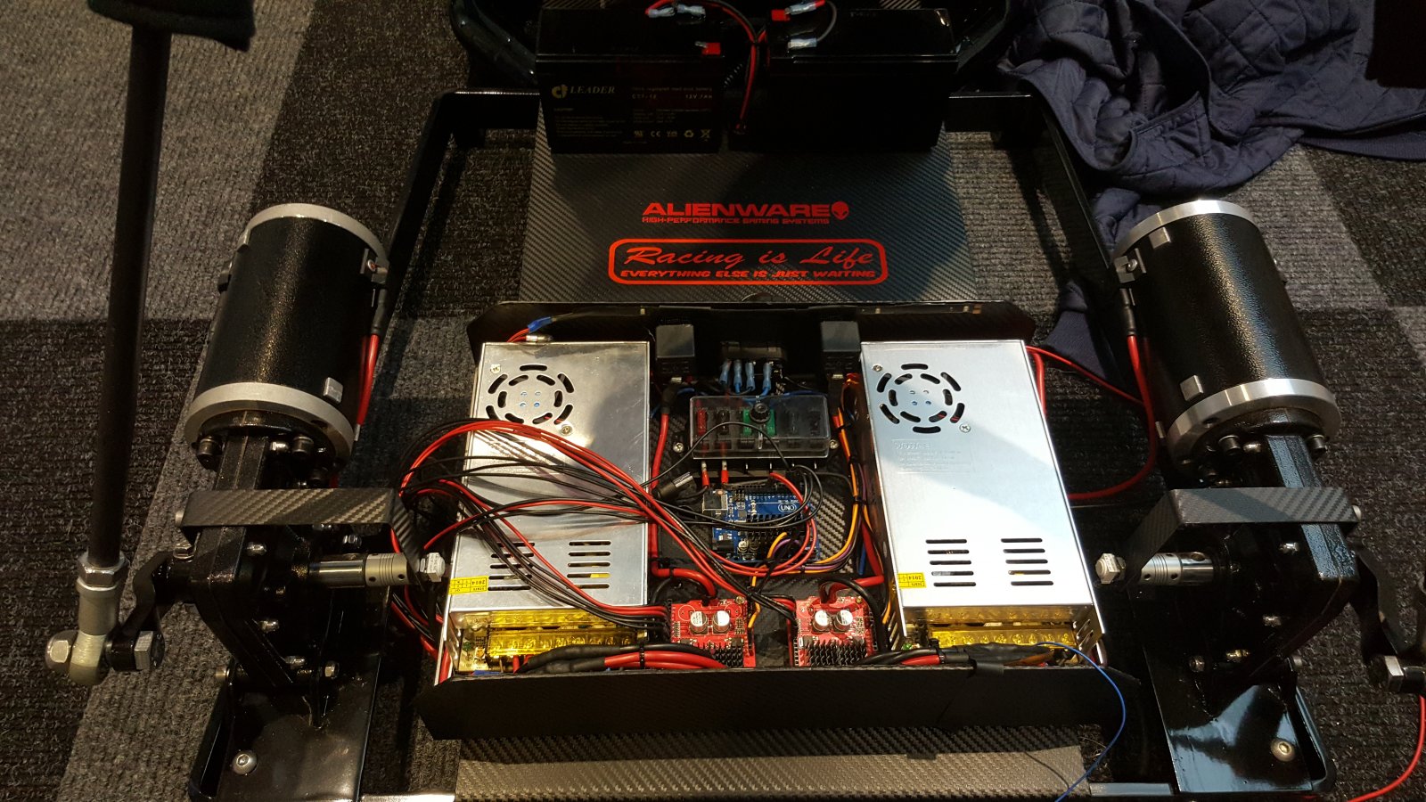

    3DOF, Arduino, SimforceGT, Motion platform
    who have other coding and good coding because i don t what is my problem from actuator or coding because it become delay on my real driving simulator.. i don t know what is problem..can anyone help me?
    i m paste my coding here.

    I need your help guys.. REALLY :sos
    A year ago I builded a 2dof with the racingmat program on a Arduino R3 and some cheap H bridges with wiper motors.
    It has worked just great.
    BUT there were a lot of sound inteference from the motors.
    So I have now converted it to the SMC3 code with some motors from motion dynamics. Some 90ZYT 155 12v 50:1 ratio.
    I have 2x 30A 12v PSU with some 12v batteries to the current spikes to motors can give.
    2x moto monster shield for controlling the motors.
    Everything works. Meaning that the motors rotate the right way and the directions is correct.
    The problem is that after a single lap it freezes.
    Believe that it is the moto monsters that are shutting down because of heat.
    Running with 200 in kp and all the pwm max and reverse is no more than 100 (See attached picture for all settings ) :)
    Have now tried with my old wiper motors.
    Thought it would work just great as it did before with racingmat code.
    BUT NO!
    Still shuts down and gets hot.
    Now there are bigger h-bridges and 12v battery backup to the psu's.
    Have tried with a low fpwm. That seems to be a little bit better. But them Im having some noise from the motors which I would like to get rid off..
    So asume there is something I have misunderstood in the smc3 utility?
    Have checked all wirings to arduino from moto monsters. Everything is fine.
    My only guess woukd be if the heatsinks were to small?
    But they cover the chips and did the job well on the other h-bridge.
    And with the low parameters Im going with there shouldn't be much heat I guess.
    Asume the wiper motors uses the same current no matter what software/code you are using!
    It would really make my day if someone could help me as I'm pretty much stuck here :):sos
    Best regards Simon

    fpid should be at 1
    fpwm set to 20
    the pid settings are not the same with different motors. your settings do seem a bit conservative tho. i use 400-500kp, 0 ki and 8 kd. I also use about 215 pwm max. I would recommend fans for the monsters they shut down when hot. i use laser thermometer (non contact) to measure the temp of components. you may want to be sure your psu's arent shutting down either. I recommend wiring them in parallel to spread the load. gl hope this helps

    in addition to the comment of @bruce stephen the active cooling of the MMs is a mandatory. The cooler itself is too small.
    Furthermore the Ard doesn't need any cooler ;)
    Try high kp settings like 400-500 and lower PWMmax settings first, f. eg 120.
    If you still have issues check the wiring and the voltage output of each single channel.

    Thank you guys. Got a chance to try out your suggestions last night.
    Works great with the old wiper motors now. And when i try with the worm gears it works perfect for a while but it still gets a bit too hot I think even tgough it rund with little pwmmax.
    Will do a upgrade on the cooling side and make a test with your tutorial @Pit with 2 Moto Monsters per motor.
    And find 2x 47a psu.
    Then I should have enough power from the PSU's and enough MM power.
    Will also do a heatsink + fan upgrade.
    It seems the main reason to get it working was changing the fpid from 2 to 1.
