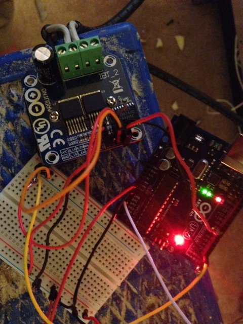

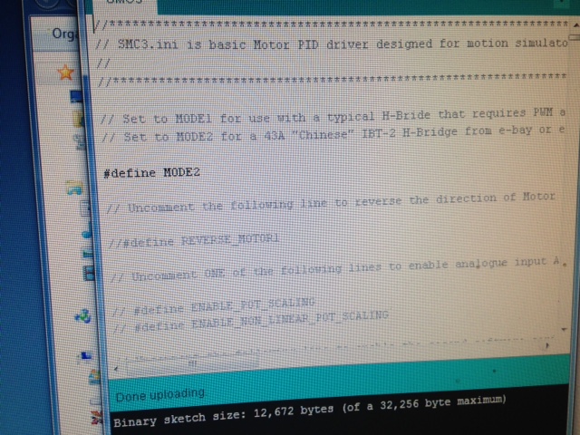

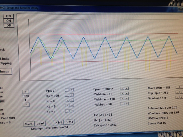

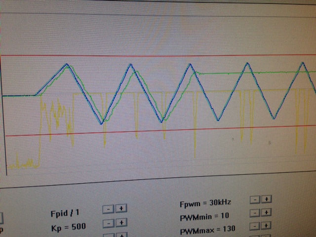

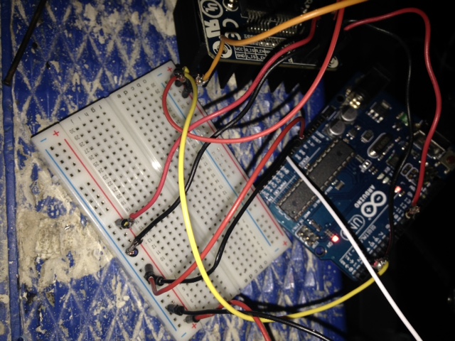

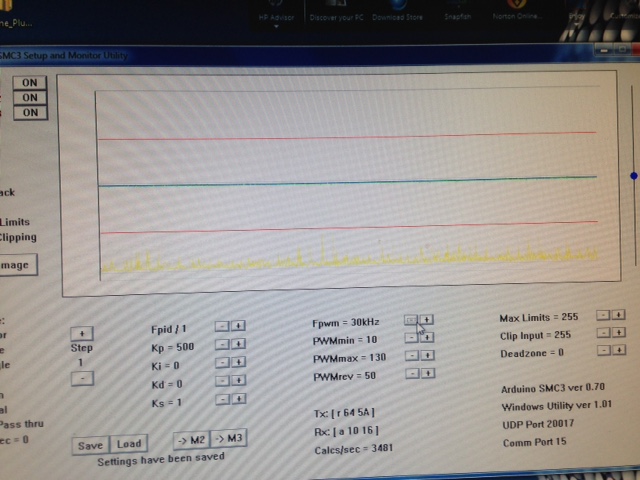

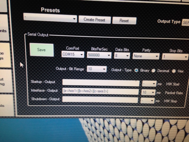

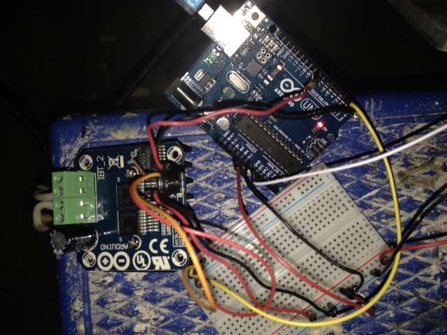

    Here are some pics...I'm only running one Hbridge right now, do you think this might be the problem? I still can't test my axis's in simtools, and as this is my first time using smc3 configurator i'm not exactly sure how it's suppose to make my motor behave. It shifts back and fourth in increments of 15 degrees. I can control the speed via increases pwm max, but not direction or rate of travel. Any help would be good

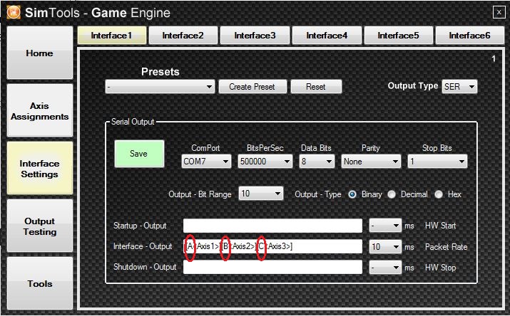

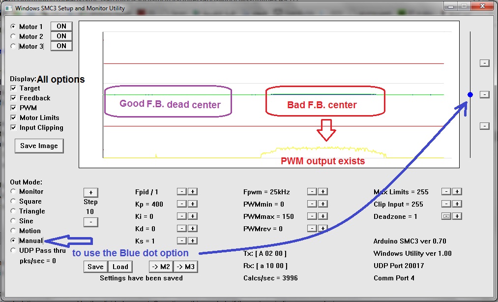

    @kimballfount ...
    So 15 degree limitation response comes from a feedback pot ... What kind of pot do you use ? Do you use gears with it ?...
    And, Try using Motion output in the utility ...
    you also have Sine , Triangle, Square, Motion, and Manual testing output modes ...
    In SimTools use CAPITAL LETTERS here ...
    • Useful Useful x 2

    Capital Letters! CAPITAL LETTERS!!!!! Yeah that solved it man, been messing with this thing for two days. Thanks man

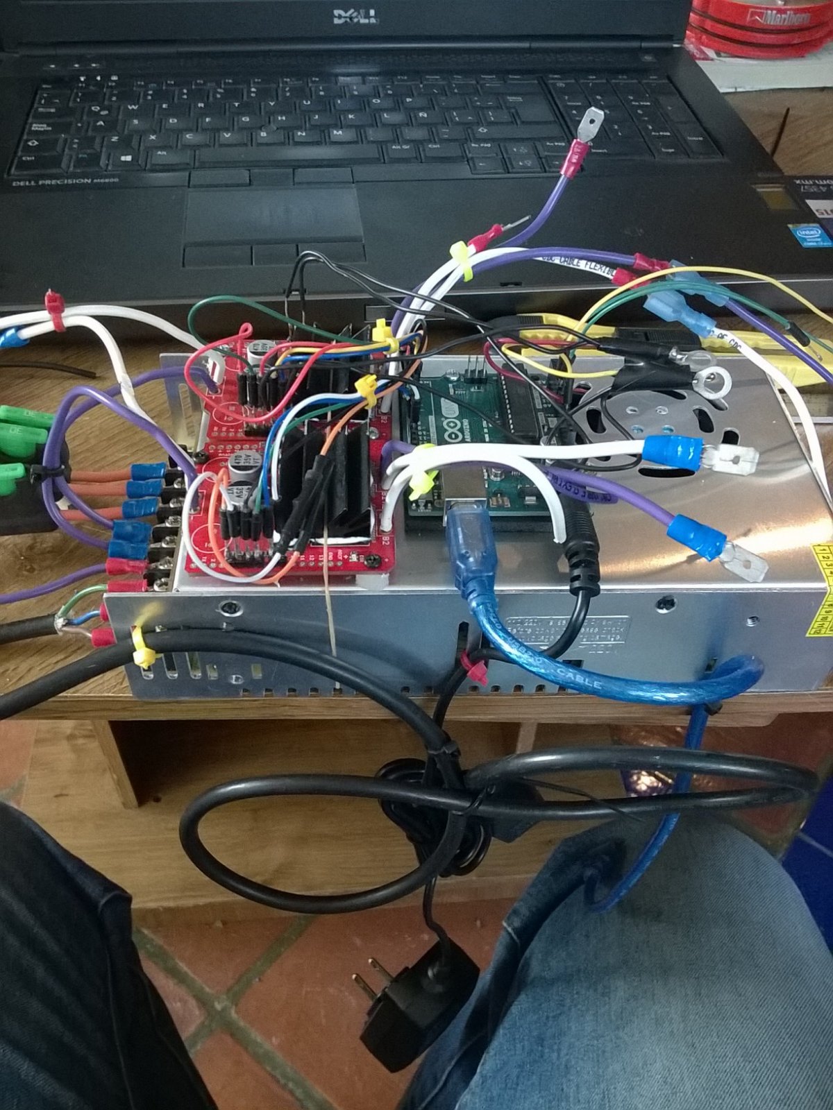

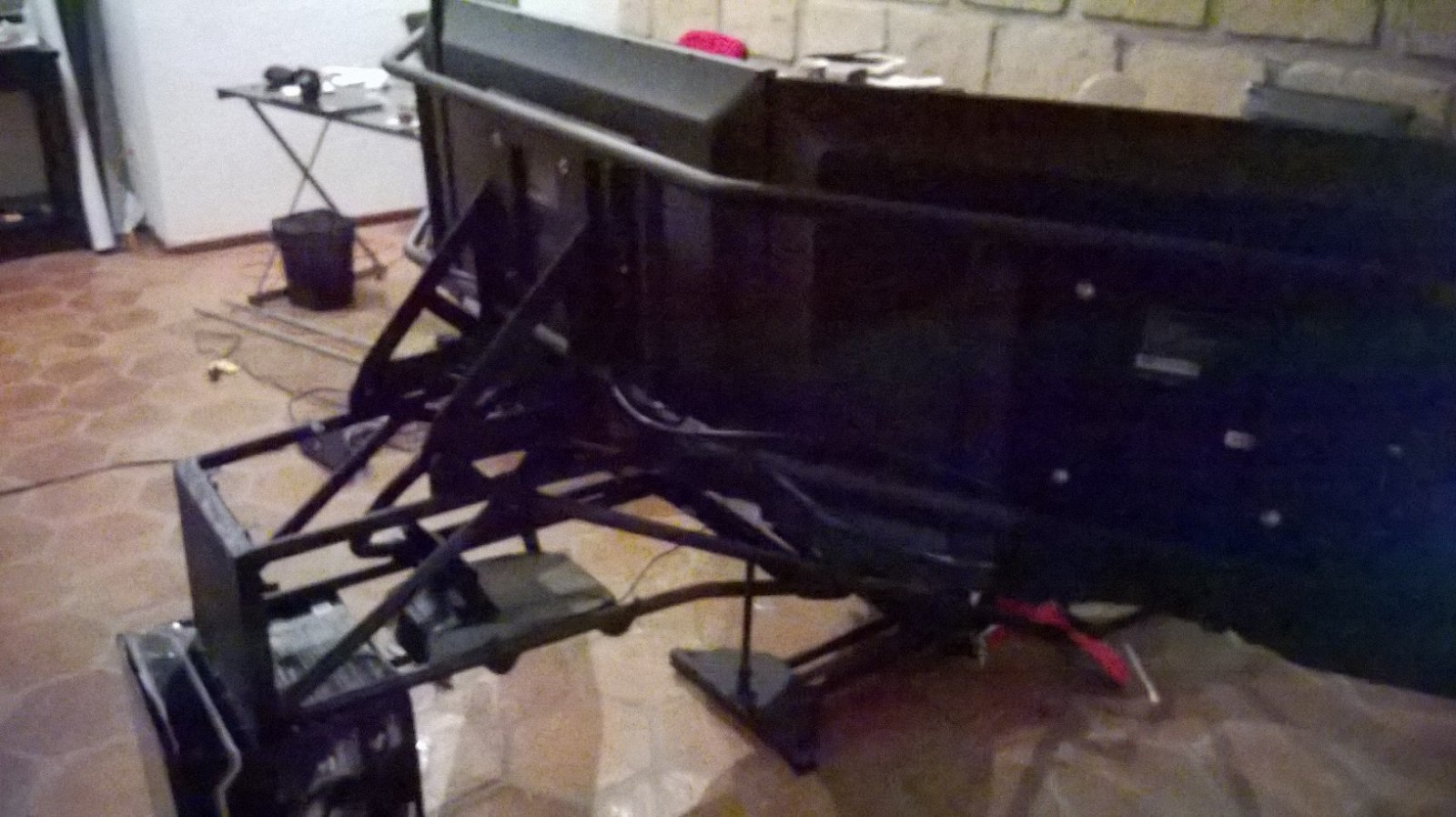

    hi, I'n new here!!!! this is my sim... I'm undestanding the wiring for the 3 dof... mode 1... I can't find the complete diagram for the wiring!!!! help!!!!

    I just burn 2 monster moto and 1 arduino jajajjaja my power suply is 12v 30a... is it enough?? the motors seems to be insolated... but I'm a mechanical engineer don't undestand electronics so much...

    hi, FI you will find all information on the first page... How can you power on the MMs before you did not check the wiring finally? And how you can be sure that you burned two MMs?

    I don't have idea of what I did... well... the motor was shorted :) jaja I went to see a friend and he point it out... but how do a wire the 3th motor??? with the 2od MM??
    and I have another problem... the motors rotate faster in one direction ¿?¿?

    You really need to put all of your questions on your own project thread, which you can create here: http://www.xsimulator.net/community/forums/diy-motion-simulator-projects.22/
    On your project thread tell us about your simulator so members know what they are advising about.
    I am guessing you are using wiper motors but have not ground isolated them, but there is no way to be sure until you provide a lot more information about your simulator: http://www.xsimulator.net/community/faq/wiper-motor-mandatory-ground-isolation.25/

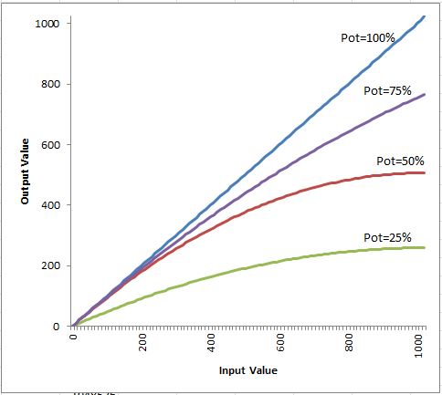

    I would like to ask how the case without using the potentiometer, directly in code settings to achieve non-linear scaling and scaling values defined?

    Can you give some more detail I don't understand what you want...
    SMC3 Scaling is only useful if you use a POT, otherwise just adjust the settings directly in Simtools.

    Pot output is equal to Clip Input value ?

    The POT is used to "scale down" the values that are sent from simtools. If the POT is turned to Max then the values from simtools are left 1:1 (no scaling). as the POT is reduced the values from simtools are scaled down either linear or nonlinear depending on software config. When the POT is at minimum the values from simtools are effectively scaled to zero so there will be no motion and the motors will sit in center position. Note it only works on Motors 1 and 2.
    I use it to quickly fine tune the amount of motion from car to car. I tuned simtools with the POT at half scale so I can easily increase or decrease from default.
