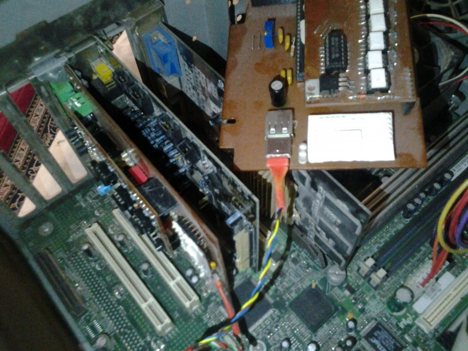

    Hi @speedy
    thank you for this solution that makes 3 AC actuator available simply
    but IMO you should better to drag Ard a little more to the right which the ARD usb port can have access
    from outside the electronic box.
    anyway this is exelent job
    thank you friend
    best regards

    @hooshang ... thank you my friend .
    BTW ... The Ard USB is intended to be connected to the internal onboard front USB of the computer if empty :D:D >>> like this costume red tape socket in my current DIY 2DOF controller ... Or using a normal USB cable connected to the PC back USBs .
    otherwise if you'll be using it in a separate box [2 of them for 6DOF ] ... So, there will be a plenty of space for the normal USB cable to be plugged in through a USB hole plus leaving a decent distance from the edge for bearing the cable load on the socket itself ... also like the above picture ... you'll have an Ard. reset button access hole + a TC at the Ard. side for the 12v computer power supply .
    they are all will have the same ground .:cheers

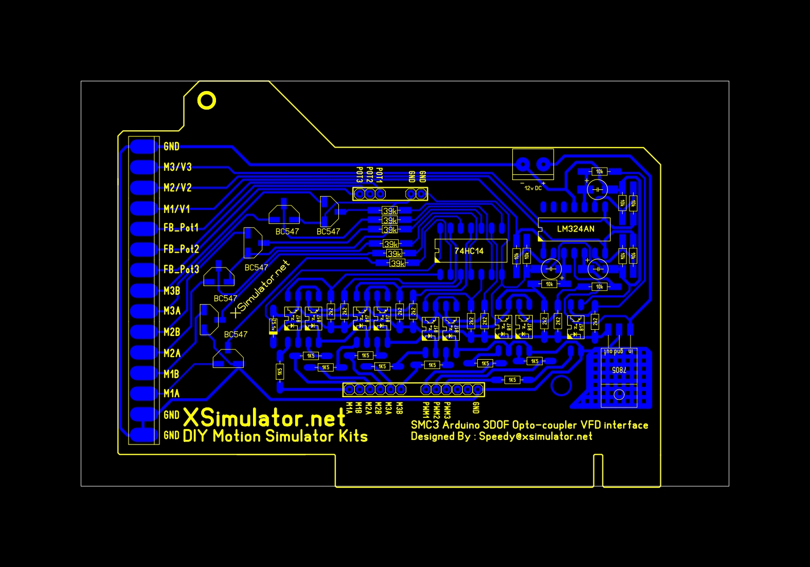

    Finished ... :thumbs
    I've used the commonly used terminal connectors to be angled and welded directly on board with wide pads ... So you don't have to use extra searching for sockets of plugs or purchasing more hardware ...
    I guess this is more easy since this is easier to wire every thing correctly ...
    Here is the final arranged layer picture and the 1:1 printable PDF file ...
    PCI Opto-Copler copper side.pdf
    Edit :board external dimensions will be like this to be easy installed in your computer ...
