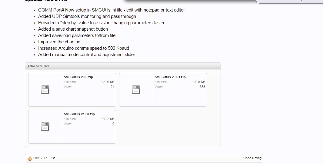

    Thanks very much @RufusDufus ...
    Oh yah ... I'm the first one to download and test this time .:thumbs
    - The Util. opens a CMD window it closes the Util. when closing it ... is that ok ?
  5. RufusDufus
    RufusDufus Well-Known Member
    Jul 21, 2013
    681
    Adelaide Australia
    16,373Coins
    +1,016 / 10 / -1
    Hi @speedy, Yes its OK, I forgot to set the compiler switch to hide the cmd window.
    I'll recompile later tonight and post an update - just ignore the cmd window for now.
