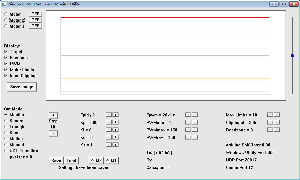

    here is the setting of the SMC3,both motors use the same setting. SMC firmware version 0.7 used.
  10. Pit
    3,007
    30,502Coins
    +3,098 / 31 / -0
    KP=500 is too high and probably not needed- Please reduce to 300 and try to tune the fast reactions within the SimTools tuning manager. If you are not satisfied by doing this, you can raise up to 330, 360 etc.

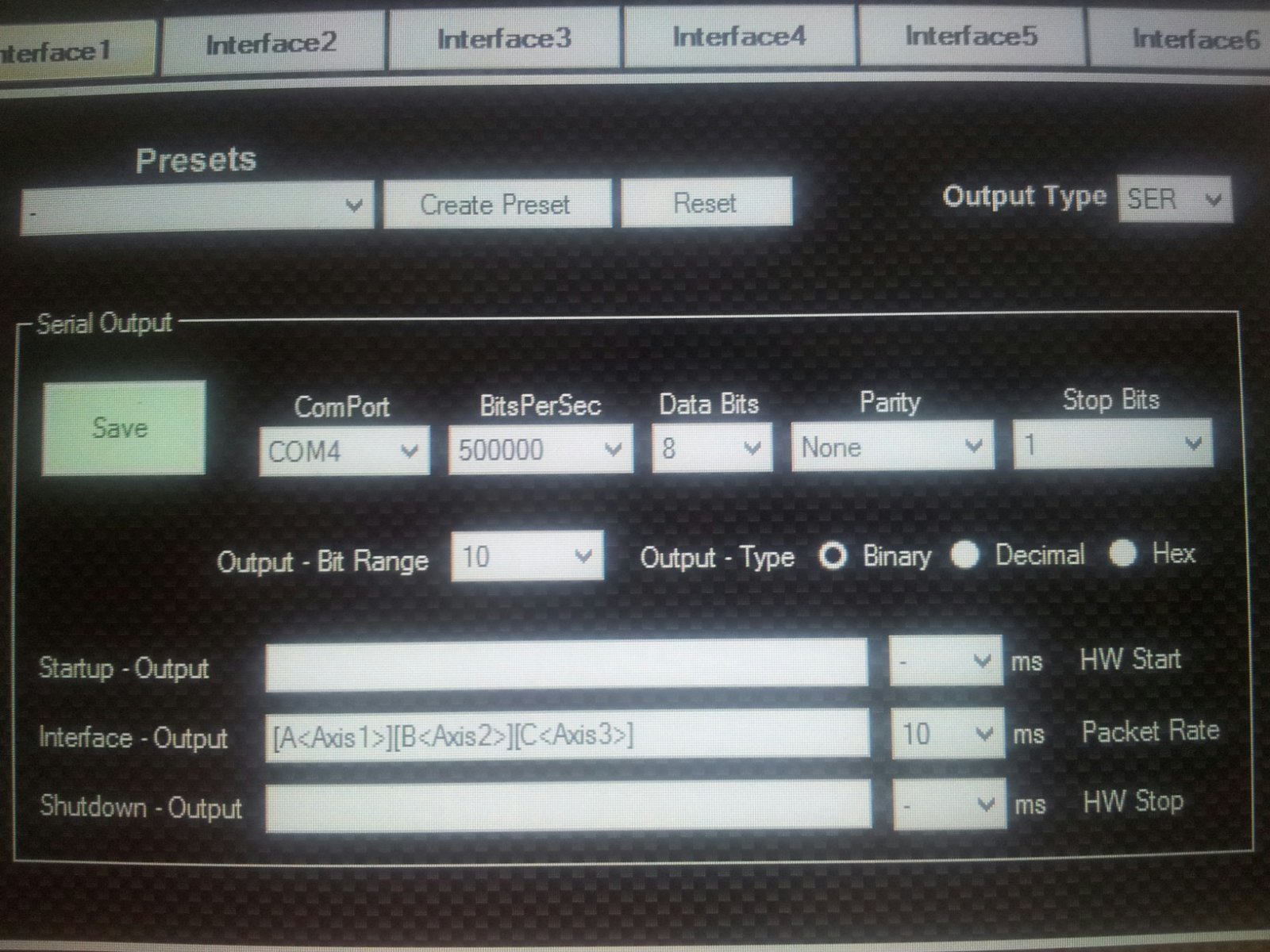

    THX @Pit , I've got second Ardu but how to configure SIMTools then? You can enable two simtools windows in the same time (sorry, but I'm far away from my computer now to check it)? In one window of simtools You can put the data of one Ardu only.
    EDIT: OK, I've read manual and the solution is to configure interface_1 and Interface_2 with two Ardu's in the interface settings, right? What a great software!

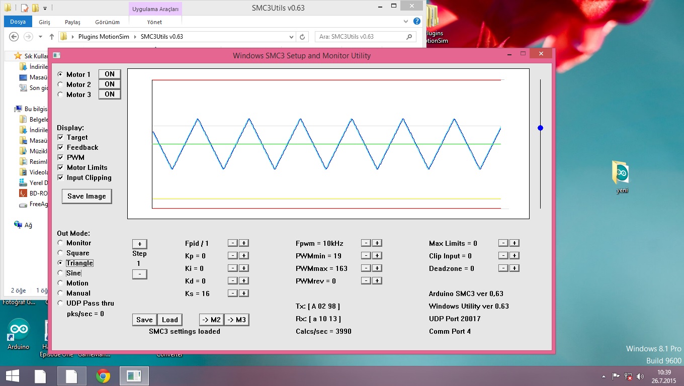

    SMC3 Util. with the Arduino
    SimTools with the Arduino

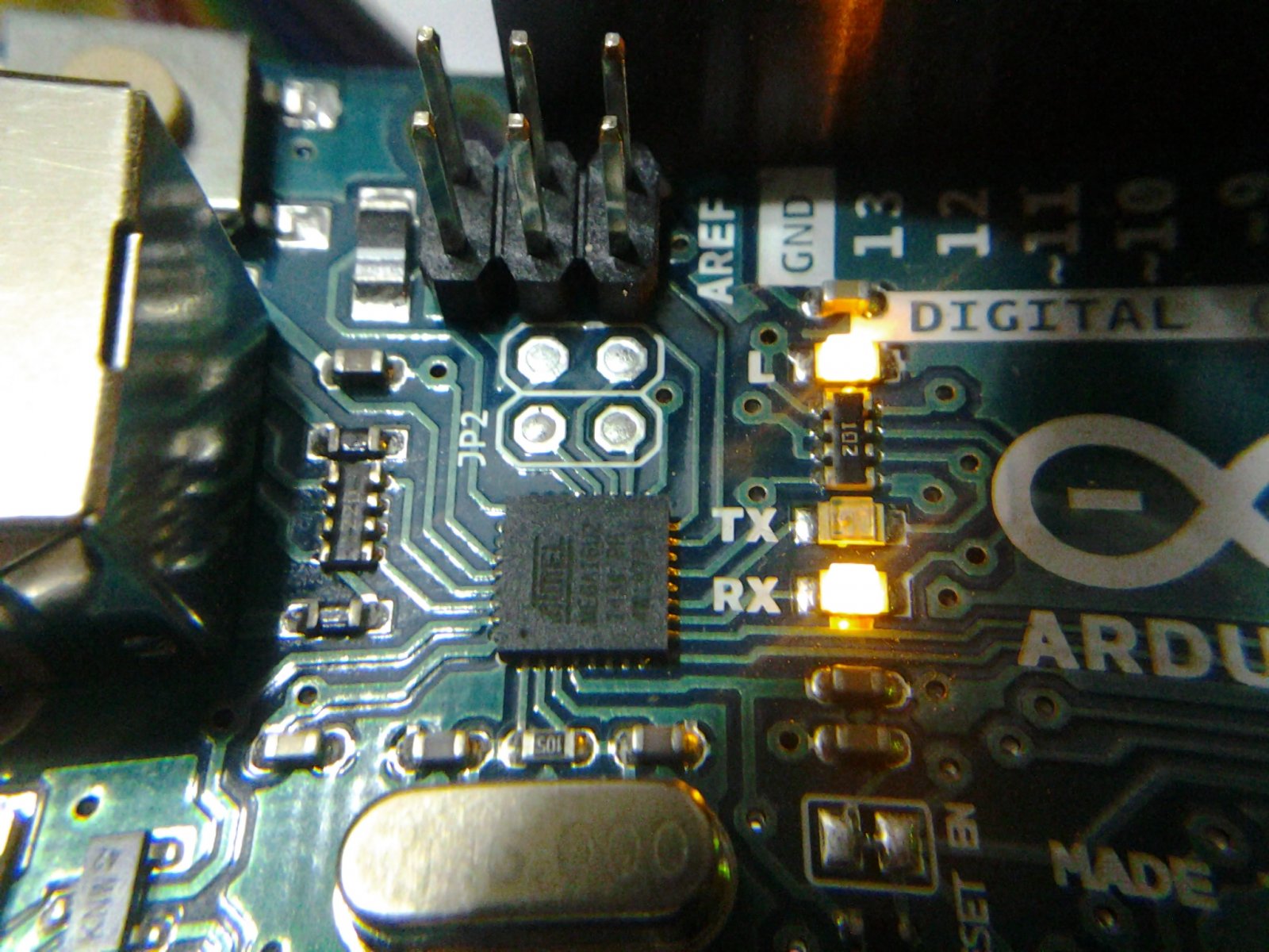

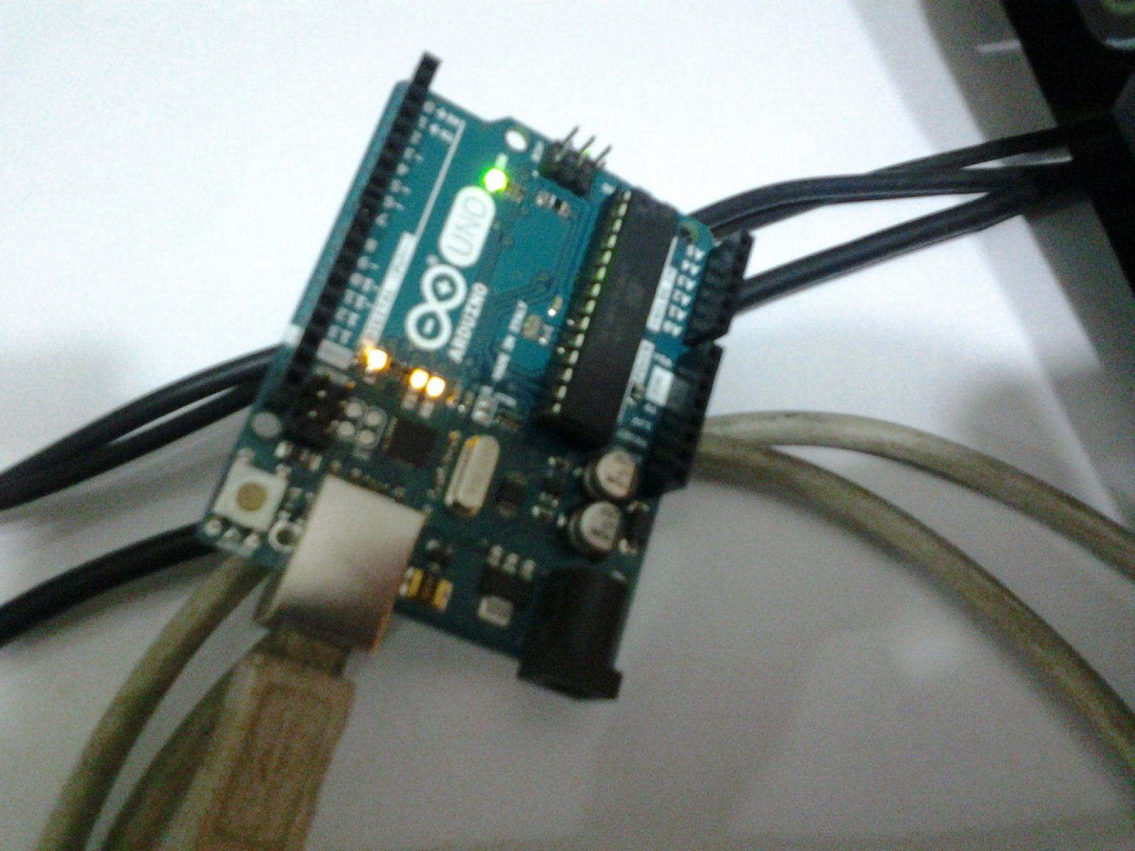

    When using SMC3Utils both the TX and RX serial LEDs will light up because it sends position data to the SMC3 Arduino and also requests data back so that it can plot all the charts on the screen.
    When using Simtools the position data is only sent to the Arduino. Simtools has no need to know anything about the Arduino, it just assumes it is doing its job. Therefore only one LED will light up.
