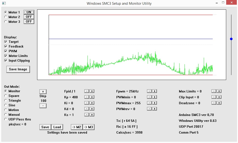

    Sorry to bother, I connected all, but only one motor, I'm really out of my knowledge limit in electronics, could someone tell me by this screenshot why I can't turn any motor to "' ON"? The only way I can get the motor "ON" is putting the max limit to 0.
    The POT is not attached to the motor
    I don't understand some concepts, I tried reading but...
    Thanks anyway!
    22,048
    153,884Coins
    +11,154 / 57 / -2
  9. Pit
    3,007
    30,510Coins
    +3,098 / 31 / -0
    obviously neither connected correctly to the Ard. Please share any photos and videos. Despite of your statement you are a noob on electrics read again carefully the step by step manual which is easy to use.

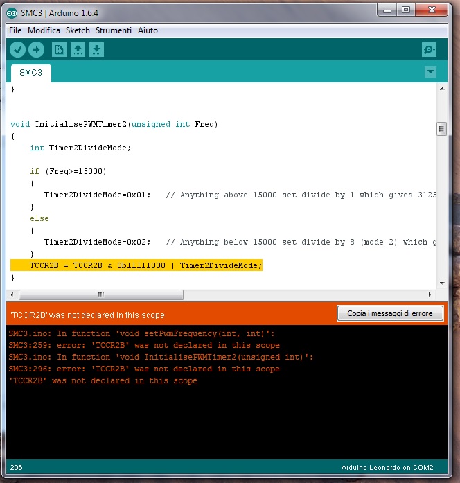

    help me guys I can not deal with them. I have problems with the Arduino code.
    It states that use Arduino Leonardo and monster moto shield I followed step by step the way of connection mode 1, load the code but I get this error thanks

    Thank you very much for your reply.
    I did not conected the POT to the shaft of the motor to not brake the POT because of a bad wiring or any other thing I would do wrong. I thought that I can test before mounting the POT to the motor shaft. The POTs are connected to the Arduino UNO off course.
    Yes, I'd already d/l that guide, but it is about Simtools, and it linked me back to this thread first page.
    @Pit Thanks for your reply
    As I'd keep reading, I found that you had a maybe similar problem, being your POT not wired correctly a year ago. (I try to read all I can before asking), I will try dif combinations of wiring the POTs.

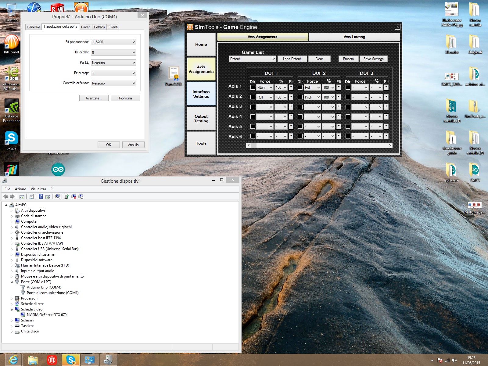

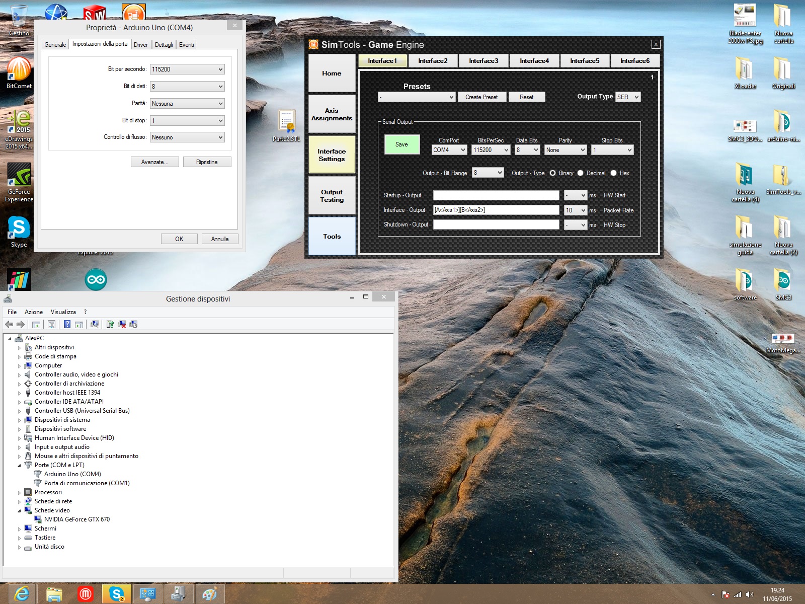

    hi, guys...sorryif i write in this discussion, i hope to resolve the problem without disturb, but evidently there is something that doesn't work. I explain my problem; i mad a 2 degrees of freedon system with two motor , one for the roll and one for the pich moviment. i have see all the tutorial..i have start from cable tutorial for 60w motomonster , for program the arduino one...then with calm i read all this discussion;
    so i have resolve the first problems with smc3utils, and finally all go well. Now i must complete the last part, i must connect the arduino to simtools program. So i read all that i can, but there are sone days that i broke my head without find a solution. I post my desktop settings and i hope that you could find some errors....

    Baud rate must be 500000 not 115200. Also set the arduinos comport back to default settings.
    Your axis assignments are also mixed up, DOF 1 should have same force as Axis 1 and Axis 2, you have pitch and roll on same DOF.
    So do your motors move in the SMC3 utility? Can we get a screen shot of SMC3 utility?

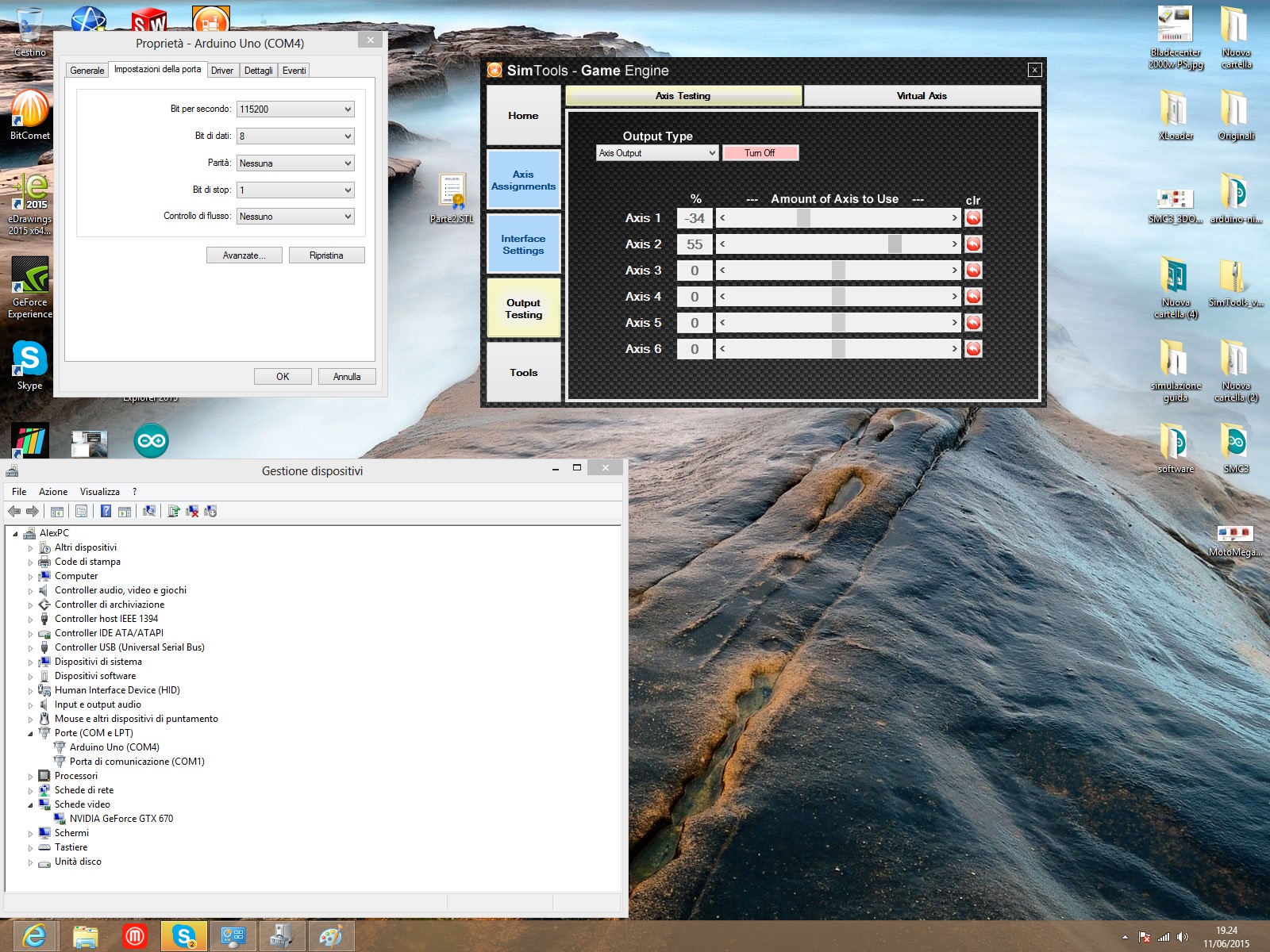

    Yes, smc3utils works very well...without problems...soon as possible i do a screenshot....today i set the baud rate to 500000, but i have no moviments..fortunatly Pit said to me that smc3utils and simtools cannot run together....
    Another question...so in the dof 1 do i must set only pitch (for example) in the axis 1; and in dof 2 i must set roll (for example) in axis 2?is it correct?
    Or do i must set in dof 1 pitch for axis 1 and always in dof1 roll in axis 2? thanks a lot

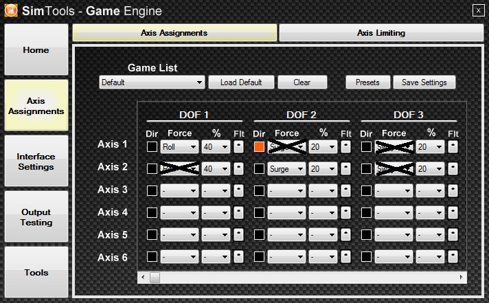

    Either case you should get the baud rate to 500000 as the code utilizes that rate. Have you set baud to be different in any other settings like the SMC3 code itself? There is no reason 500000 should not work.

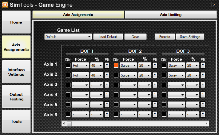

    For axis assignments do not have each DOF at 100%, instead make sure all AXIS add up to 110% or lower. Think of the percentages as movement of the lever, if you have 100% for one DOF then there is no more movement left for other DOF
    DOF 1 DOF 2 DOF 3 DOF 4
    Axis 1 pitch roll surge sway
    Axis 2 pitch roll surge sway
    This is my setup:
    I do not use pitch because of how I made my sim and my axis do not add up to 100% because that's how I like my movement. Your setup will be different as will almost everybody else. You will tune your setup to how you like the movement.
    Pitch = level changes in the road, going up or down or over bumps.
    Roll = road changes angle on the side or ripple strips on side of track
    surge = Acceleration and braking
    Sway = Lateral forces like when you make a turn.
    These are not definitions of those forces but in-game that's what I have found that these forces equate to.

    ok, so if i understand i must have a configuration as i do in this immage that i have link...correct?naturally i must change surge with pitch.....correct?
    I remember to you that i have a motor only for pitch and a motor only for roll... thanks another time and sorry if my hand is a brick....

    Boys...thanks a lot for support...now the simtools works well...i think that simtools and smc3utils work together..and it is wrong...
