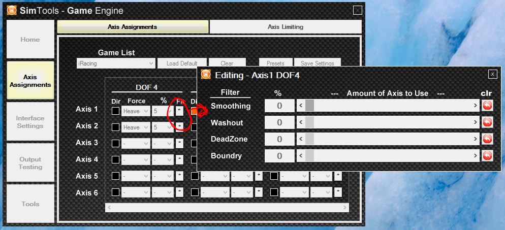

    Hi Eric, sorry can't think why that would be, You don't have a large deadzone set in SMC3 by any chance... although that would also effect SMC3 Utils.
    I haven't used that part of simtools much, but did you know against each axis DOF there is a button that pops up a window and there is a Deadzone setting in there are you sure there is nothing set in here - I think you need to check the default profile?

    I checked the settings and the "Deadzone" in SMC3utls is settled to "0".
    It is like my engine is glued with SMC3utls signal, so my problem is surely with Simtools setting is not it?

    setting of SimTool :
    serial : 115200b, 8N1
    10bits range, binary type, 10 msec.
    filters: smoothing, washout, deadzone, boundery = 0%
    axis limiting = 0%
    deadzone in Arduino = 0
    thanks for your help ! :)

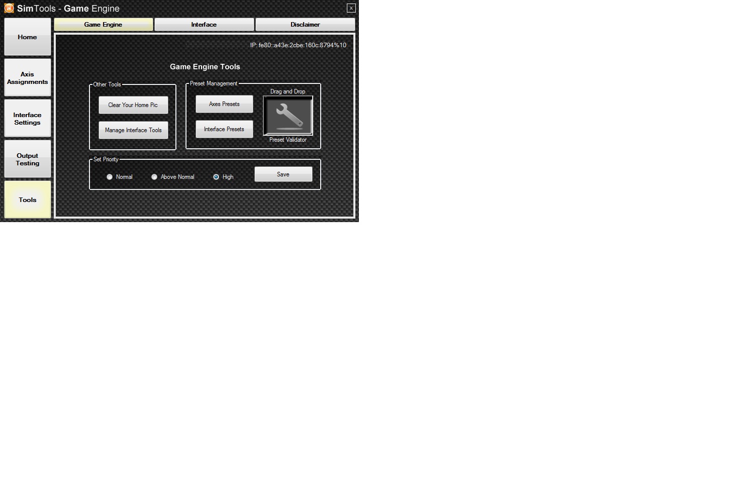

    Actually just noticed in the video what you mean by SMC3Utils seems to hang. This is odd its like the timing routine has halted... and it sounds like the motor moves once when you are in UDP passthrough?
    I notice you have Simtools set to High priority? Perhaps while testing put this back to Normal to make sure it is not stopping SMC3Utils from working.
    What sort of computer and windows is it?

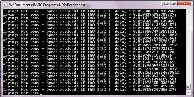

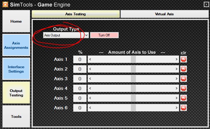

    @ericRacer, I have been doing some testing... I have never used the Simtools output testing before, so I gave it a try. I actually noticed the strange step response you were experiencing in the DOF output. So you definitely aren't alone and I am sure it is coming from Simtools. I can't tell you why at this stage. We may have to ask @yobuddy for help here - I wonder if the default Tuning center values have any impact?
    If you switch to the Axis output in Simtools (see image) you should notice the effect goes away and the motors move smoothly - note in this mode one slider maps to one motor, so you will only get one moving at a time. Also note this step effect isn't present in game motion so it only effects the DOF output testing.

    To be sure, I uninstalled my anti-virus and disabled my firewall, I also put priority to "Normal". I have a UDP communication 28-30 pks / sec. but it continued to hang. :confused:
    Exactly ! :cool: and as soon as i reselect "Square" or "Motion" or something else, everything come back normal and works fine. :sos
    I think the same thing, if you noticed in my first video(at the beginning), I choose "Axis output" but I still weird step response. o_O
    i didn't noted that in game motion...i am gonna to try it :cheers
    thanks :grin:grin:grin :thumbs

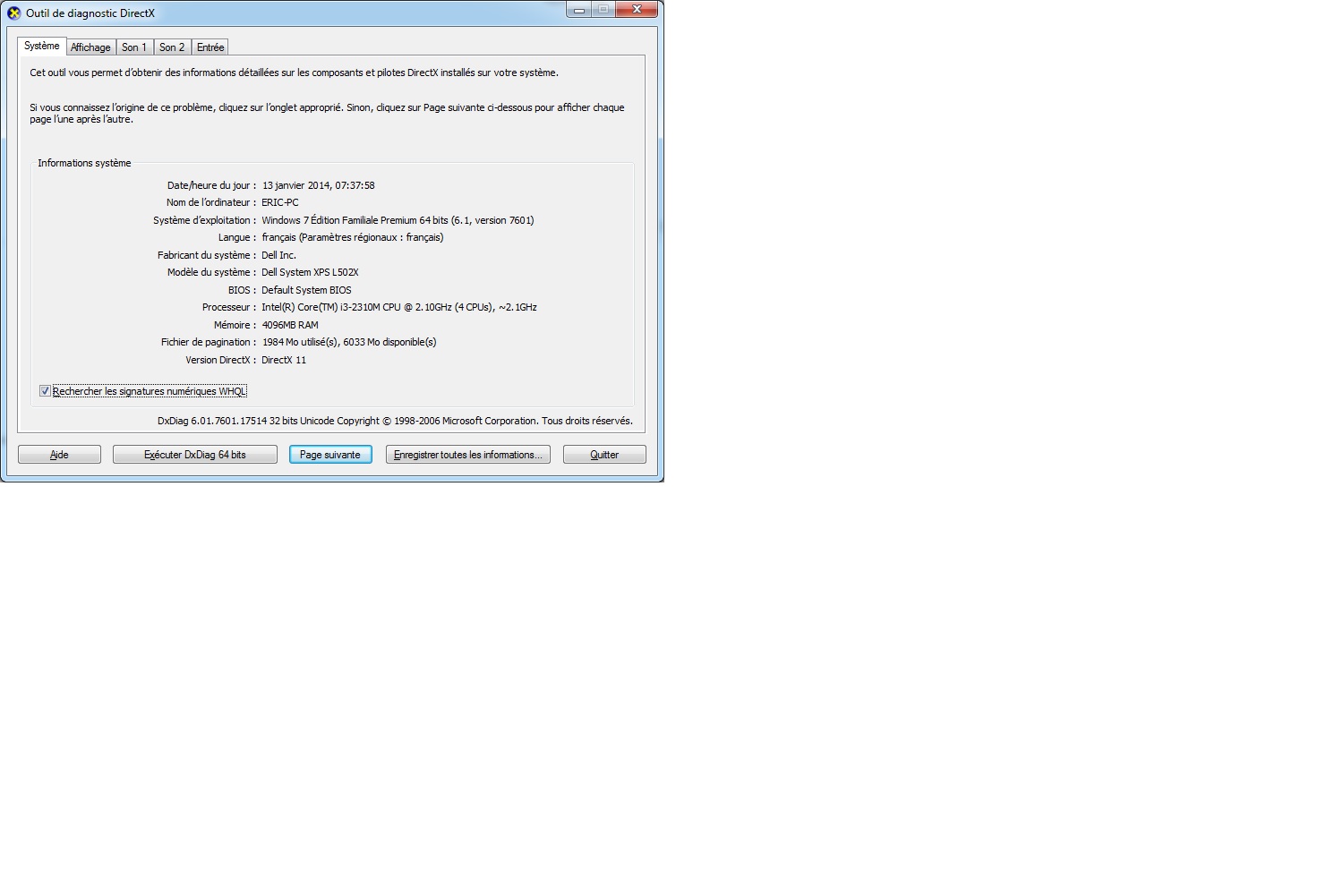

    I believe there may be something not right with your computer/windows setup. Something seems to be preventing SMC3Utils from getting sufficient time to receive and process the data. Lowering the priority of Simtools gave a bit more time to SMC3Utils as the packet rate increased somewhat... but it should be up around 80-90 pks/sec.
    What version of windows are you running and what is the specs of the computer?
    Very strange... I have tested on three different computers both together with Simtools and on separate machines and always sits at 80-90 pks/sec with a 10ms delay in simtools.
    Attached is a simple console program that tests for received UDP data on port 20017. You could give it a run on the computer normally used to run SMC3utils and see what it displays.... the delay between packets should be around 10ms if that is what is setup in simtools. See image:

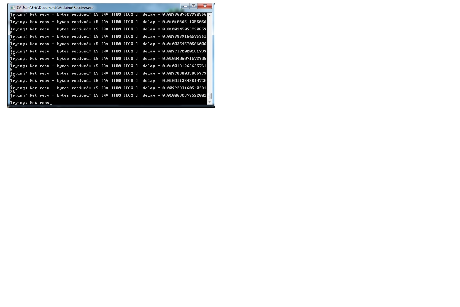

    Hi @RufusDufus ,:)
    Wonderful, this little program.:cheers
    here is my spec. :
    UDP communication seems normal like you.:think
    But against, I think the step response problem comes from simtool with manual mode. I made a small video, we see the Data change but the Datas stops change when the slider is around the middle !:sos
    thanks again :D
