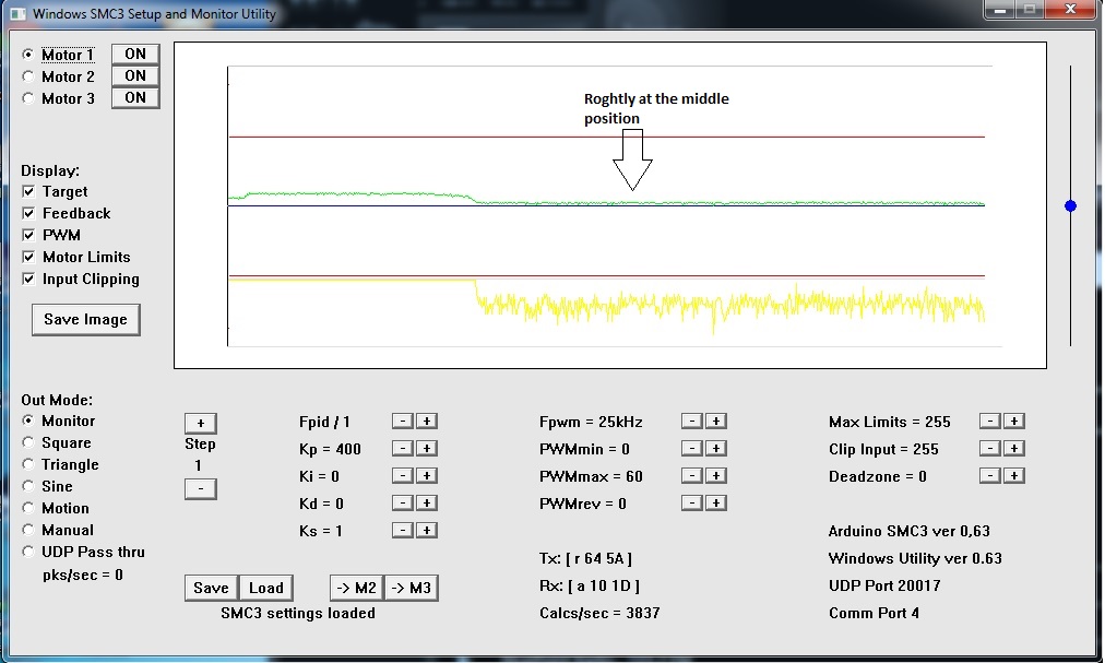

    Thanks it better now:
    If I understand the whole thing right @ 83 I got the movement and afterward the amount was too much and it clipped it and went to offline?!
    Also motor 2 does not move at all.

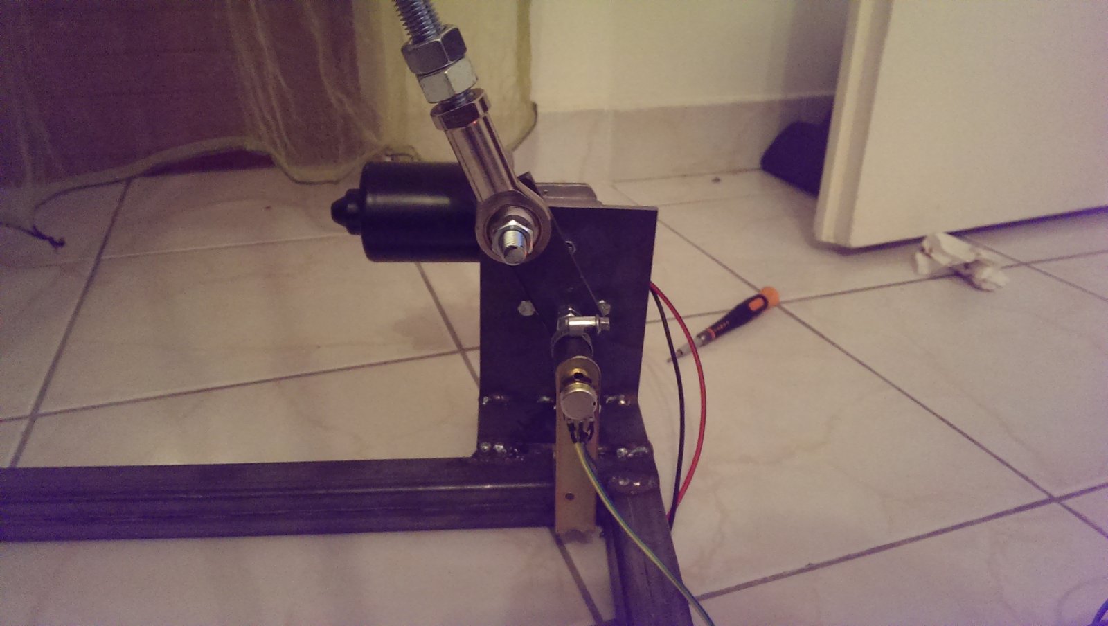

    Might my pot/arm position be wrong?
    I have set the middle position of the pot to this arm position:
    Also if pot is not in the middle position there seems to be no power:

    The post is VERY close to the middle position...BTW I do not understand how builder like you do not test all parts and components before putting together. The very first step should be: one motor, Ard, one driver, one pot, wiring and the PSU of course. Pot and motor are not connected to each other to avaoid any damage. I would go back first and foremost to understand all the steps to get the rig working. Regards, Pit

    FWIW -Shouldn't the crank-arm be horizontal, and the pot itself being moved left/right to get get line in center????
    This is the way I've done mine and they work fine in reading...............in the picture, the crank-arm looks to be in almost full up position, but line in SMC3 Utility is almost centered.

    +1,016 / 10 / -1
    This is correct. If the feedback position goes beyond the Max Limit setting (shown by he red line) the code shuts down the motor until reset or power cycle.
    In the video the feedback position (green line) is the same as the target position (blue line) therefore the motor is already in the correct position and doesn't need to move. Change the target position by moving it using the slider on the right while in manual mode, or select sine wave triangle for example for the target to continuously move and see if the motor tracks it.
    As above if the target and feedback lines are in the same position then the motor does not need to move so no power.
    In general the videos seem to suggest the system is working as expected... just needs tuning of the parameters.

    Gents,
    What do you think:
    To me it seems my PWM is not good enough, even though the motort both move at one stage!
    Any tips for me?
    Thanks in advance :)

    There must be something really wrong. If you raise the power, the potentiometer line (feedback) and motion line (target) should be the same.

    I would say PWMmax is way too low. I think I have it set about 200. The reason for recommending a low value when setting up is to minimise the risk of breaking anything.
    If your setup can handle it you can use a PWMmax of 255 (the max allowed) but most people find if you drive things this hard the H-Bridges overheat or the Power Supply switches off.
    The PWMmax sets the maximum duty cycle that the controller will drive power to the motors. This max duty cycle will be PWM max / 255 *100 % The actual duty cycle at any point in time will vary within this limit based on the other PID paarameters and target/feedback position.
    Once you have that changed the next most important value is the Kp value. Adjust the values in turn to see how they effect the response.
