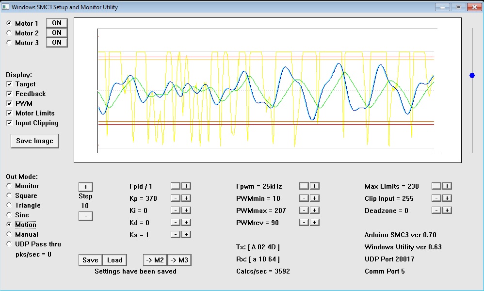

    @Outatime, I just noticed the screenshot of your settings. The PWMmax is way to low for normal operation. This is fine for testing to minimise damage to anything but you will probably need something at least 200 or more for winch motors.
  4. Outatime
    Outatime New Member
    Apr 21, 2014
    29
    205Coins
    +6 / 1 / -0
    I've found the solution.
    The motor "brakes" (right to the lever wheel) on the winch motor was too tight. It stopped the motor from reversing. I have removed them.
    Now it's working !
    See pictures. Tried it with PWMmax 126 and PWMmax 207.
    It's not exactly following the feedback line. Is that normal ?
    What are the yellow peaks ?
    The PSU was still working with PWMmax 126.
    At PWMmax 207 it was working with the car battery only and followed the feedback line a lot better.
    Thank you.

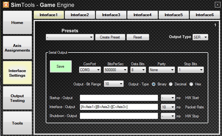

    I'm very happy that my setup is working now.
    @RufusDufus
    Your tutorial on page 1 is very good but still got me noob stuggling on some parts.
    After the last points of the Initial Setup I reduced all the PWMmax values back to 0 because I was aware of my motors.
    I did not realise that all values were written live into the Arduino memory and stored there.
    So I was trying out the SimTools Game Engine output mode and nothing happended because the values were zero. It drove me mad trying out several axis settings and interface settings without a result.
    I thought SimTools is producing it's own values.
    At first I sticked to the Game Engine because for me as a beginner the GUI looked easier and I hoped to get quick results out of it without having to try out so many SMC3 values.
    It would be good to post a screenshot of the interface settings for SimTools for your SMC code too. I know the settings are in plain text on page 1 tutorial.

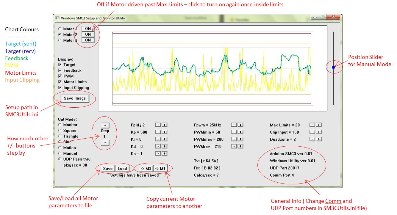

    When I started with SMC3 this picture was not there:
    On the first sight your SMC3 looked very confusing to me with all the strange values and opportunities.
    I did not realise what the points "Out Mode" on the left bottom corner are doing.
    I was afraid of doing something wrong to click somewhere and my motors would go mad. :)
    Now after some time with the SMC3 tool I know what all the bullet points (sine, manual...) are doing and the program GUI is not that difficult.
    But for beginners like me a detailed explanation would be fine.
    For example:
    Switch to "Manual" to move the selected motor with the slider on the right side.
    Switch to "Motion" to get a motion simulator like output.
    That were my thoughts on making the good tutorial a bit better for dummies like me. ;)
    Thanks for your help and program to make my motion sim possible. :thumbs

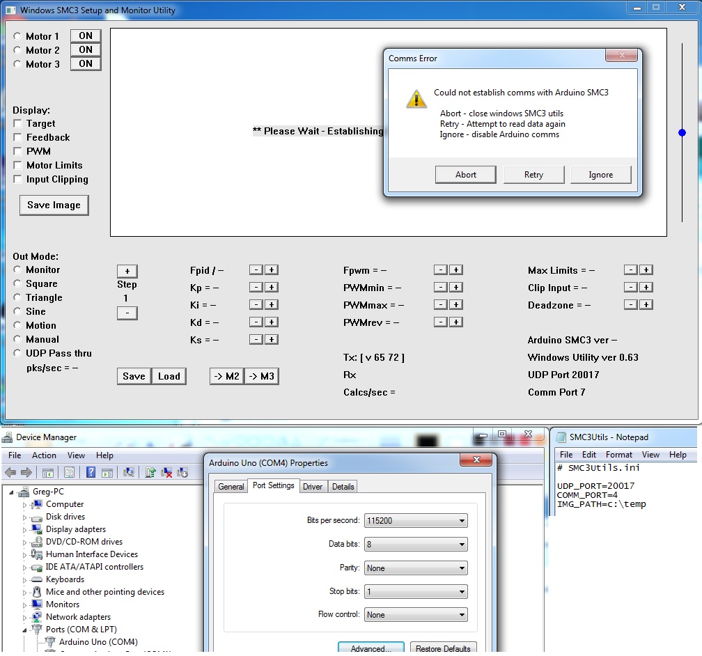

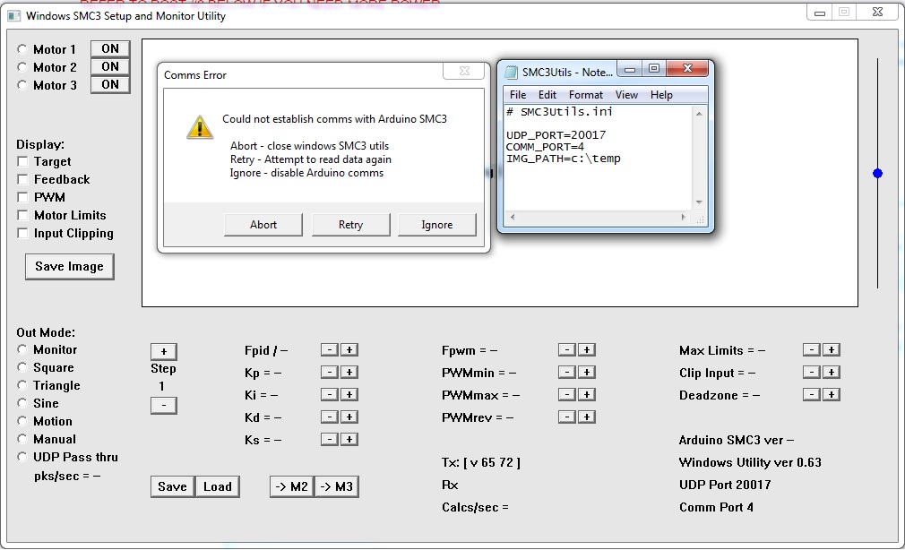

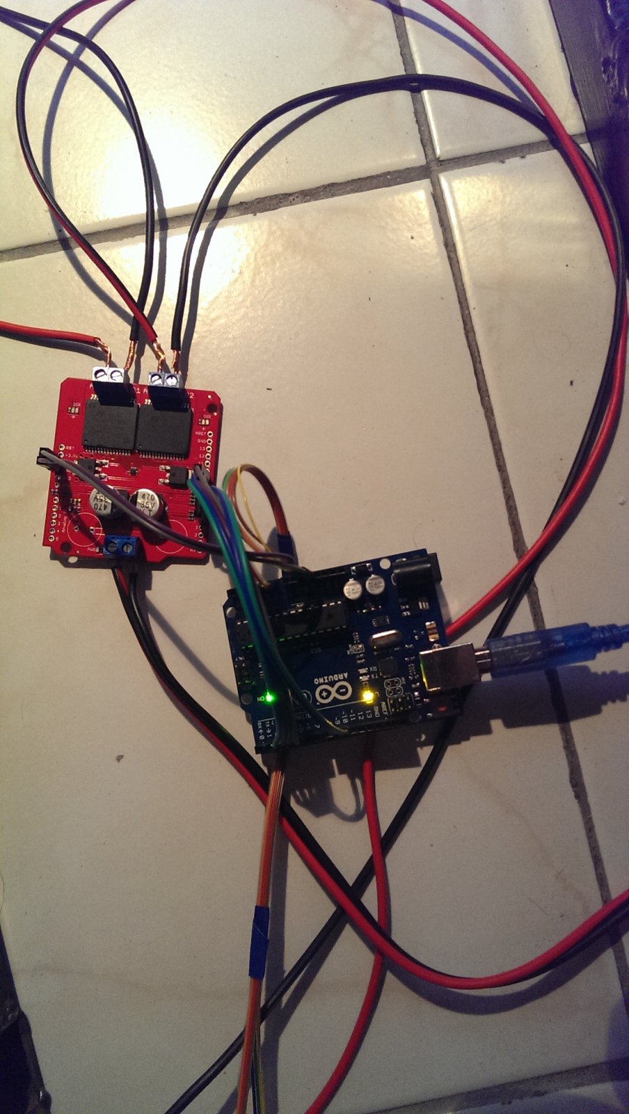

    Gent, it seems that I'am stuck on the 4th step of the SMC3 seeing the Arduino:
    [​IMG][​IMG]
    Run the Windows SMC3 Utility software and make sure it communicates with the Arduino (There is no need to set baud rates, they are not configurable)
    What can I be doing wrong?
    I have the SMC3.ino uploaded and it was successfull!
    Any tipps for me? Much apprechiated!
  15. Blame73
    Blame73 Well-Known Member
    Nov 6, 2014
    1,215
    8,307Coins
    +1,134 / 5 / -0
    SMC3 says you're using port 7 (lower right)
    Check your settings again

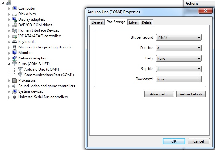

    Unfortunately still the same...
    Arduino is visible properly for its own software and in device manager:
  17. Blame73

    Firewall?
  18. Greg83
    Greg83 Active Member
    Feb 2, 2015
    104
    IT Specialist
    Budapest, Hungary
    328Coins
    +46 / 0 / -0
    Turned firewall and virus protection off and still the same.

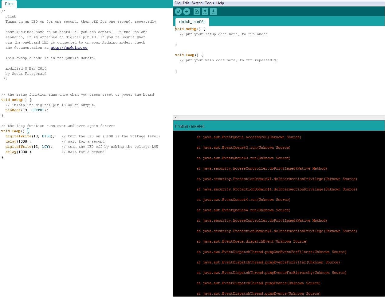

    Is the SMC3 code supposed to look like this for me? Because the blink one look a hell lot diffrent and that is running fine on it:
  19. Greg83
    Feb 2, 2015
    104
    IT Specialist
    Budapest, Hungary
    328Coins
    +46 / 0 / -0
    Indeed that was the problem, for some reasone when opening up the file it did not display the code for me.
    Now it is working :)
