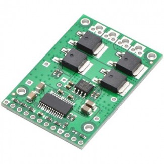

    I would use SMC3 in MODE1 which can drive the Pololu board in its "Sign-magnitude (drive-brake)" mode
    Connections would be:
    SMC3 <----> Pololu Board
    GND <----> GND
    PWM ----> PWM_H
    ENA ----> DIR
    ENB ----> not connected
    not connected ----> PWM_L

    Hit there again,
    Can you explain why you recommend the pololu 20A motor controller and the arduino with youre code work in mode1?
    I thought that mode1 is for h-bridges with the 3 pin configuration : 1 pin for pwm and 2 pins for direction.
    mode2 with 2 pin configuration : 1 pin for pwm and 1 pin for direction
    The pololu 20A is a 2 pin h-bridge if I am not mistaken, so I thought it would run in mode2
    My previous setup was 2 double wipermotors with arduino and pololu 14a... That worked fine but the wormwheels weren't strong enough.
    I was using SIMCTRL.
    Now I have mounted 2 big wormgear motors. The ZYT-155-12. These are 23a peak. Really strong, but the pololu 14a
    can't handle them.
    So thats why I want to switch to the 20a version and youre software.
    Will they do the job? I think the pololu 20a is a good solution.
    greets Jeroen

    Hi Jeroen, in MODE1 the controller outputs a PWM duty cycle that sets the speed of the motor, and the ENA and ENB pins are used as direction outputs (one is just the invert of the other as some controllers require this) If you only need one Dir pin for your H-Bridge you just use either one of the ENA/ENB pins.
    MODE2 actually inverts the PWM Duty cycle when the motor reverses. This is a special for the Chinese 43A H-Bridges - I actually haven't found any others at this stage that work this way, although I haven't been searching for them. ;)
    As I've mentioned before if you have a toy motor and 9V battery that is always a good way to get confidence in the setup.

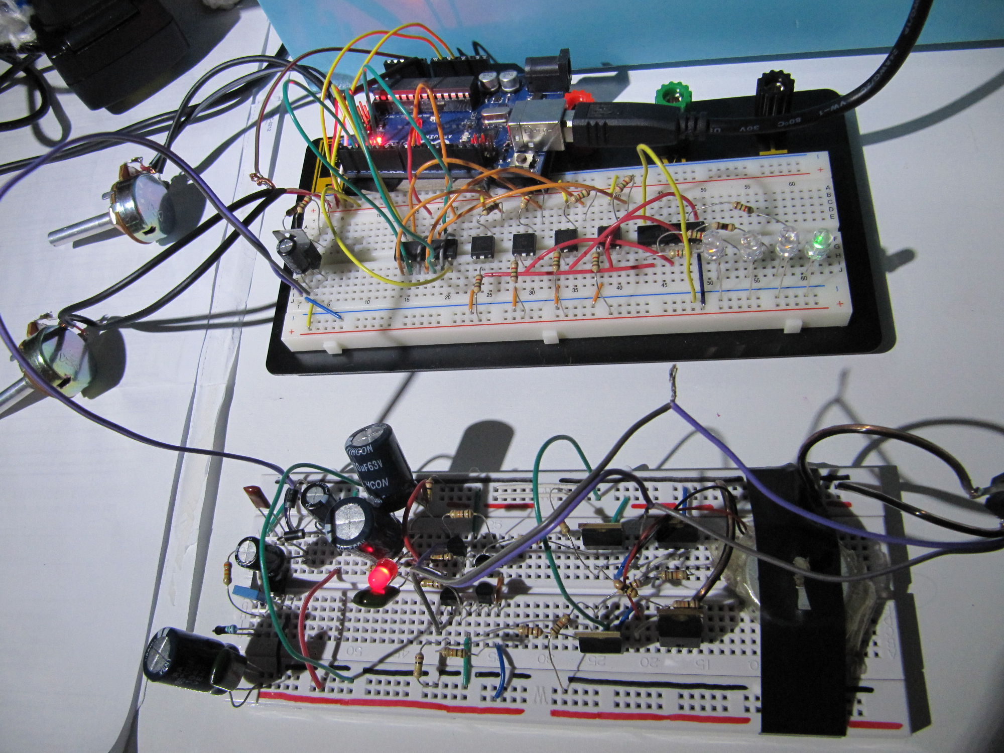

    I am facing this problem that the pots interfere on each other. Very annoying. Has someone else seen this happening? I recently discovered that my uno is Clone and i am afraid that this could be the problem.
    I spend some time on arduino forums and read something about pots <10k are optimal because of impedance...
    10k pot could help on accuracy but I am not sure if this would be related to interference on each other anyway :C

    Hi rafael_design, I wouldn't expect the pots to interfere with each other. 10K should be fine. some questions:
    What are you seeing that makes you suggest they are interfering with each other?
    Can you post some closeup photos of your pot and motor wiring so we can see if anything doesn't look right?
    Are you using Arduino and SMC3 or some other controller?
    If you disconnect power to one motor does the other work as expected?

    Leds representing the motor pwms. It is way better now with 22k pots. Much lower noise spikes in the graph. But as you can see in the video below there is remaining interference. But I am not sure if it is a big deal or I am being too perfectionist.
    http://www.xsimulator.net/community...9/?temp_hash=3b57fa65ef76266cd0fd0d980bd35029
    Unfortunaly at this moment I am using Arduino and another software. I tried SMC3Utils this afternoon but, as I am not with the pots attached to the motor I think I would not be able to follow the Utility intructions:
    " 9. Now slowly, increase PWMmax… at some point the motor should start to move. When it does check the “Green” feedback line is moving toward the “Blue” target position.
    • If it is then that motor and feedback is wired correctly - proceed to test other motors. "
    At this moment I am using only one motor and I think it is working fine.
    Wish you all the best new year,
    Rafael.

    @rafael_design, OK so very much at prototype stage, good to see you testing your design first... I am surprised that you get interference from one pot to another? Do you have pots connected to all the analogue inputs or just the one you are adjusting? If the input pin is unconnected it will definitely be influenced by other inputs. It is difficult to see in the photo - I wasn't expecting to see a proto board layout :grin Do you have the pots connected to the Arduino +5V and GND with the wiper pin connected to the Arduino Analogue input?
    No need to use SMC3 if you have something else working... however if you want to it doesn't have to have the pots mechanically connected to the motor. SMC3 Utils will show you the current pot position and target position - if you manually turn the pot the motor should slow down as the position gets closer to the target position. It may help to see what is happening with the analogue inputs?

    Yes I have two analog inputs connected to two pots (you can see the two pots in my last post picture). I already noticed that if one pot is unconnected then this input is influenced by the other pot. Both pots to 5v, gnd and analogue input of arduino.
    I will give SMC3 Utils another try today.
    Remember I said that with lower ohm pots I noticed very big difference in noise in the software reading interface AND I am biased to think we cant get rid of this little interference (which seem to be smaller with lower ohm pots too). And probably it will not have big influence in the final product (I hope so :D)

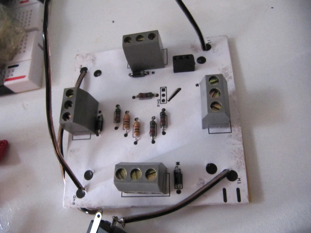

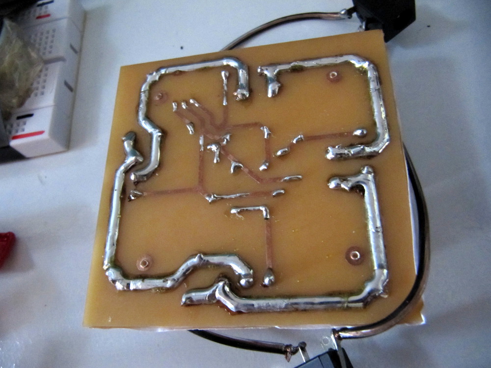

    I designed this new h-bridge and will test it now. I will post the results.
    Fingers crossed please! :D

    OK, sounds like you have things under control for now. I am still a bit surprised with analogue inputs but hopefully not enough to influence the control. It may be that there is some ground noise from the motor drive circuits causing problems. Given it is all on breadboards the ground may not be as solid as the final layout. Lets see how your H-Bridge goes. Good luck and have fun! :cheers
