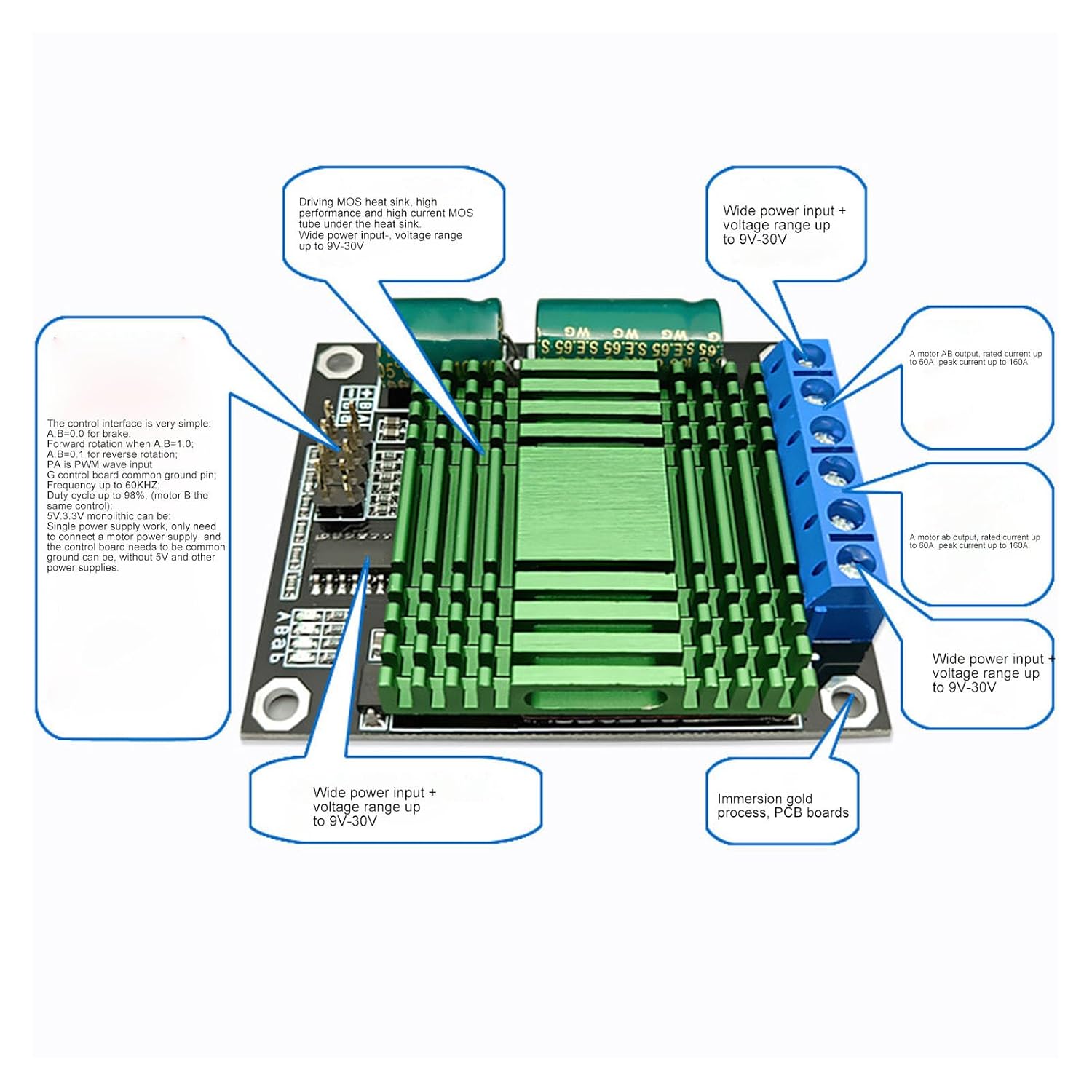

    While searching a little bit, i found this drivers: [​IMG]
    From the specs it looks got for me to drive both of my motors. Has anyone any experience with these drivers? They are a little bit easyer to source than the 100 A ones. It says 60A per channel.
