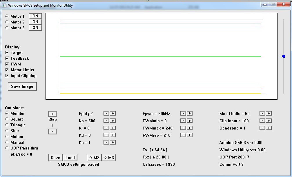

    SMC3 is actualy incredible job,:thumbsthank you friend for sharing and supporting
    to me at least it has this very important lesson that code plays a major role comparing
    with other parameters.now my sim is much smoother than before and almost
    get rid of those tiny steps during very slow changing direction, all the set up and wiring took me
    an hour(without all last weekend I spent to reading all the posts...;))
    ok here is my smc3util setting:
    this is as you generally recommend, but if i want to get more ...
    and better configuration and setting, what should I do ?
    thank you again
    regards
    Hooshang

    Hi HoosHang your settings are already close to the limit. The Pwmmax can be pushed to 255 but that is all. That means your hardware like the motors is limited powering up your rig.

    Yes PWMmax can be increased, you basically have it set to 200/255 = 78% max duty to your motors. Of course increasing this will place the h-Bridges/PSU/motors under more stress so if they're not upto it you may have problems. If you have the Big Worm Drive motors commonly used this shouldn't be an issue for the motors as long as the H-Bridge and PSU can cope.
    Other areas you can tweak. Increasing PWMmin helps get the motors moving and is often good for improving smoothness. I have noticed that this can sometimes create some motor noise depending on your setup.
    Kp, Ki and Kd can all be increased to fine tune the motion. Have a read of the first post it talks a little about these.
    Last of course is the mechanical setup. If there is any slop in the mechanical connections anywhere that can cause jerky motion especially between the motor and feedback pot.

    SMC3 is great, but it has still some space to work to be best and it actualy worth it , it has a lot of advantage
    comparing others, first it can drive three motors and can freely set with any motor driver boards ...
    thank you Pit and RufusDufus for informations
    I increase PWMmax to 240 and what is the optimum number for PWMrev?
    I cant increase PWMmin,as soon as adding any number make motors noise ,haw can I get rid of this?
    and what combination of Kp,Ki, and Kd is the best setting and how should I configurate them
    thank you friend
    best regards
    Hooshang

    I use the same value as PWMMax.
    That is not an issue. If the motors are too noisy set the Fpid to "2" instead of "1".
    What the values mean you can read in the documentation which @RufusDufus has been provided. The Kp value is responsible for the "hard" turns. The higher the value the better (harder) the turns. The speed of the motors wont be affected.

    Fpid is already set to 2 ,but still has the noise even increase a few number to pwmmin:think

    PWMmin if needed to hold the position will produce some noise. That is not a bug but a feature :). If your motors have a planetary gear there is no (or only a little) PWMmin necessary.

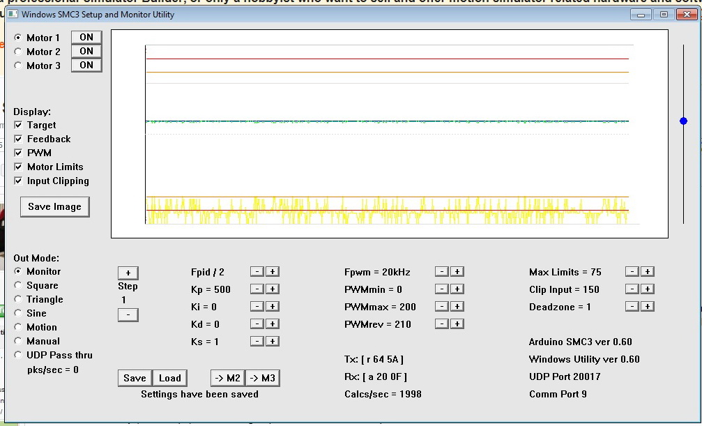

    then,iam using Arduino uno and pololu vnh2sp30 dual controller
    and the same hardware setup as i used Prilad code(thanks him)
    and actualy no problem with simtools setting and profiles
    what i am realy looking for is that when i changed code to
    SMC3,i found lots of difference interms of resolution however
    it got much better but i think specially for flight sim we still need
    maybe a little more bits or configuration or codes...donno...and as i
    follow the related posts you discussed with other experienced members
    who persist on using other board famous JRK,i realise there is not
    long way to reach or even take advantage...
    here is my updated smc3util setting
    thank you friend
    regards
    Hooshang

    I'm glad you are (almost) happy. Without knowing exactly what you are trying to improve here are some things you could try...
    1. I notice you are using ver 0.6 of both SMC3 and Windows SMC3 Utils. There has been a version 0.63 available for some time and I would recommend them.
    2. Kp can be increased further and may help if motion seems jerky. TRY THIS FIRST. It can increase to 1000 but try increasing by say 100 at a time. Note all parameters can be changed to whatever ranges Windows SMC3Utils allows. Kd may need to be increased to balance any overshoot created.
    3. Adding some Ki may help with slow motion tracking. increase by 50 at a time and see how it affects motion.
    4. If you are getting too much overshoot then increase Kd, again start with increments of 50. If that creates noise in the motors increase Ks a few clicks.
    5. Try Fpid/1 that will double the PID calcs per second to what you have now. (or try other values to see if that has any benefit).
    6. If your pots are mechanically connected well then the deadzone should be zero - this is really only if you have slop in your system and will create some level of stepped response.
    7. Lastly what do you have as the delay in the simtools interface. eaorobbie has pointed out that the game plugins run at 20ms so don't go any slower than that... in fact if you use less it won't hurt (the ard can keep up with 1ms) that way you don't have to worry about the game plugin speed. I have also noticed that the delay is the sum of all interface delay settings, so if you have more than one configured then add them all together to work out the Simtools packet rate.

    @RufusDufus
    these 2 little more bits makes a lot difference
    in my flight sim,thank you again friend,:cheers i followed your
    instruction but as Pit (thanks him too)said I was closed to optimum adjust
    and it moves smooth now
    now I have two questions
    1- is it possible modified smc3 for 6 motors on a bigger board with more pins
    like arduino mega 2650 or any... for 6dof platforms
    2- I donno if there is possiblity to make a code with 12 or more
    bits of resolution
    thank you guy ,you made big job
    regards
    Hooshang
