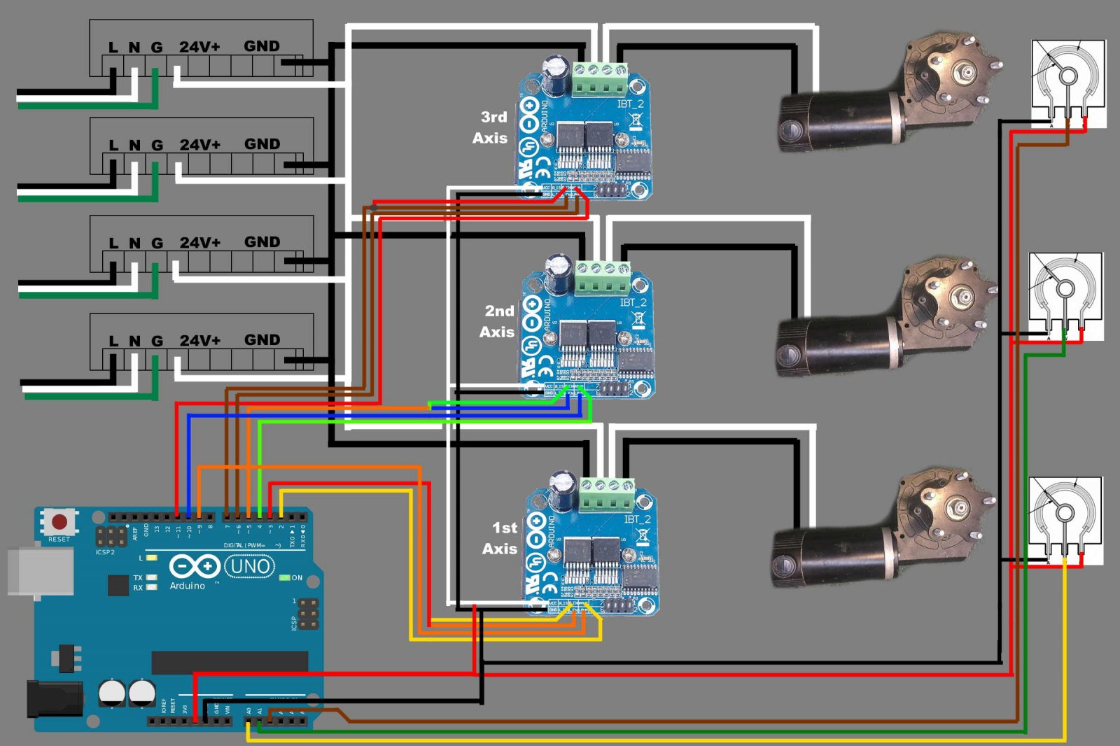

    I got also a problem
    The motor, when i connect the pot and try the "sine" in smc, it just spins and keep spinning.
    If i then take the pot in my hands og center it, if i turn it, the motor keeps spinning in that direction.
    Ive installed new pots, new ibt's - Nothing change.
    Im using the official picture for wiring and the code is changed to mode2.

    Can you please specify exactly what motors you are using and also post pictures of all of your settings.

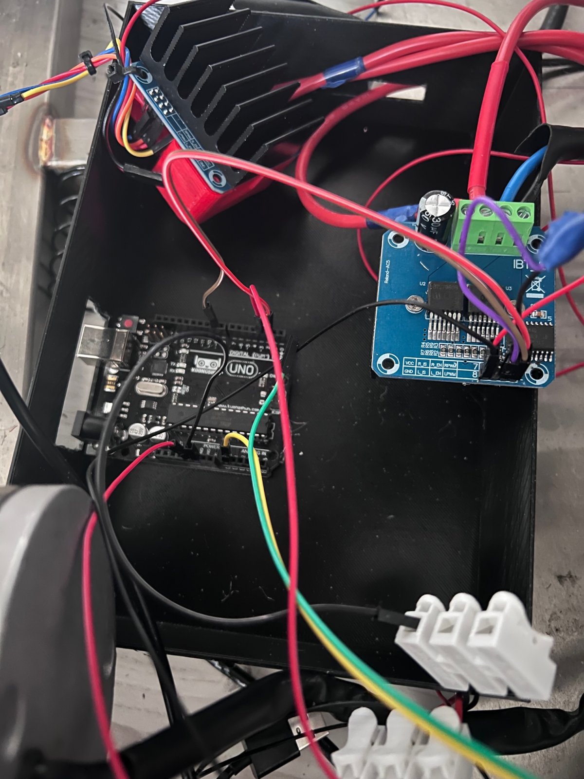

    Some 150w worm gear 12v motors
    The black and purple is going to the nr 3 pin

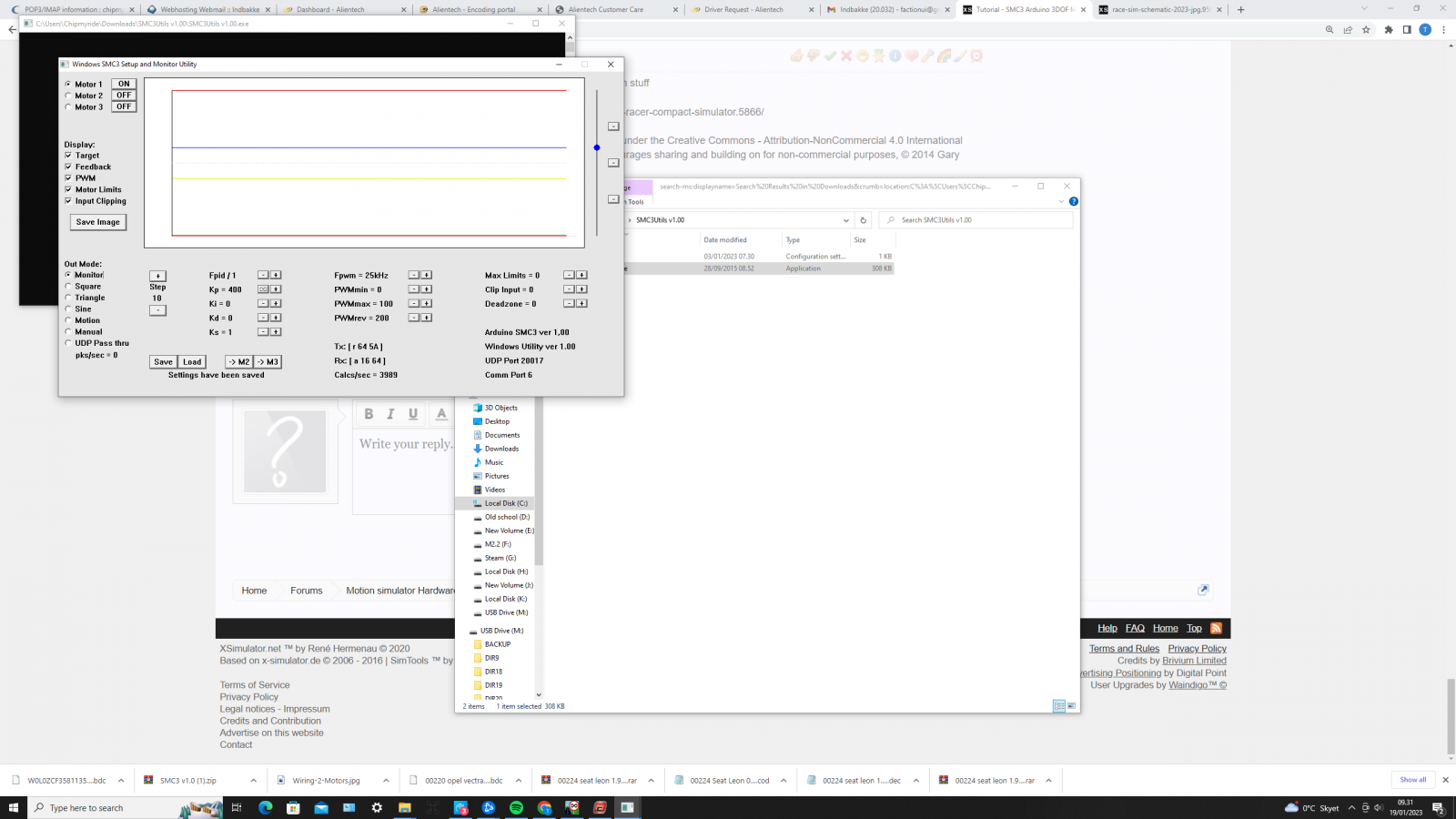

    You don't seem to have Max or Clip limits set.

    - 41Coins
    I know, but it does not change anything when i set it

    You can move the pot by hand and the movement should show on the SMC3 graph.

    I got a few 10k ohm, from diffrent brands. I got the + and - connected to the + and - from IBT and the to the UNO board 5v and gnd and then the signal to the first A on the UNO board

    So, its alive, kinda
    Why does it look like this?

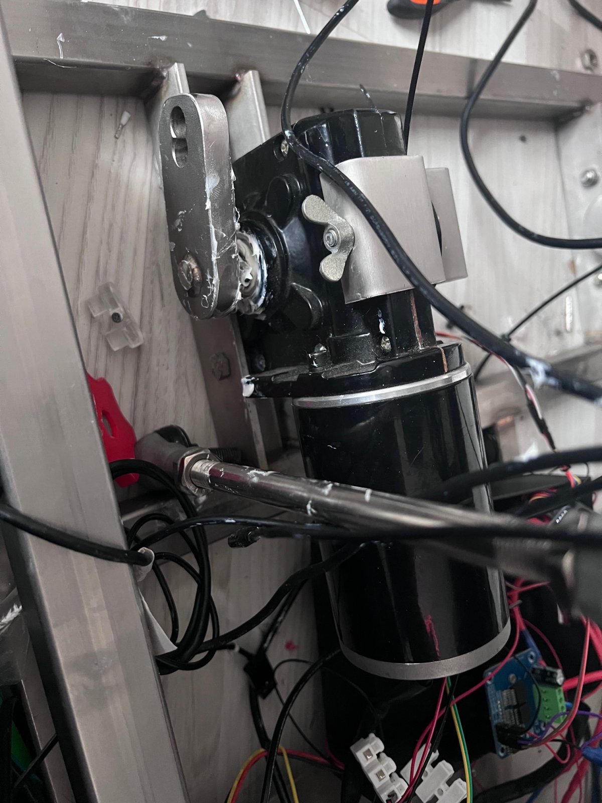

    The pots are attached and turning with the shaft now
