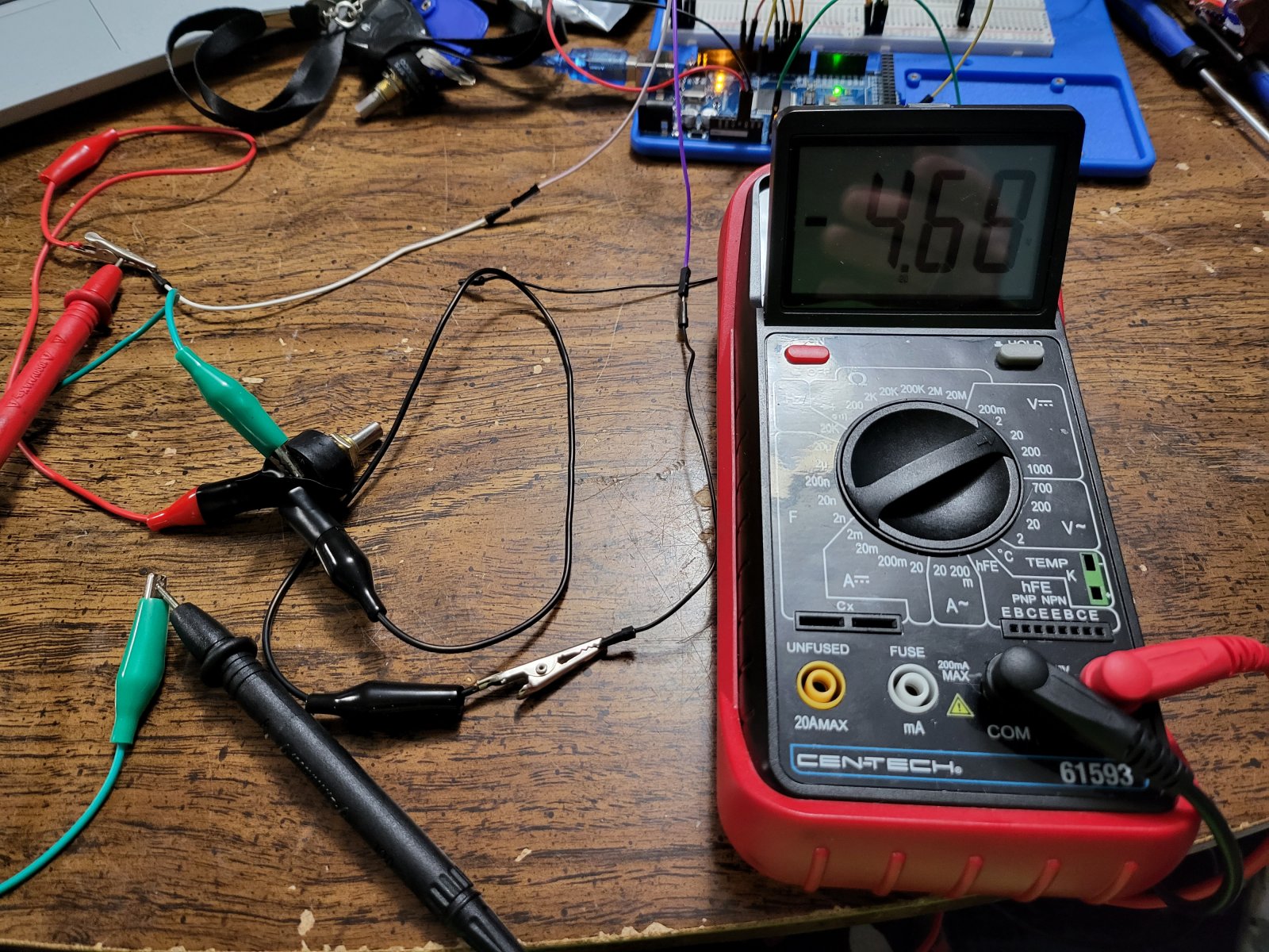

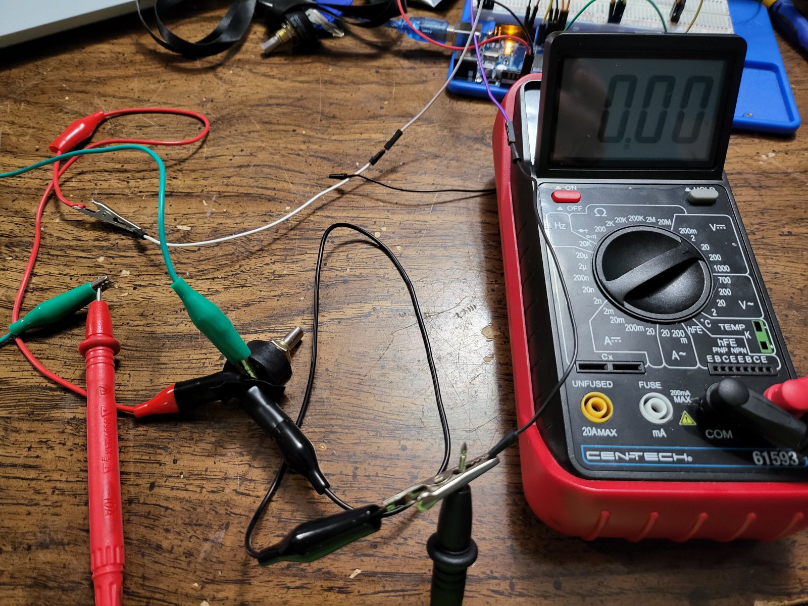

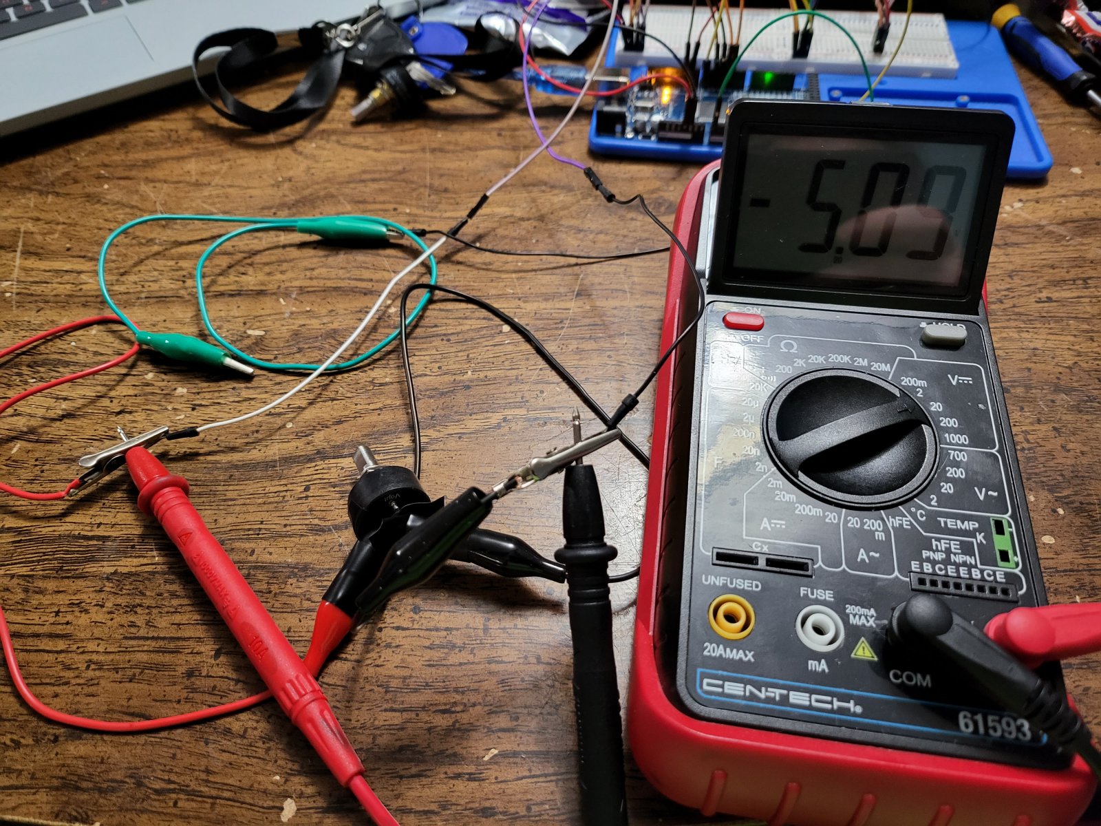

    The the other issue is that I only get 4 volts from the ground and signal and it never changes no matter which way I turn the dial. I always thought that when I turn the dial I should either get 5 volts or nothing but that just isn't the case
  2. Gadget999
    1,971
    12,035Coins
    +488 / 10 / -0
    are both pots the same ?

    Yes they are. I got an oscilloscope coming in hopes that will help me test further. I wonder if the whole issue is the Mega board since the coding was written for the uno which I have on the way also. What are your thoughts?

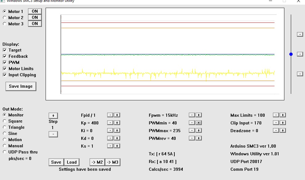

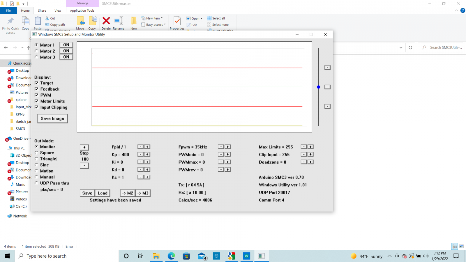

    Good evening folks, does anyone know why SMC3 wont engage my motors. The feedback line is centered and the power to the motor is on. Any help would be appreciated. I did test the motor and the bridge as well as all the connection in a different program that I wrote and they all work ok just not with the program written on here. I am sure that I am missing something here, any ideas.

    I adjusted the PWMmax to 255 and still no movement

    it would appear both your pots are dead
    can you get hold of a normal pot that is not hall sensor type to test the board
    (its not likely the mega is faulty - the smc3 code should work on an uno nano etc
    make sure you have the correct type of motor driver enabled in the sketch)

    Good evening, interestingly, I ended up using B1oK pots which are pennies on the dollar compared to these and they worked. My next issue is that the motors wont engage. If its not one thing it another you know. I have also written my own code to test the bridge and the other components and they have also came back ok.

    Is there anyone that can give me some advice please. What would be the reasoning for smc3 utilities not engaging the motor even when all the specs are within parameters.

    If you move the pots does the green line move up and down ?
  12. Tom1980
    Tom1980 The Sky Is The Limite
    Jan 1, 2022
    45
    Business Management
    Alabama, USA
    26Coins
    +7 / 0 / -0
    Yes it does.

    I have tested the hardware and everything is ok. I am in mode2 running a mega for now. I have 24 volt motors from a wheel chair.
