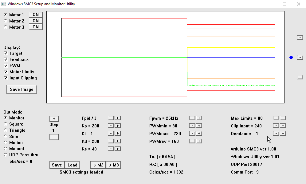

    Yes, I think so. Here's what I'm using:
    I'm totally happy with those settings - more than enough power, I have to filter things in FlyPT Mover not to be thrown out of a chair :). The motors whine a bit when fully back, but hold me and the rig fine, and have no problem moving back from that position. In other positions, or even without load they crackle a bit, but I guess it's normal. With the limited movement in VR that I need (arms have holes at 60mm from the shaft) it works just fine as far as I can tell. Since I dialed it in I make all the tweaks in FlyPT Mover as I feel no need to change anything in SMC since I dialed it in.

    Greetings guys, since I realized the 2DOF project I have always encountered the following problem, it never mattered to him but I was getting bored and decided to get into it, the problem is the following, when I open scm3utils the level seat, when I open simtools I do not know levels until I open a game, but when I open a game and close it, the seat like it lowers a bit and does not maintain the level until I open the game again and it is leveled again, another thing is that, for example before to open any program if I connect the sources the seat goes up but it doesn't level if not it always stays a little down since I don't play or open smc3utils, what could be the problem? Cheers

    Solved !!! You just have to comment the increment of the CommsTimeout variable, it would look like this:
    this -> CommsTimeout++;
    for this -> //CommsTimeout++;
    Thanks !!

    Ok so motor its running good all its is set as per directions, but motor #2 the feedback its going above the motor limits. What could be wrong or what should I do. It was running fine but suddenly it didn't work any more. Please help.

    Hi yes, my potentiometer was loose so we tight things up and everything started to work again. I'm sorry about misspelling and broken English it's no my primary language.

    Has anyone had this error like me? The motor feedback current does not run towards the blue target, but is exceeded which shuts down the motor. I have checked and rewired the wires many times, tried using my hand to turn the shaft back to the target, but when I power on the motor, it fails to overrun.

    Hi, if You use bridge driver change connection of motor for exemple : + and - change to - and +
    But only motor not a driver power suply

    That happen to me and I found out that the issue was the connection from the potentiometer to the motor. the tubing I was using was to loose.

    Make sure your potentiometer is connected properly. Some potentiometers have the variable value in the center pin, and some others on the side.

    I have solved the problem. The cause is reverse connection of 2 pins 01 and 02 of BTS7960 43A. A simple mistake, but took up quite a bit of my time.

    I follow dmax on YouTube and built my rig because of his videos. Now the only thing i did different was put my motors up front, and my motors are mirror image motors! So trying to figure out which ways need to be up and down is being a challenge but ill figure that out later as the 2 front motors work perfectly. my issue is with the 3rd motor for traction loss everything seems to be wired correctly and the motor only moves one way!!! the green line confirmed follows the blue so the pot and the motor seem to be wired correctly as it doesn't lose control all the way to one side or anything!! i know i had reflashed the arduino before when getting the front motors working correctly and forgot to set it to mode2 for the ibt controllers and they would only move one way like the 3rd motor is doing now!! any ideas???

    So to be clear, if you are using ibt controllers the SMC3 code needs to be edited for Mode 2.
    Other than that the pot and lever need to be central in the TL axis range when configuring SMC3 settings.
