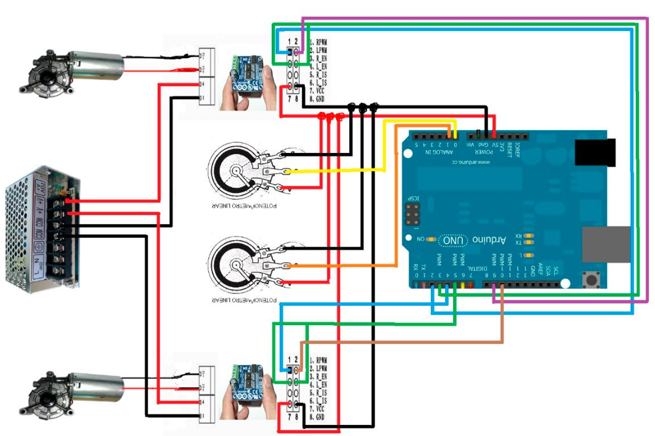

    Can someone explain-me why is the motor only folowing the inpute line (Blue) in one direction, i have cheked 100 times de conections but I cant figure it out.
    My conections are just like the ones in the foto .
    Any clue to solve it????
    22,086
    154,124Coins
    +11,170 / 57 / -2
    You need to add more context, for example I presume from the wiring, though am not certain, your are using IBT2s, and if so have you specified Mode 2 in the code?
    In other words you really need to explain fully what you have and have not done.
  3. absyfadhel1
    absyfadhel1 Active Member
    Oct 19, 2017
    347
    bahrain
    556Coins
    +37 / 0 / -0
    i got this problem before few week, the problem was the ibr-2 (-) or (+) wire not attached correctly i mean one of them not receive power from the psu check them
  4. Pierre Lalancette
    Dec 11, 2016
    1,009
    Tech Artist
    Quebec, Canada
    8,043Coins
    +945 / 6 / -0
    3DOF, DC motor, Arduino, 6DOF
    Check your potentiometers wiring, as I not all potentiometer put the variation pin in the middle. I had that problem once.

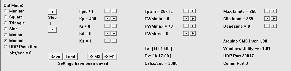

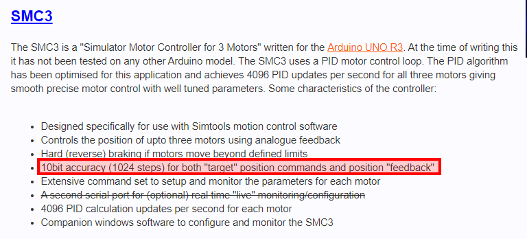

    I have a very important question for my experiments:
    I have to convert the PWM signal to analog (0-5 volts). To do this, I don't want to use the RC filter, but I prefer a ready integrated DAC. The question is simple: I read that SMC3 uses 10 bits [1024 passes] (see attached image), but in the SimTools manual I read that it uses 8 bits [255 passes] (see attached image). Should I use an 8-bit integrated DAC or a 10-bit integrated DAC?
    Thanks for your kindness and availability
