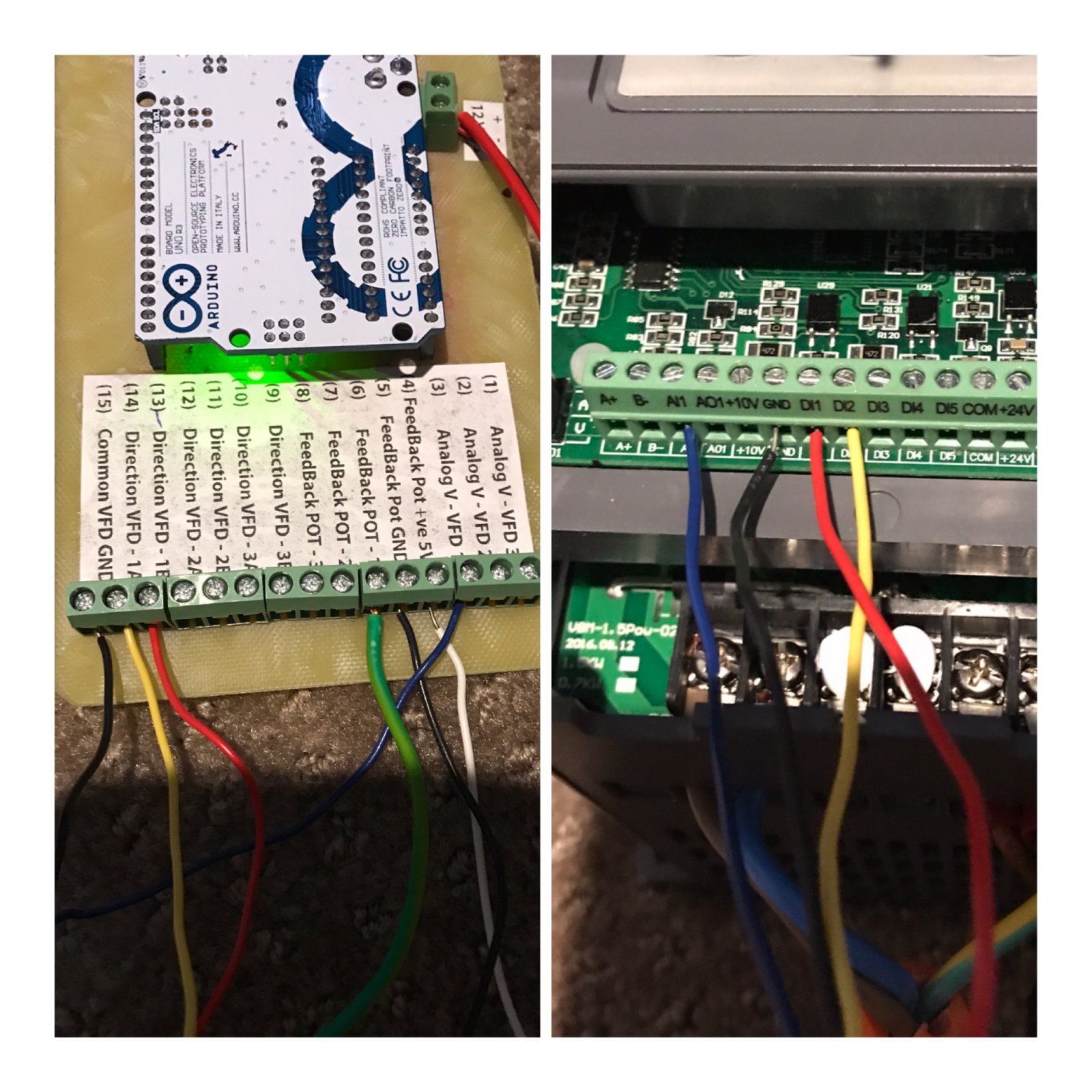

  11. F22raptom
    F22raptom Member
    Aug 31, 2017
    34
    Australia
    271Coins
    +5 / 1 / -0
    Arduino, 6DOF
    You probably have cheap vfd. Post a picture of the inputs
    Vfd direction from this PCB is irrelevant to that. A 24v output on a VFD is just typical industrial voltage. 12v is typical consumer voltage. Nothing to do with countries. Infact industrial doesn't even use Voltage for signals, instrumentation uses 4-20mA current (due to no interference). 24V is just what the equipment inside industrial control panels run off (the enclosure fans, PLC etc) so that output is for a fan or something, usually.
    • Disagree Disagree x 1
  12. lemaitre
    lemaitre Member
    Jan 10, 2015
    62
    - 111Coins
    +41 / 0 / -0
    VFD SEW EURODRIVE MOVITRAC B MC07B0008-2B1-4-00
    management works by sending 24vdc L or R
    that's why I do not understand how to connect to the AC motor card 3DOF Shield optocoupler
  13. BlazinH
    BlazinH Well-Known Member
    Oct 19, 2013
    2,145
    Oklahoma City, USA
    16,678Coins
    +1,839 / 32 / -1
    The solution is to use a vfd that work's with this boards output or use something else.

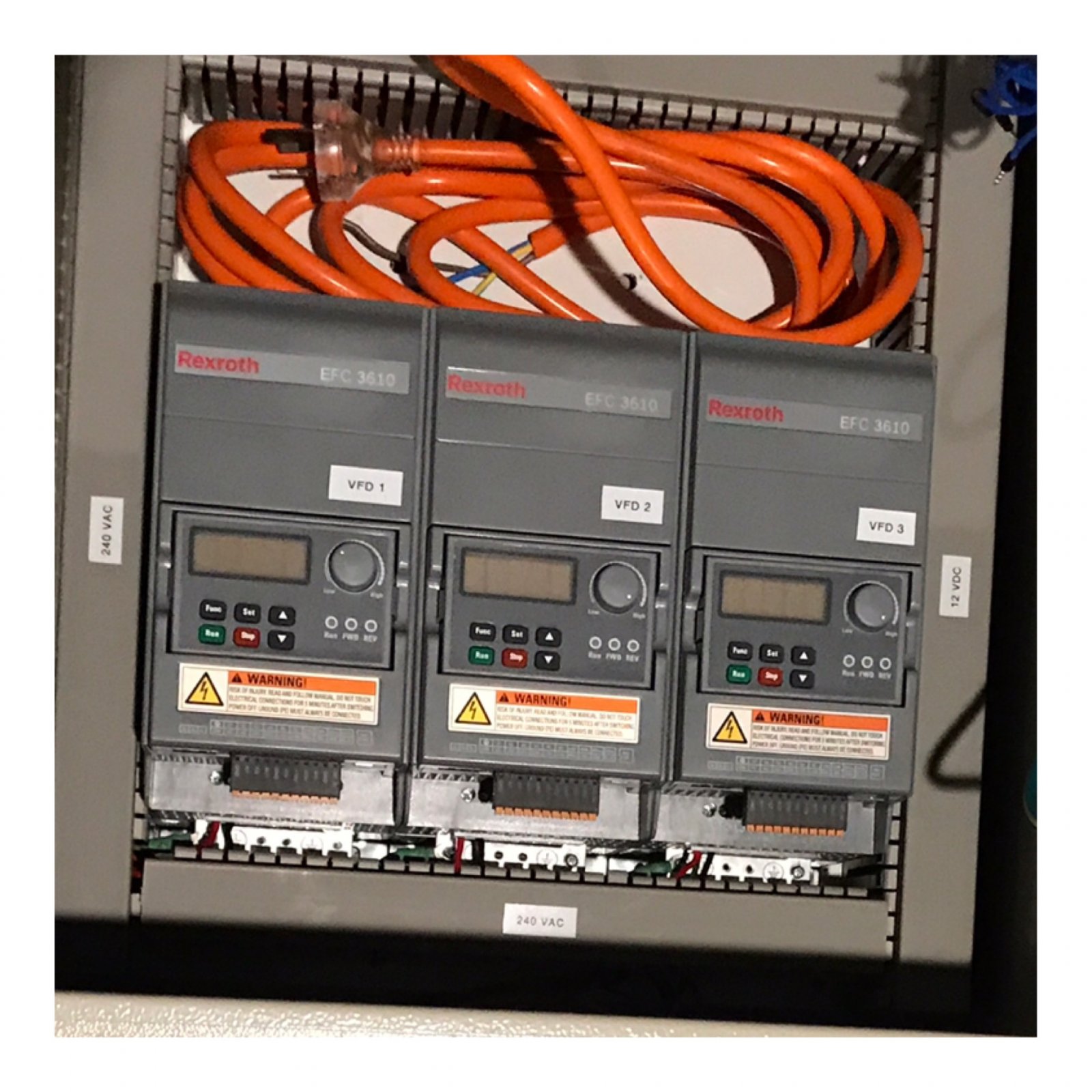

  14. F22raptom
    F22raptom Member
    Aug 31, 2017
    34
    Australia
    271Coins
    +5 / 1 / -0
    Arduino, 6DOF
    You need to use Hitachi wj-200 or something, really. Attached is something I found that worked (otherwise I am not sure why I would take a photo). Those are cheap VFD going in the bin once my Bosch Rexroth ones arrive. If you didn't spend $800 US on your vfd - they are probably crappy. You have to set D1 (on vfd) to motor FORWARD in settings.. D2 to motor REVERSE in its settings...
    Set motor parameters (50hz etc)... None of this is available online, you have to learn it and it's different with all VFD.
    This thread has got me at the top of my mechanical/mechatronics engineering class just from all the handling of low voltage wiring, VFD, micro controllers, interfacing, etching, software, hardware coupling, AC motors blah blah..
    As you can see, 24V and 10V outputs on VFD have nothing to do with this as they are auxiliary power outputs for accessories (fans, LED indicators) . The D1 input should be set to motor forward, D2 is reverse. Ground the arduino interface to the VFDs with a wire. In VFD settings, set the motor acceleration to 100% or whatever. When Simtools sends the signal to the arduino, it'll output a voltage at the wire for that VFD which will turn the motor forwards or backwards (aka the motion platform up or down) depending on which wire is being powered. The potentiometer is wired up so in testing if it's low, the motor thinks it is down and will go up - when I turn it up it'll know it's up and go down etc. That is why you can set acceleration to 100%, because it backs the motor off as it nears the target (it compares the target value to the potentiometer value to determine this).
    Again, might not be 100% but literally no one with AC motor experience has posted a guide any more detailed than what I just plastered out of my ass in regards to the wiring of this PCB to VFDs. On that note, if you are etching your own circuit board and connecting wires running consumer grade voltage and currents to industrial oriented equipment to strategically move mechanical equipment up and down based on the intimate relationship of a cheap joystick, B grade motion software and Microsoft flight simulator - but can't overcome an obstacle like connecting the coupler to the correct input on a VFD, you should really quit while you're ahead or start learning (ie. less posting on forums that are no help).
