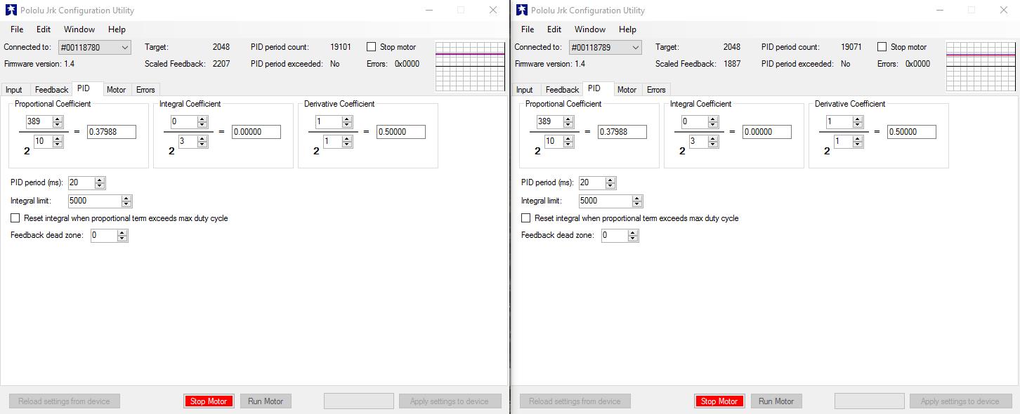

    JRK PID
    JRK Motor
    SimTools Interface

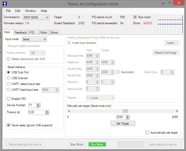

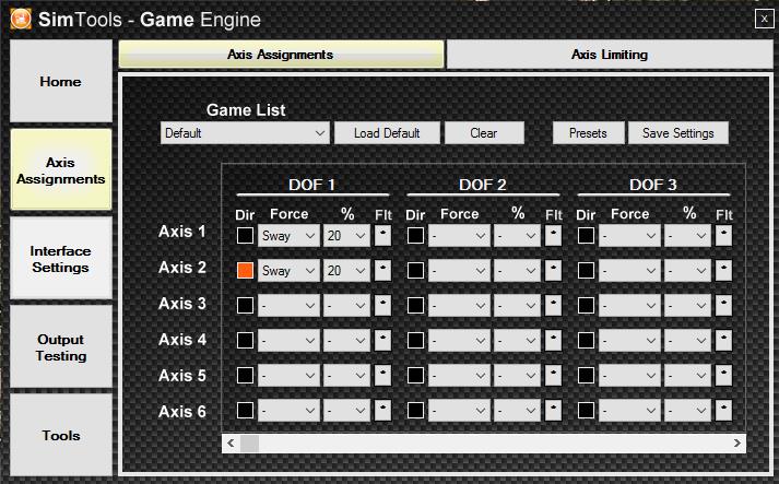

    @Goatboy, you might also post screenshots of your axis assigments and limits in Simtools.
    22,185
    154,750Coins
    +11,196 / 57 / -2

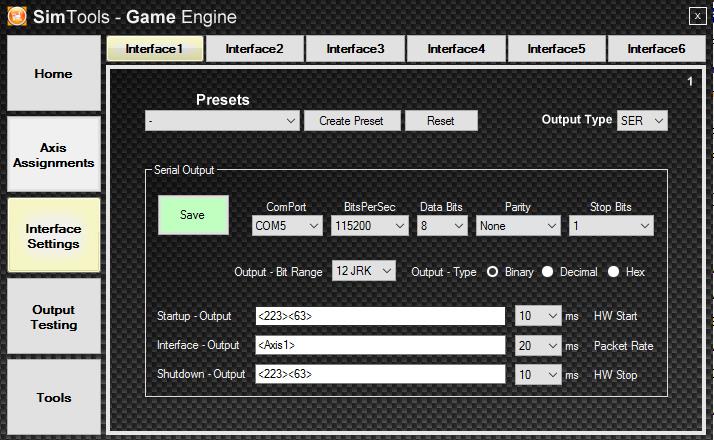

    In your Interface Settings set BitsPerSec to 9600.
    The jrk input values look messed up. Reset the jrks to their defaults and redo the setup procedure.

    I think the youtube video was clear enough (when on 1080p you should be able to read JRK settings) on axis assignment, only one DOF effect and I used each combination of directions. As for limits , the error occurs constantly throughout the whole axis range, limiting axis doesn't change that and for that reason I haven't used it.
    Baud rate @ 9600 made no difference, Also reset the JRK but either a shaft came loose and caused a lack of feedback (which is strange cos it was all solid last night) or it's turned the motor the wrong way (even after detect motor direction)... finally answer is, I'll have to replace a broken 4mm bolt I'm using as a split pin, so can't test it further. But last time a lever smashed in to the MDF is was due to it spinning the incorrect way after I plugged the controllers in to the wrong sides. Really should have turned the duty cycle right down lol

    So here is a screenshot of a basic Axis Assignment setup that reproduces the Input disconnect errors, in fact no Axis setup has not produced those errors ...

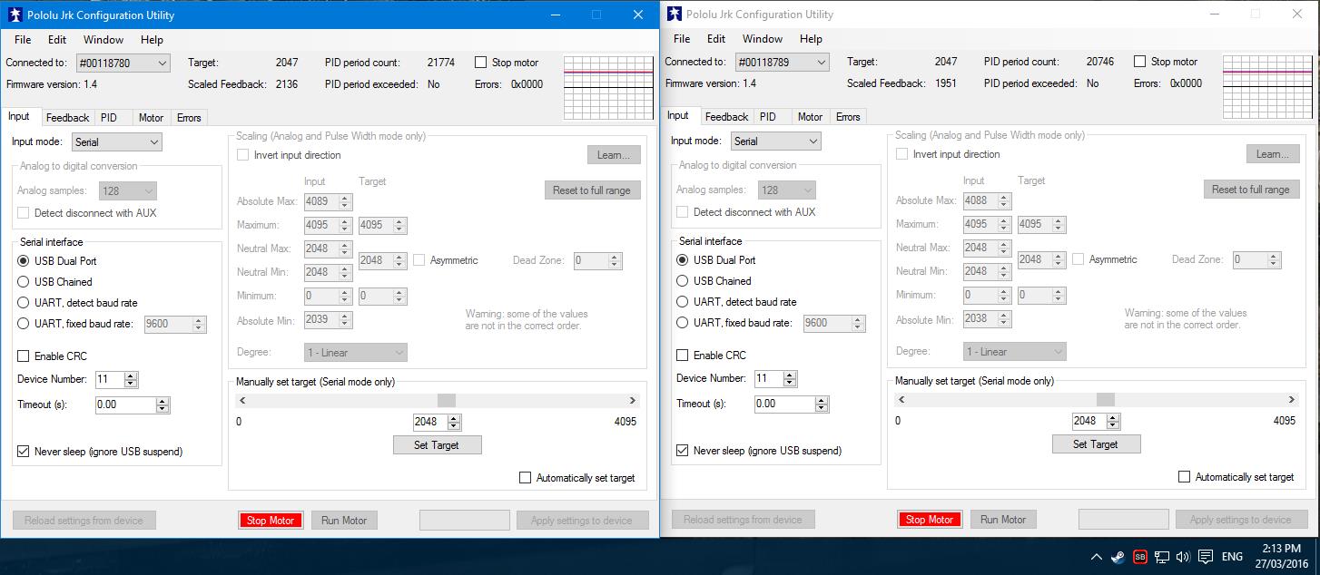

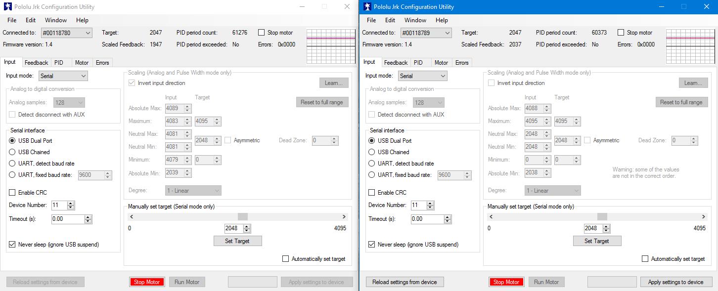

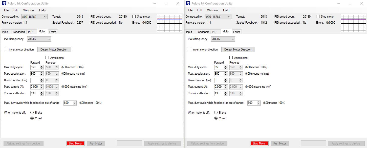

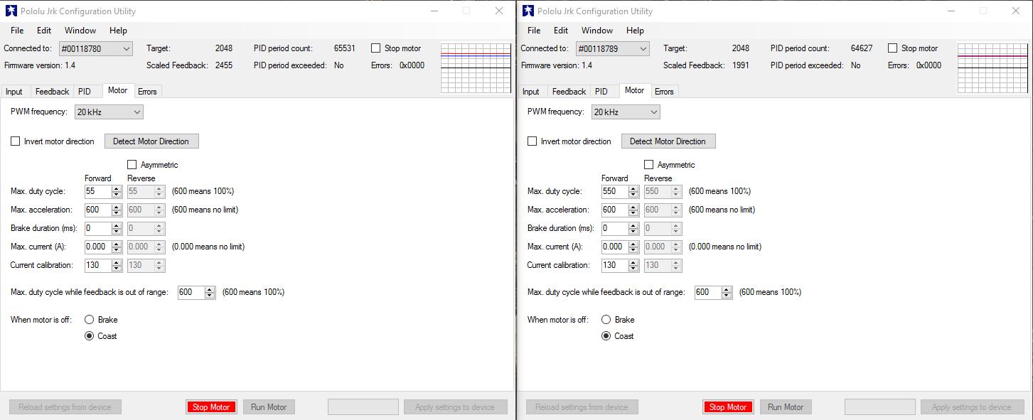

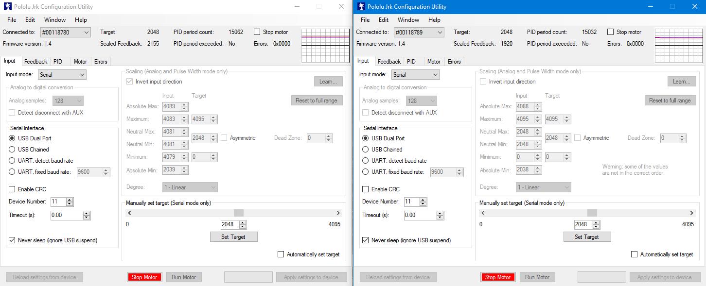

    @noorbeast Sorry, misunderstood ..lack of sleep or coffee or both. Here are the current JRK settings after a full reset , then feedback set -> motor direction detection ... PID hasn't changed. I haven't touched any of these settings, just followed the prompts to setup after resetting to default settings.
    JRK Input
    JRK Feedback
    JRK Motor
    These screenshots are oriented in the same way the motors are , controller 80 does the left motor , controller 89 does the right.

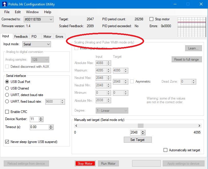

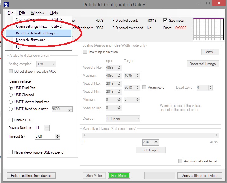

    I don't understand how you are ending up with different values in the JRK input tab, can you please confirm you reset the JRKs to the factory defaults before doing the setup again. File -> Reset to default settings..
    This is an example of how the stock values should be:
  12. Goatboy
    Goatboy Member
    Jul 4, 2014
    82
    New South Wales, Australia
    386Coins
    +43 / 2 / -0
    File --> Reset , had to start from scratch.
    I totally agree, the max/min numbers on both sides look odd to say the least. A max of 4083 and a Min of 4081 on the left and a value of zero Min on the right. I just figured seeing as though it's greyed out , it might be of no importance or more likely it's getting the information from Simtools.

    These are JRK setting and have nothing to do with SimTools.
    If it is not resetting properly to default then something is definitely wrong.
    The Input picture you just posted is the same as the earlier one and it should not be if you have reset to defaults.

    I just posted the Input tab after reset, I've only posted two Input tab photos.
    Before reset
    After reset
    Scaled feedback numbers and PID period count on the top status bar should clear that up if you look closely.

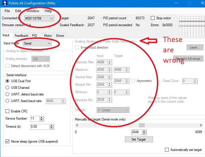

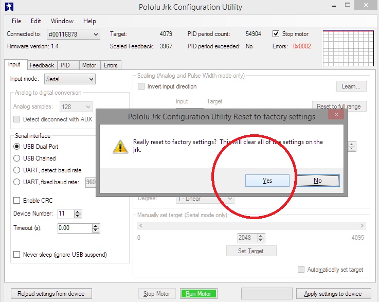

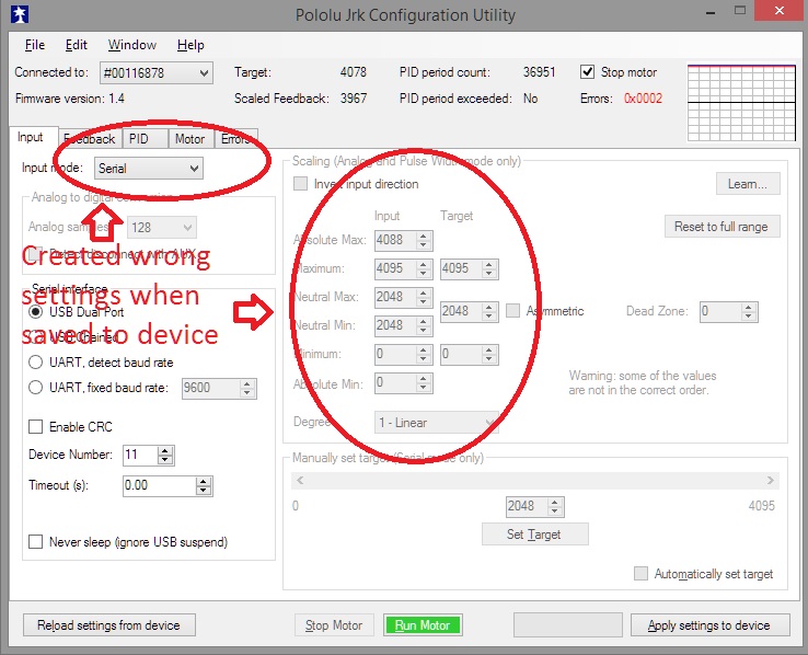

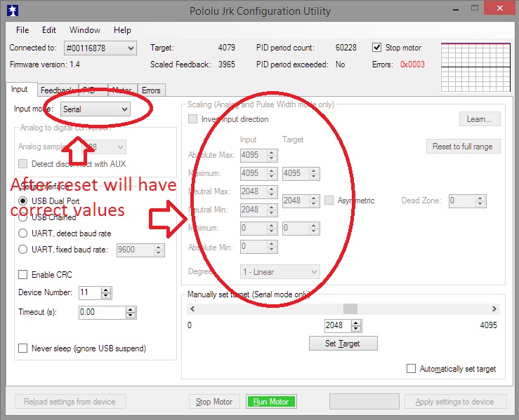

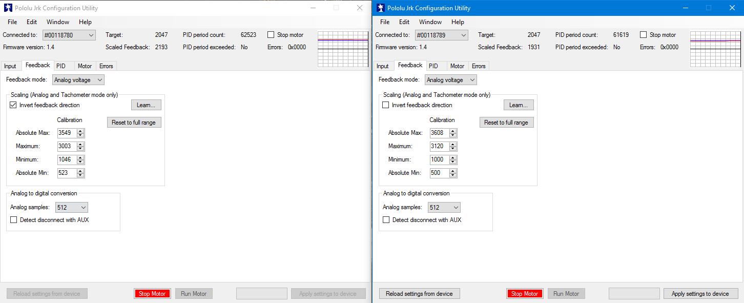

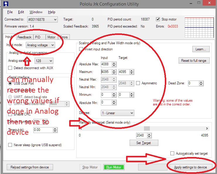

    What I am trying to say is that as far as I know the only way to have incorrect scaling values in Inputs is if you manually fiddle with values in Analog Voltage and saved the wrong settings to the device, but a proper reset will fix that.
    Turn off power to the motors and shut down SimTools then get the JRKs sorted first.
    Here is the sequence that recreates your incorrect values in scaling then shows the reset will fix it:

    No offense, but it's always been set as serial , before and after the reset I did this morning. But I will do it again after lunch and post new screenshots :cheers
    The reason I'm not giving it too much notice, is because of this line in the JRK manual; "Serial indicates that the jrk gets its target setting over a serial interface, either a virtual COM port or the TTL-level serial port of the jrk".
    Hence why I believe it's being grayed out bu default as the JRK utility has no influence over these settings whilst set in serial mode. I will reset and post screenshots to further show I have nothing to do with these settings.

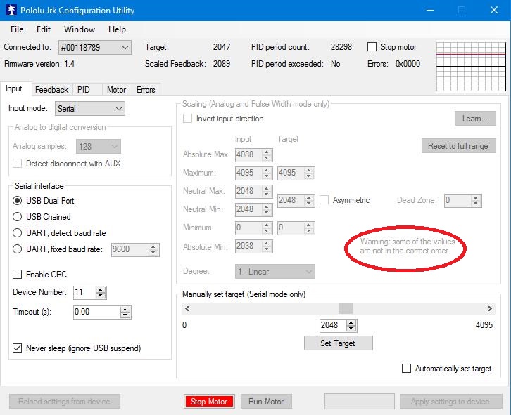

    So I just reset to default settings via the File menu , it made no difference to the Input table Min/Max numbers. But I did then select analog from the "Input mode" pull down menu, Reset to full range, Applied settings to device and now we have ..
    but we still get Input disconnect errors the same as we always did ..it made no difference. I stand by my claim that these settings have no effect whilst in serial mode and aren't relevant.

    First off I'll apologise for not taking more time to alter the numbers in the Input tab and dismissing it. When I took another look at the settings whilst in analog mode, I noticed the warning about numbers not being in the correct order was in red.. so I figured I best find out a way to make it go away cause red is bad. The first time I looked it at it today I just wanted to see if I could change the numbers, which I could, I didn't bother to set the numbers to what I thought they should have been, again being greyed out I didn't feel it had influence over the sim. But I just went back in and set them to what I thought was logical so it now looks like this ,
    And boom, no more error messages...I've reset both control boards 3 times today, but going in and manually settings the numbers was the win.
    Again thanks for your time and patience!
