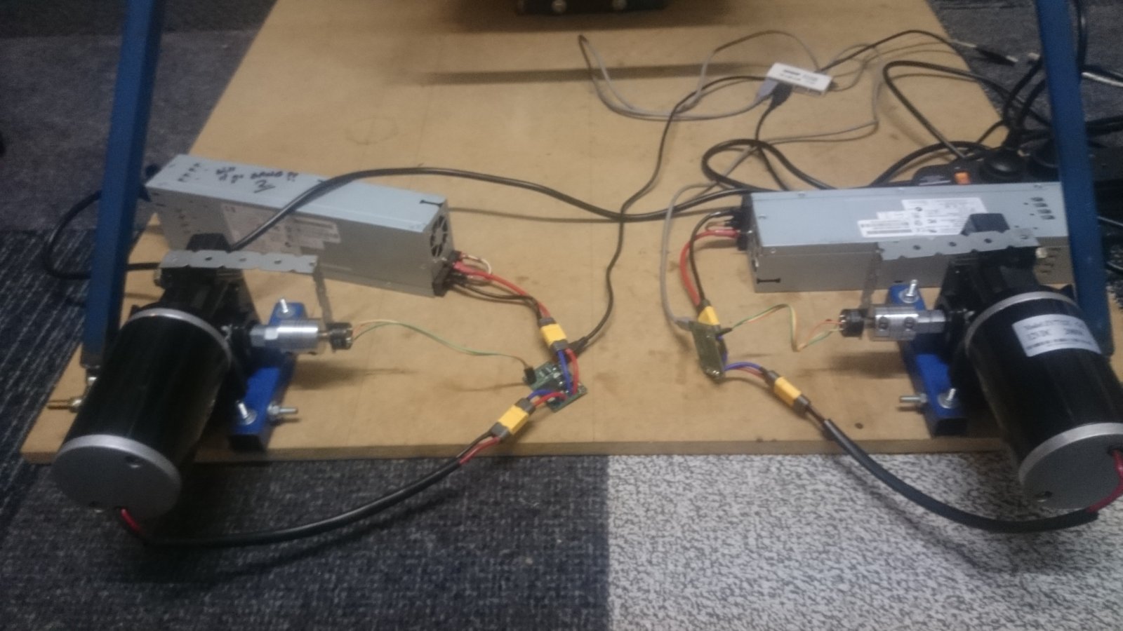

    I've got shielded usb cables , got plenty of distance between feedback and power wires and also short runs on the power wires.
    Time to swap out the power source and start there.
    Thanks for the ideas @noorbeast

    Something is seriously wrong here.....Have you tested roll ? please do so. After that, Please test a Force that does not require reversing of one motor to perform its motion. Use surge or heave.
  13. Goatboy
    Goatboy Member
    Jul 4, 2014
    82
    New South Wales, Australia
    386Coins
    +43 / 2 / -0
    Roll is the same , so is pitch and the same with surge. I noticed with the roll/surge effect both controllers report input disconnect errors whilst pulling the levers down , but not whilst pushing them up. In the second video I posted you may notice that at the 40second mark when I set both axis to reverse, this emulates roll/surge.
  14. Nick Moxley
    17,057Coins
    +2,506 / 30 / -2
    Very strange you get the errors when both are going in the same direction as well. Man im stumped, Sorry bud. Ive messaged Robbie and lets hope he can spot something in the video or setting's.

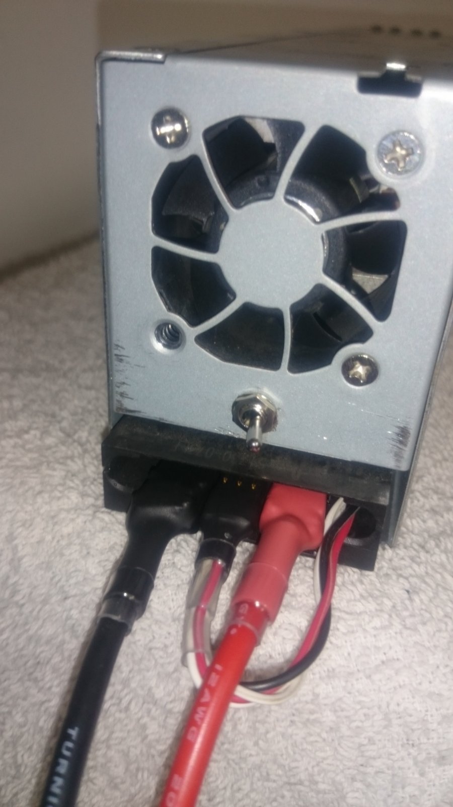

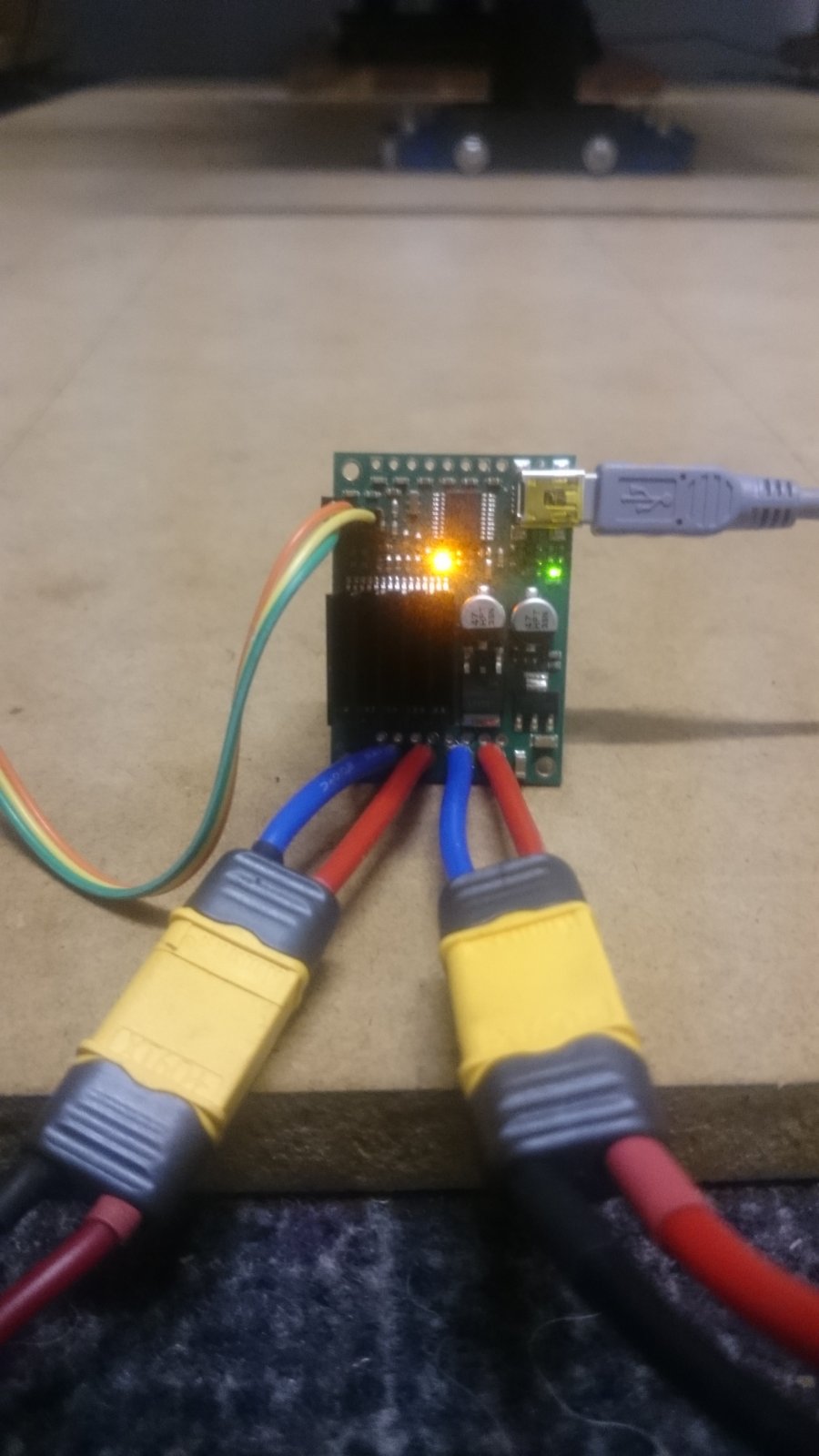

    I'm using modded HP DPS-600PB server PSU's
    Those are XT60 connectors soldered directly to the board with short runs of wire.
  18. noorbeast
    22,037
    153,818Coins
    +11,150 / 57 / -2
    My mistake, that is OK, I can see now what looked like a bridging wire is the pin connector wires.
