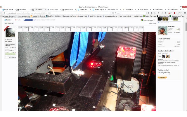

    I really enjoy the posts with lots of really detailed pictures, they are worth so much more than mere words. However on my connection Xsimulator will either not load the page at all or will not render most of the images, like this:
