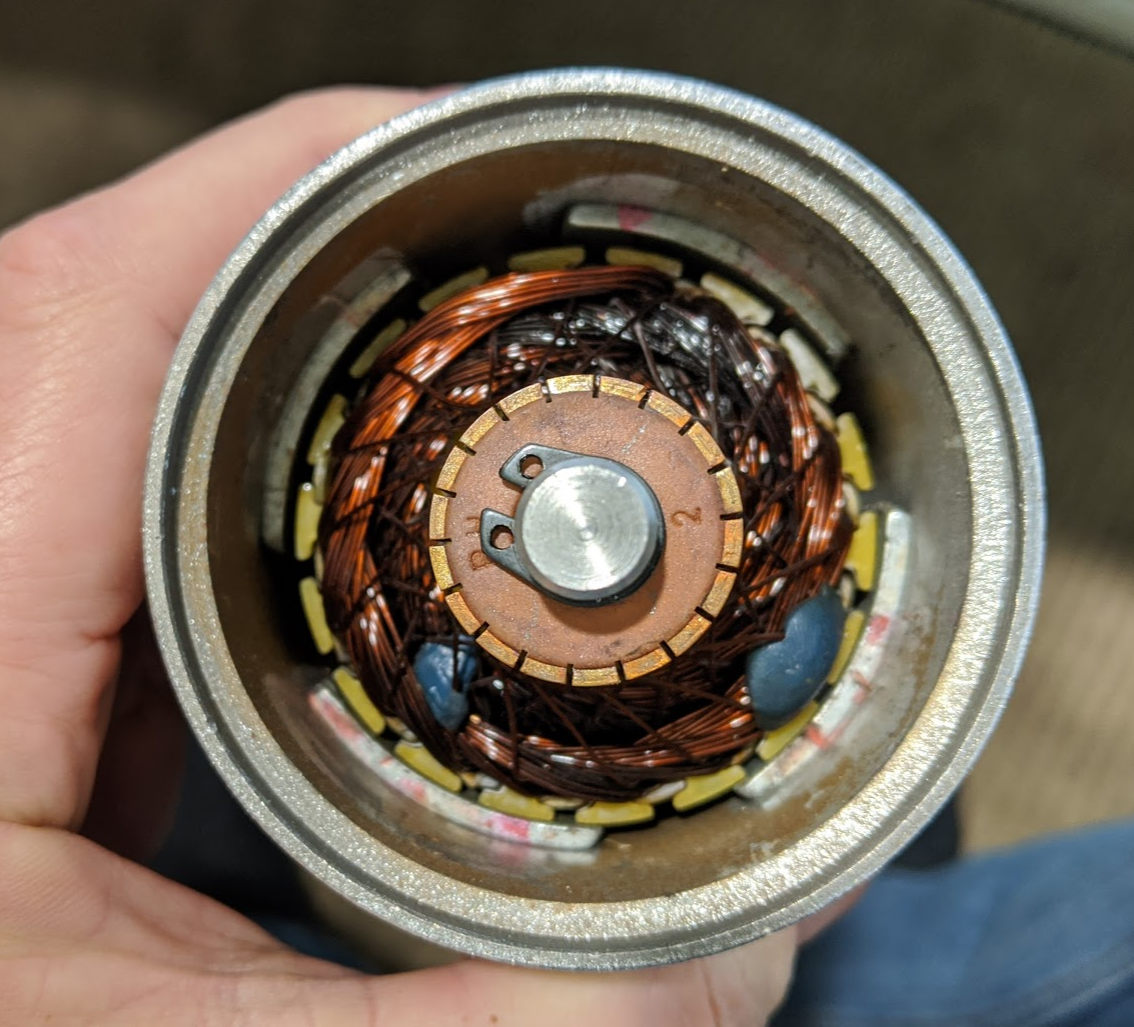

    I think the resolution of the encoders we are all using are easily sufficient and wouldnt be much of a factor in this notchiness feeling Im seeing and feeling.
    My understanding at the moment is we are observing the differences in motor construction.
    Im my case, I think using the DC brushed motor is inherantly going to give the most notchiness
    I guess the main factor is the brushed commutator and to a lessor degree, the low pole count.
    Im actually impressed these motor drivers can achieve the accuracy that they do given there are only 18 contacts on the commutator and 2 or 4 poles(Im not sure how to count what Im looking at here).
    Heres a pic of an old burnt out unit I have in my rig.
    It looks like there is a good improvement going to BLDC and then another improvement going to full AC servo motors.

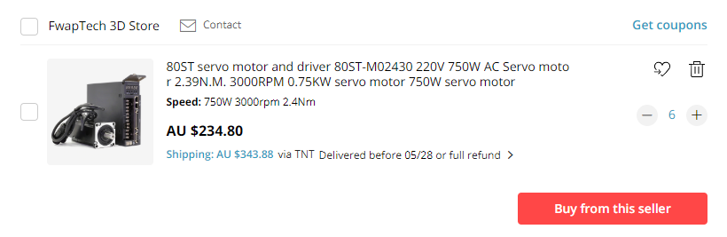

    Im now in the market for 80ST-M02430 for my next upgrade.
    The best price I can find right now on Aliexpress is AUD$302 each inc delivery + GST.
    Im in no rush so just watching the prices ready to jump on a bargain.
    Just gotta wait for some of the better prices that I saw last year. I thought it got down to AUD$250 ea back then.
    But it might be as good as it gets for the next 6 months.

    I just spotted that there was a cheaper delivery option,
    so the price is down to AU$292 ea inc delivery +GST
