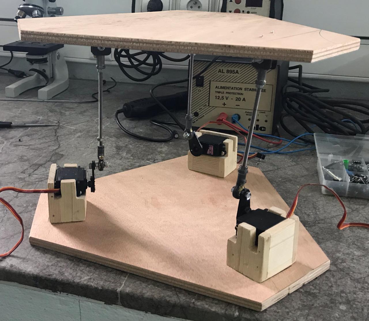

    Hello everyone,
    I would like to update you about my project. I made a 3DOF servo model based on this configuration and Arduino code. (big thanks to @eaorobbie @aarondc and @Jun)
    You can see the result on the picture below.

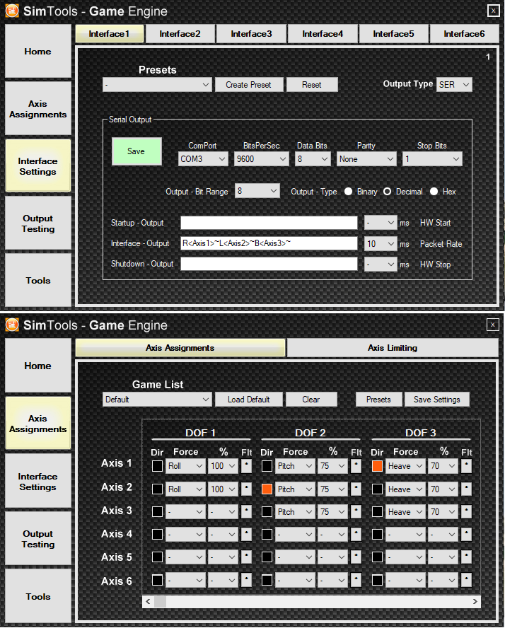

    However, I still have some problems with the servos response. They're kind of slow and doesn't start to move until I reach 30% on the simtools axis test, same thing happens when I change the direction (left/right).
    DOES SOMEONE KNOW WHY ?

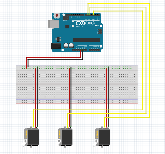

    P.S: I'm not using a power supply. The servos are directly connected to the Arduino.

    If the servo motors is 6v use a xternal power suply (look the max voltage suported of you arduino card)
