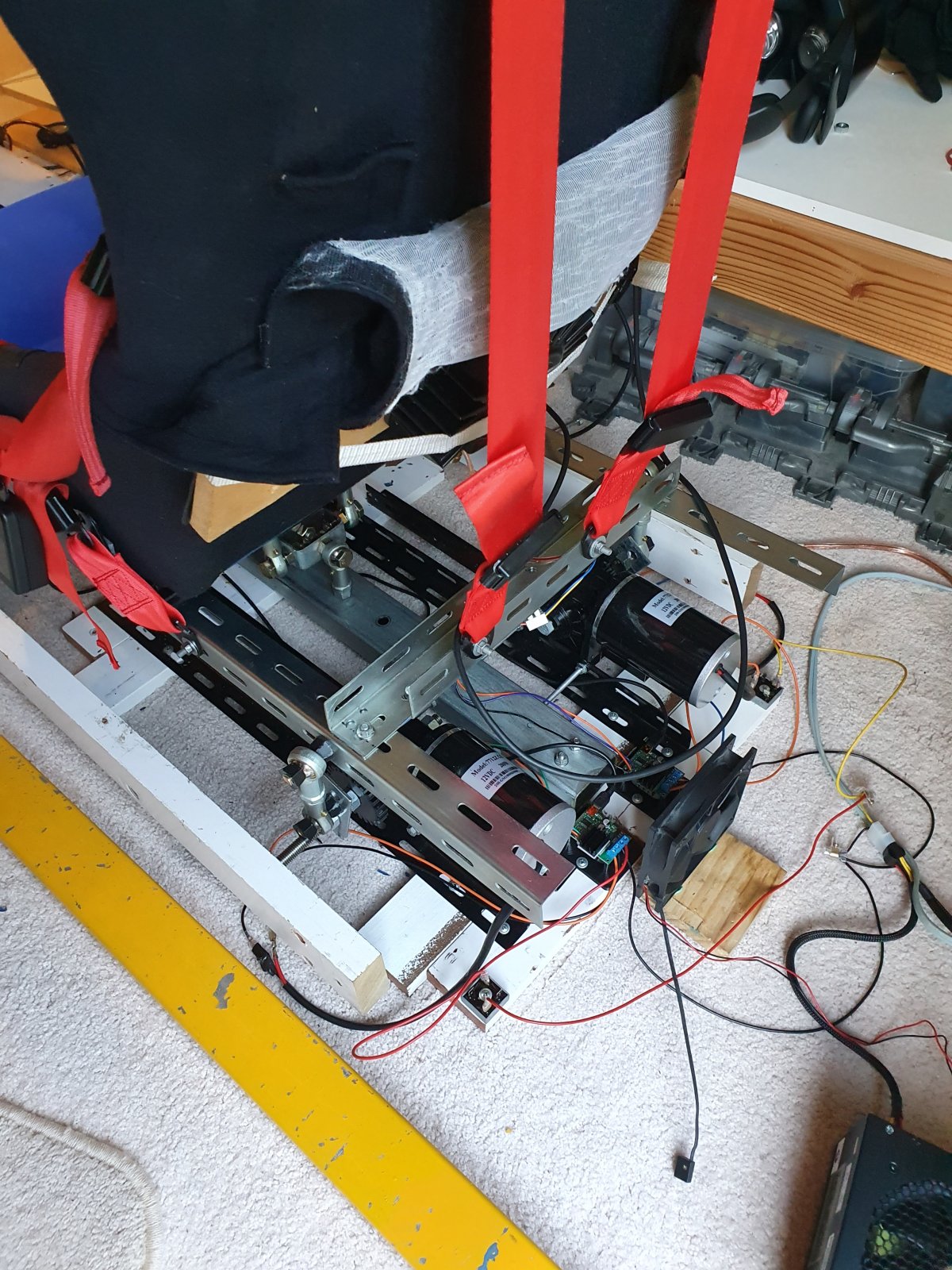

    I've just finished putting together my seat mover using 2 of the 200W Motion Dynamics motors. (20NM, 180RPM).
    The motion is quite "sloppy" due to the gearboxes being back-driveable I think. Everything is balanced over the centre of gravity.
    I'm currently using 20mm CTC levers which gives me enough speed (~300mm/s) and enough to torque to throw me around it just feels "sloppy".
    Is the only way to fix this to upgrade the gearboxes with ones that can't be back-driven?
    My current design is similar to the DOF Reality M2 with the motors mounted below the platform.

  6. SeatTime
    2,573
    I notice that you have a hand made universal joint. Maybe something to look at. When I had a seat mover, the only uni joint that I found that was suitable under load was a big beefy one from a car drive shaft- all others seem to have some slack/flex under load which cause noticeable unwanted movement.

    I think this is actually a big issue too. I've noticed it has a few degrees of play in the yaw axis. I've been trying to find a joint from a local car wrecker but no one seems to have any...
    I can buy the actual U joint from somewhere like Supercheap Auto but I don't believe I can buy the yoke arms anywhere.
    I can source a joint from a motorbike such as this:
    https://www.ebay.com.au/itm/Univers...264938?hash=item2cf11548aa:g:NBEAAOSwEOpdQYG6
    Would that be strong enough?

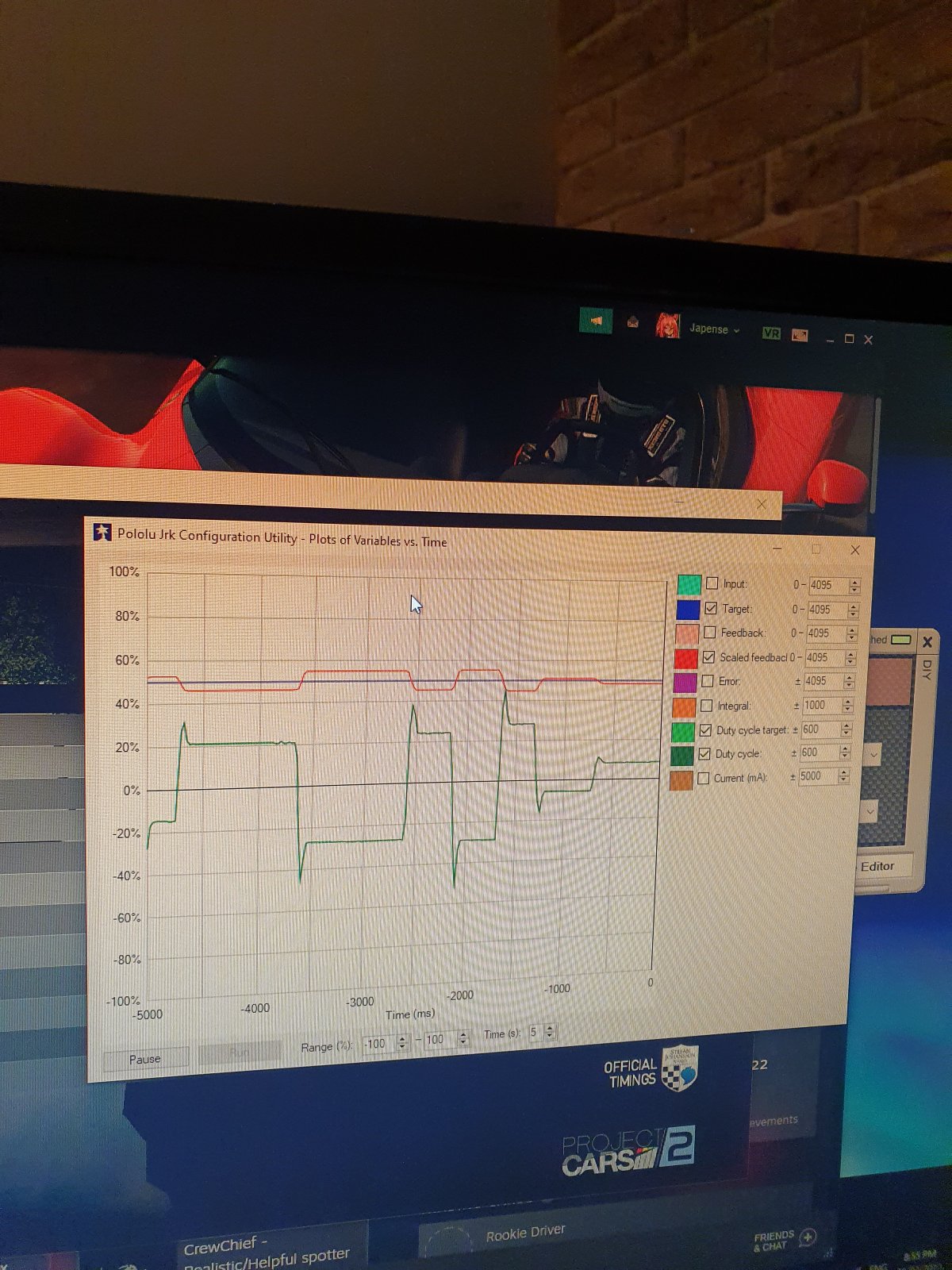

    Here's a video of the issue.
    https://1drv.ms/v/s!AjztARxhETXYgZdYZFwdedOnYOc1eg
    This is from me just shifting my weight around in the seat back and fourth.

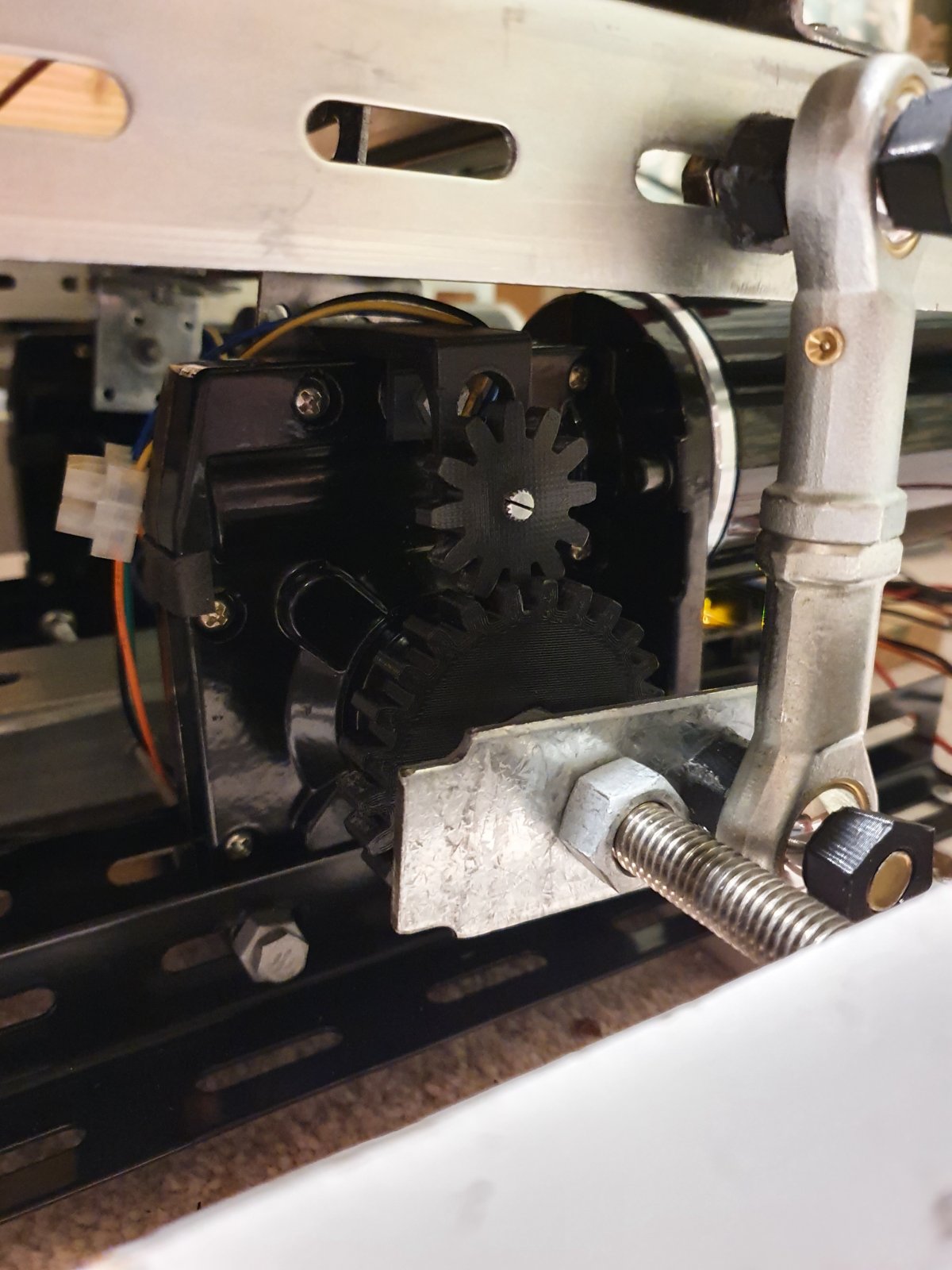

    I can actually reproduce the issue from just pushing on the CTC lever with my thumb, I feel like this is WAY below what these motors should be able to hold?
    https://1drv.ms/f/s!AjztARxhETXYgZdclUgTF_PE05Bycg
    This is my pot setup, the gears have no play between them, roughly 2:1 ratio.
    Here's a photo of the variables plot while I push and pull the lever. Am I reading it correctly that my PWM is only reaching 40% peak? Why is it not hitting 100% when displaced?
    PID settings are: 0.8, 0.001, 1.0
    All the motor settings in the JRK config are set to 100% or no limit

    I also once used the Motion Dynamics 25:1 motors, and as far as I remember I was not able to move the levers by hand when the motors were under power.
    The fact that you are able to do this so easily is not good.
    What is the spec of your power supply? Can it be that it is too weak for the motors?

    I'm using a 650W power supply, I don't think current is the issues as it can supply 54A on the 12V rail and it doesn't trip.
    I think I've found the issues though!
    My PID period was set to 25ms to account for a high analog sampling value which was pretty stupid for real-time control in hindsight...
    I turned that down to 2ms and I'm now using a sampling value of 64, effectively going from 4hz control to 50hz control... This made a huge impact in the responsiveness.
    The other issue is the potentiometers I'm using. They're terrible and have a pretty big deadzone, they don't even detect the play in the gearboxes.
