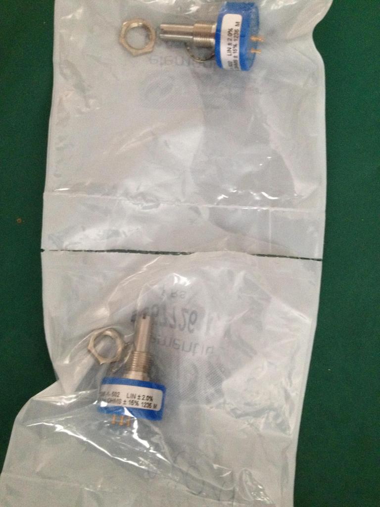

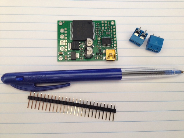

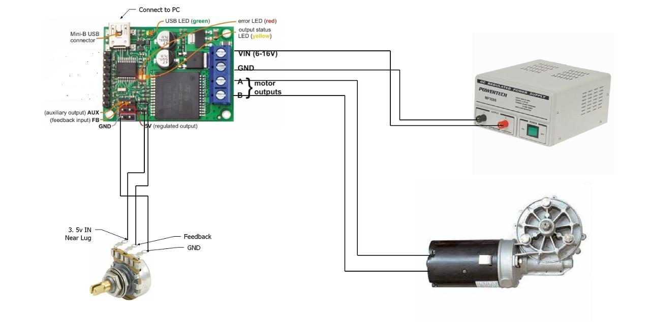

    I heard a number of people say the JRK's are smaller than they expected but none of the photos really showed them... they arrived today and they are small!
  3. bsft
    yep, they small suckers but powerful, put a heatsink on the big chip keeping it away from the capacitors

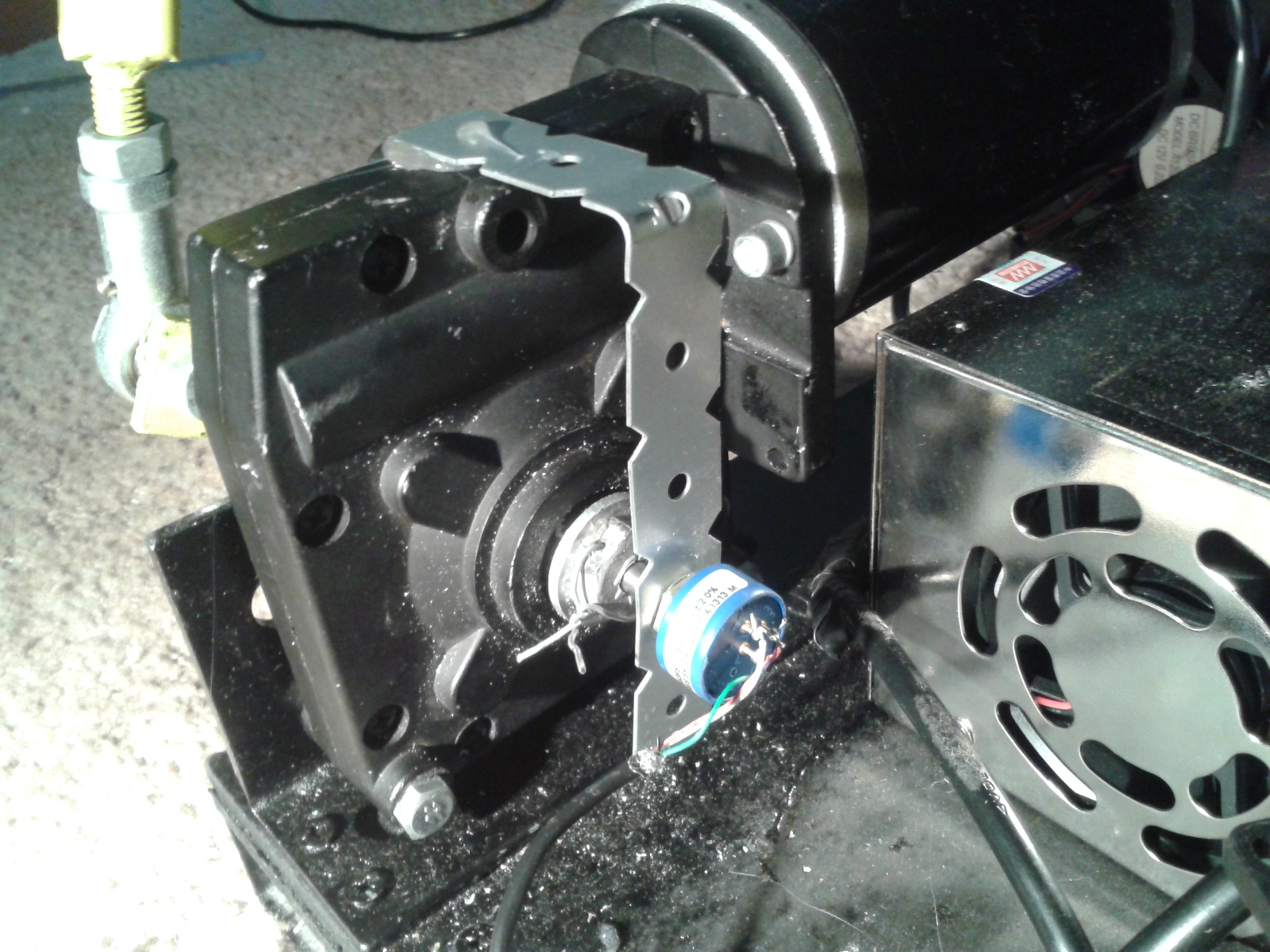

    set pots on the back of the motor shaft something like this

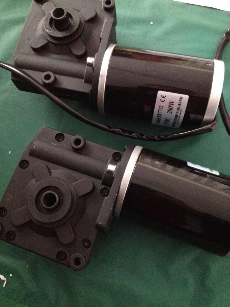

    Look´s Cool looking forward to follow your project. A little envious on your motors.

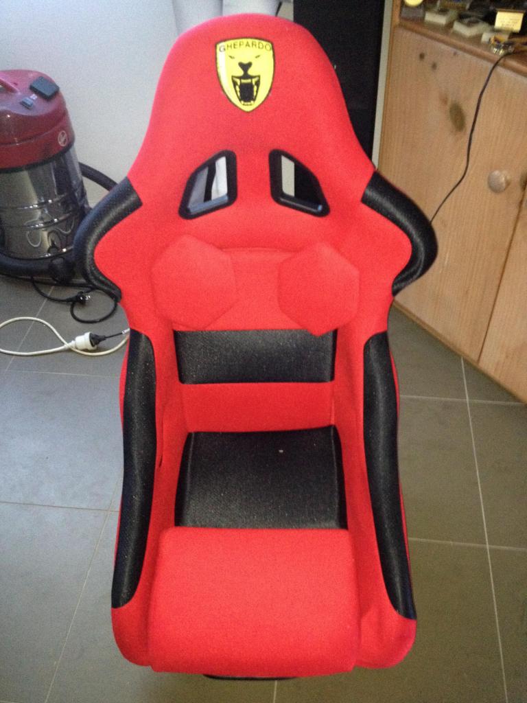

    2DOF, JRK
    Red ones go faster.
  16. noorbeast
    21,592
    151,215Coins
    Of course they do...that is why I own a red Supra ;)
