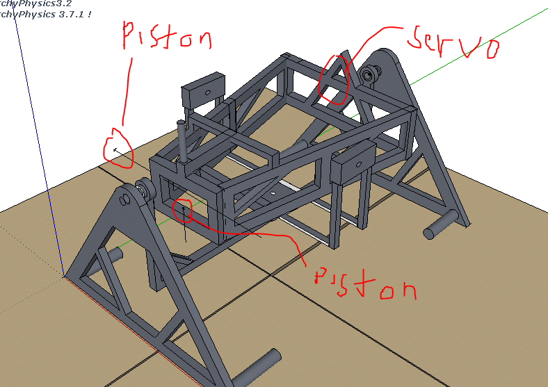

    noorbeast..yes i follow that step...truly same but not working like your model...i m very hope you can help me..i m fear right now..next week i will show that simulator to my proffessor..i hope noorbeast and speedy can help me..

    Can you please post the your current sketchup model so we can have a look at it.

    i give two file..one capture from picture and one for testing.. @noorbeast

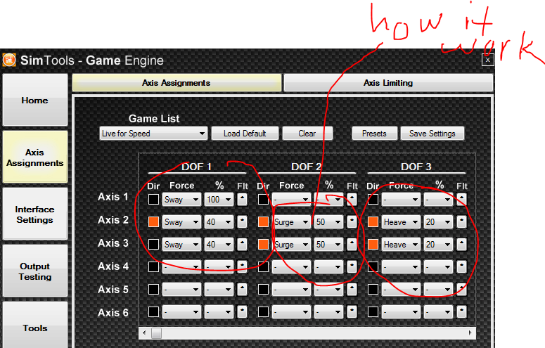

    i have done but still not working #noorbeast... if done this work..i will write this thesis for my final year project and i want to attach your name at my thesis..a lot of work you help me...just a few work i wanna do..i cannot make it move syncronize to the game..it is stay statics..

    It does work, these are the steps.
    Start SimTools Game Engine and Game Manager.
    Open the file I attached in Sketchup 2016 I set up for you.
    Start SketchyPhysics.
    In Game Engine settings go to the Output Testing and hit the Turn On button.
    If SimTools is still configured the way I set it up via TeamViewer then the sway, surge and heave sliders are connected to the model and it will move.
    You will need to properly reconfigure the Axis Assignments to suit your model, as I configured them for the default tutorial model.

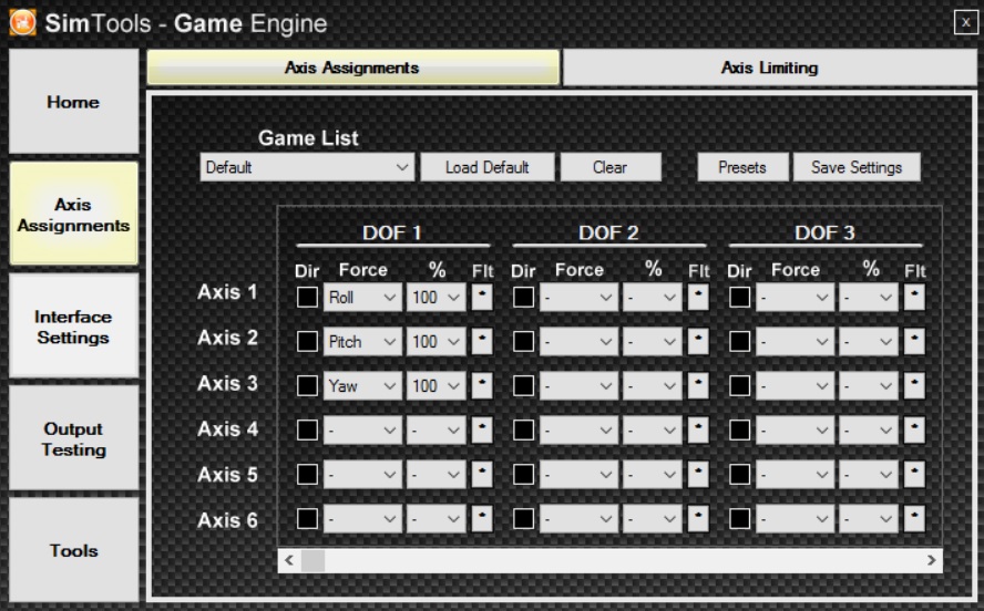

    oooooo....but how can i know that properly axis assignments for my model? how can i setup it?can i used roll, yaw and pitch?but how?
    22,228
    154,837Coins
    +11,227 / 57 / -2
    The official SimTools documentation is here: http://www.xsimulator.net/simtools-game-engine/
    Here is the basic steps to creating a motion profile, but I doubt you need to be that precise with your model: http://www.xsimulator.net/community/faq/steps-to-create-a-motion-profile.228/
    Your model is pretty simple as each axis does just one force, roll, yaw and pitch, so you can just allocate 100% to each of those like the attached.
    If it turns the wrong way you check the Dir box so it is orange and that will reverse the axis direction.
    By the looks of it you need to fix the roll axis in your model, as it is only rolling one way at the moment.
