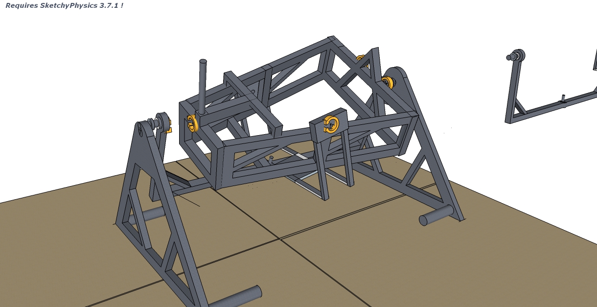

    This model does load but is not working by default. I am at a conference today so won't be able to look at it further until at least tomorrow.

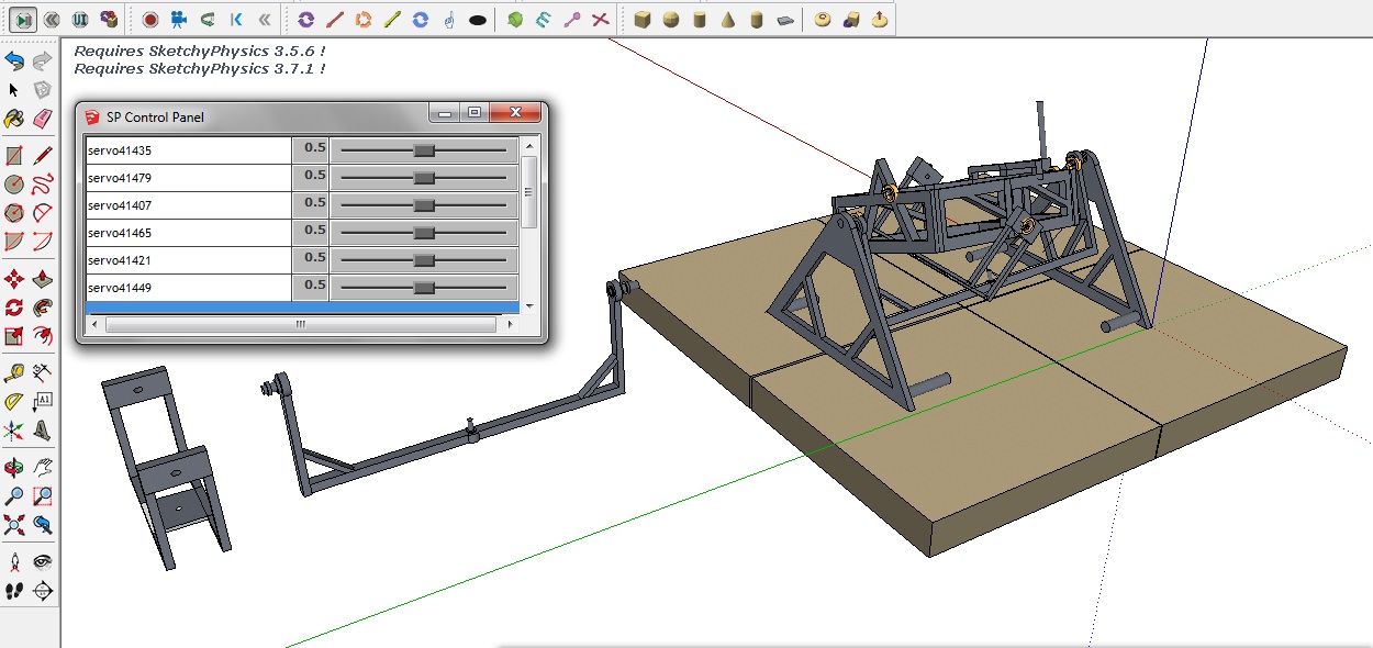

    OK ...

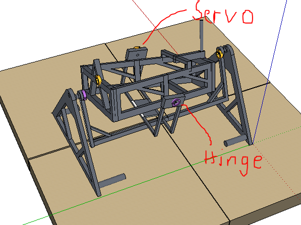

    now I see you used two servo motors for the same part which makes them work against each other ...
    It is recommended to use ONE servo in one end and a hing on the other end ... so you'll get three sliders in Physics mode for the 3-DOF cockpit ... test and then go rename the corresponding servo to the related SimTools Axis "$axisX" and connect to SimTools .
    Export a 2D Graphics picture results or use printscreen and upload it here so we can keep track with you .

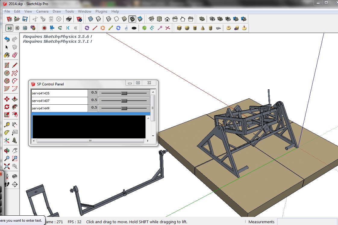

    do you mean like that? and what the next problem is about connect to simtool..why it is not function?or maybe i have missing other information or file to attach at sketchup or so on?i dont know..

    Yes @Malik10 like that for each separate grouped part ... you have a very strange structure I don't get what you're intending to do from the first look ...
    How many axis do you have here ?
    For renaming the axis and connecting to SimTools read the tutorial again to understand it ... it is vey clear and strait through .

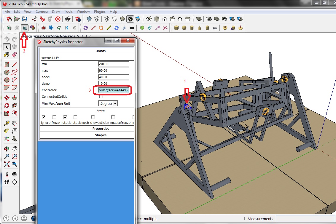

    Post edited with more details :
    @Malik10 ...
    when you're done with the design and the three servo motors + hinges ...
    1- In physics simulation play you should find only three sliders to test your design manually ... like this photo
    2- rename each servo motor controller like these 1>2>3 steps .... [1-select the servo ,2- click UI ,3- write the axis name ]
    into [$axis1] OR [$axis2] OR [$axis3] as you like to be ... related to the axis usage in SimTools ...
    3-repeat step 2 for the other two servo motors ... only write the axis name without brackets .

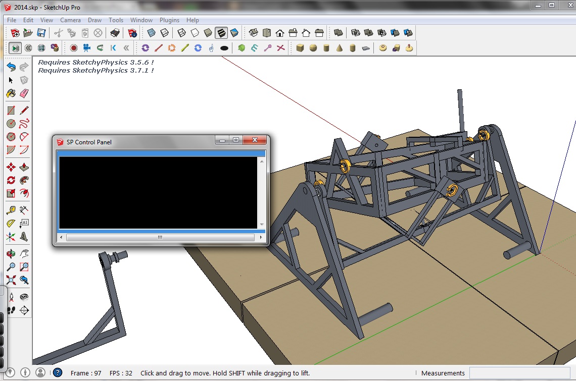

    4- In physics simulation play you should find a black screen like this ... without sliders .
    5- now Run SimTools start the game ...
