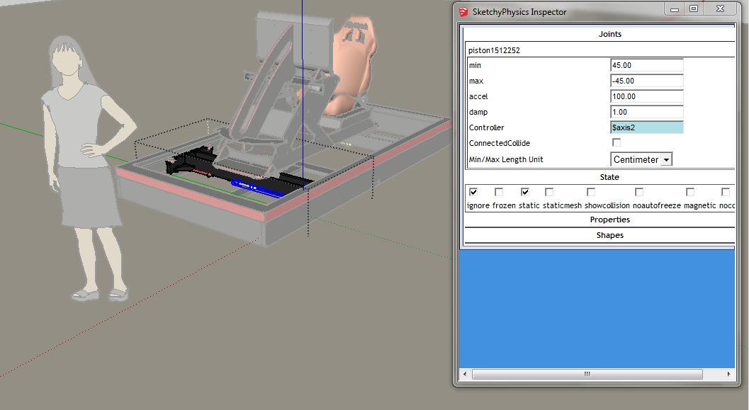

    +1,289 / 10 / -0
    because of the nature of hinges or sliders that doesn't give a moving force to the model by itself ... so SimTools won't be able to move it ... just use the servo or pistons and you'll find the text box that can be renamed to "$axisX" .

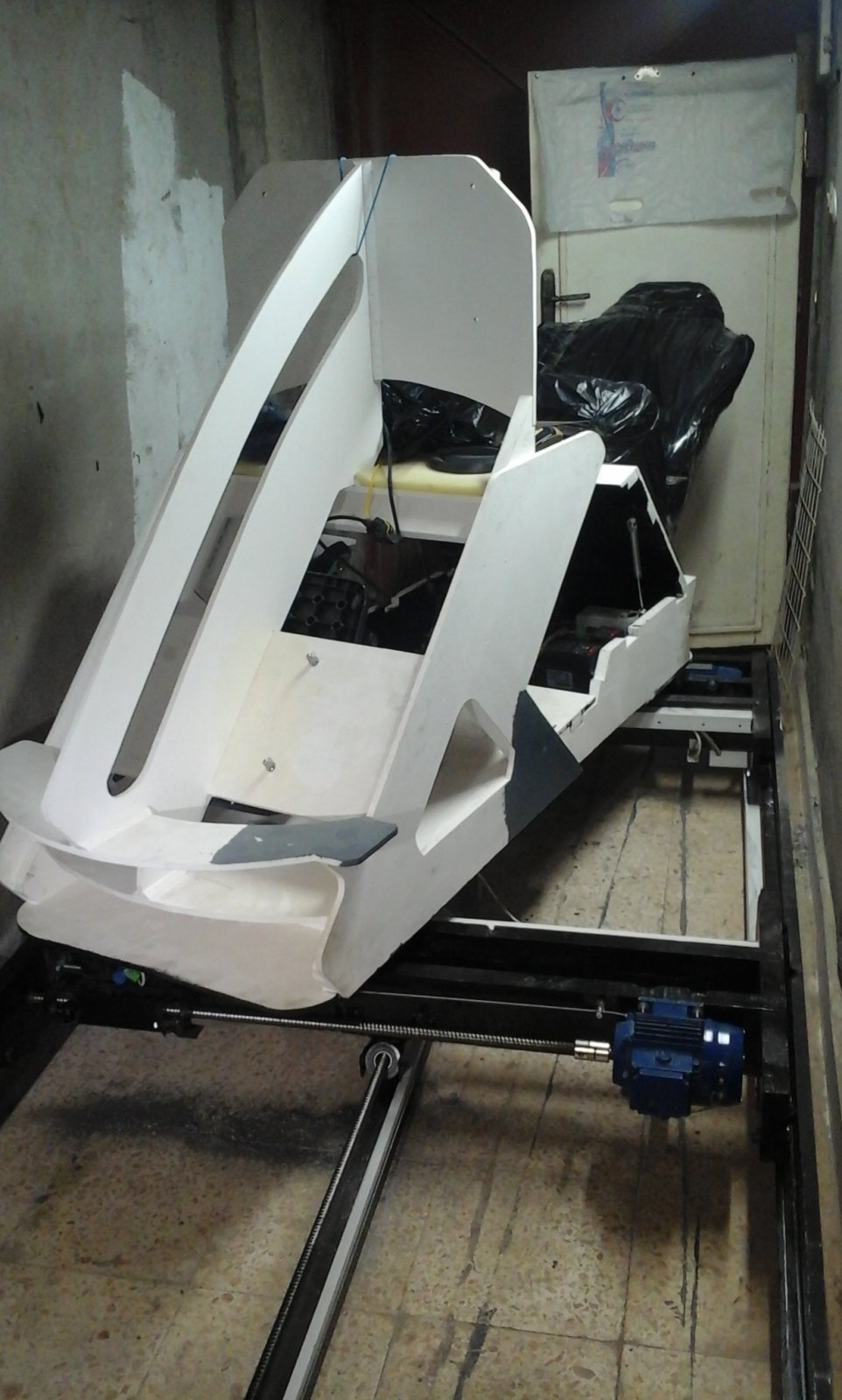

    +1,289 / 10 / -0
    a teasing view of the Drifting simulator work done so far :p ... sorry for not much space to get a better landscape picture ...
    20160404_234933.jpg Physics ASP base full structure1.jpg Physics ASP base full structure2.jpg
