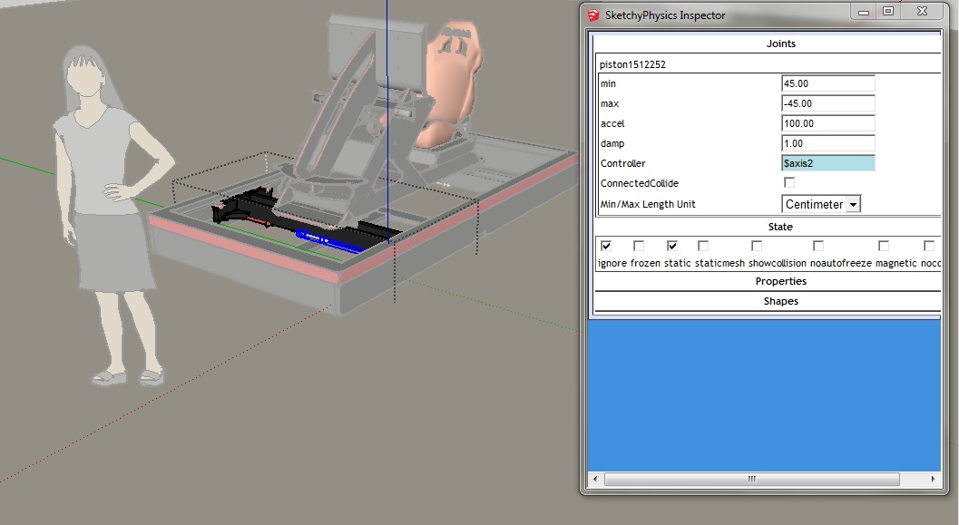

    I need some help guys with SimTools and Sketchup .
    I have done all required steps in the tutorial guide hocking SimTools with Sketchup on the same computer ... plus what @noorbeast , @SilentChill and @SteVoortwis have suggested so far ...
    I've found that file locations are the same for Sketchup 2014 and 2015 in my Win7 32Bit OS .
    But .... I still have one little problem ... which is I get about 60 seconds time Shift in the data received and simulated than the actual game ... I don't get the actual ingame movements in the real time ...
    The LFS race starts and my model stand still for about 60 seconds or less then it starts to move ... the race ends and the model still give me movements for the same period ... during the game race I can stop and resume simulation movements in Sketchup but they are not matching the car .
    SimTools virtual Axis + LFS game output are synchronized and OK ...
    SimTools Axis testing + Sketchup have that time delay ...
    That is really annoying and can't keep tracking of the real motion action .
    Is that a network related issue or something ?
    Thanks in advance .

    Something to to with the packet rate ? Thats the only thing I can think of that may slow it down although I dunno . I didnt try it with a game I just used the Axis testing.
    Sorry cant be of more help
    21,581
    151,100Coins
    @SilentChill is correct, mine lagged with the packet rate at 10ms, bumping it up to 20ms and the SketchUp model running on my laptop is super responsive with LFS.

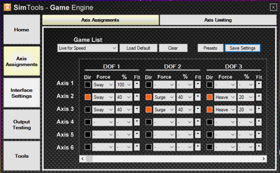

    Just to test stuff out I have attached my interface and Axis Allocation settings, as well as the basic SketchUp motion model.

    I guess the issue is the data seems to be accumulating somewhere in the computer's memory then it is sent to the Sketchup when it is available no matter the packet rate .
    What I mean furthermore ... I can stop and close everything the game , Simtools and sketchup ... then opens only my sketchup model and start simulation then it moves alone :confused: without Simtools for about a minute ...
    So where this comes from ? ...

    I just had a quick look at your model and it seems to me that you have not defined the axis names for the physics joints.
    The physics joint name should be declared to correspond to the axis that drives it, like this for each relevant axis joint "$axis1" "$axis2" "$axis3". Yours are declare like this: hinge1542520.
    21,581
    151,100Coins
    I just tried renaming a couple of joints and the model does lag badly. It is very late here so I will have a better look at your model tomorrow and try and figure out what is up with it, as I believe that is where the issue is and not with SimTools.

    Thanks @noorbeast for your support ... you gave me another life knowing that it is lagging with you too ... and yes @value1 model is working but with much less time lag in Skp 2014 ... and I did named the pistons see the picture ... as far as I understand ... Hinges or sliders shouldn't be renamed for $axisX ... only the servo , piston and motor that is responsible for giving motion ...
    21,581
    151,100Coins
    Try declaring the axis in quotes like this "$axis1"

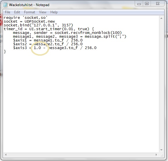

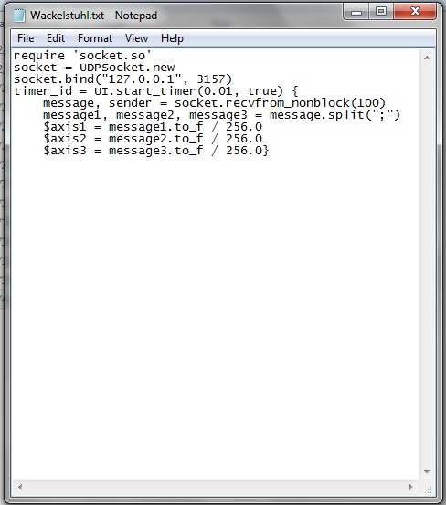

    I've found something in the "Wackelstuhl.rb" file that makes the 3rd axis inverted while simulation ...
    when this " 1.0- " is removed the 3rd axis is now doing exactly as what SimTools axis output requires " inverted OR not " .
    copy and paste the following lines into the "Wackelstuhl.txt" notepad opened file :
    require 'socket.so'
    socket = UDPSocket.new
    socket.bind("127.0.0.1", 3157)
    timer_id = UI.start_timer(0.01, true) {
    message, sender = socket.recvfrom_nonblock(100)
    message1, message2, message3 = message.split(";")
    $axis1 = message1.to_f / 256.0
    $axis2 = message2.to_f / 256.0
    $axis3 = message3.to_f / 256.0}
    save and rename it back to "Wackelstuhl.rb" again then processed with SimTools and sketchyphysics .

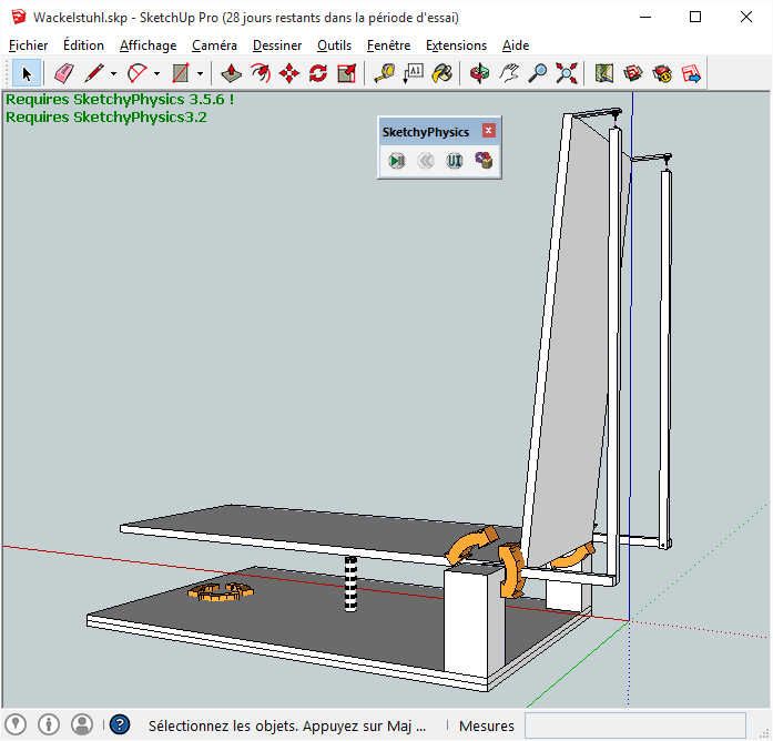

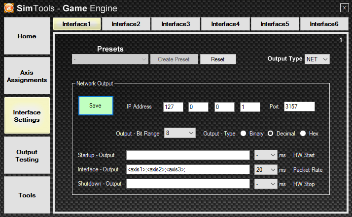

    Can you post a screenshot of your interface settings and does SketchyPhisics move the model when you have SimTools running and hit the SketchyPhysics Play button in SketchUp?
  18. frsim09
    frsim09 Member
    Jan 31, 2016
    33
    Ariège, France
    604Coins
    +11 / 0 / -0

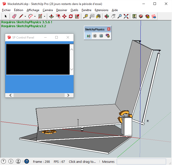

    Screenshot before hit the sketchyphysics play button:
    And after hit play button the chair reclines, and no more when Live for Speed run !
    Thanks @noorbeast

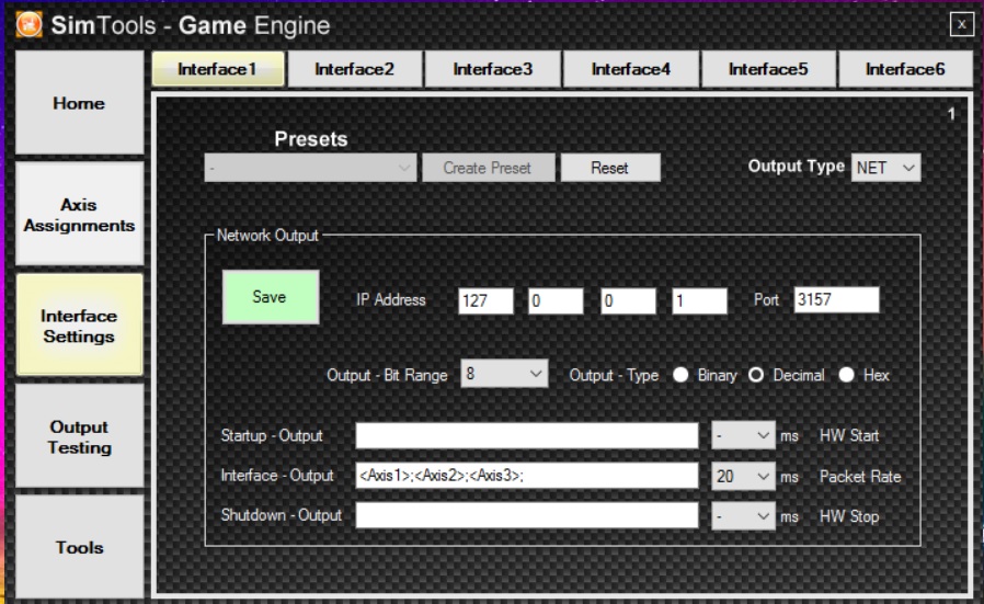

    In your Interface Settings you need to use a capital A like this: <Axis1>;<Axis2>;<Axis3>;

    Yes, i have already tried with a capital A, but with the same result !
