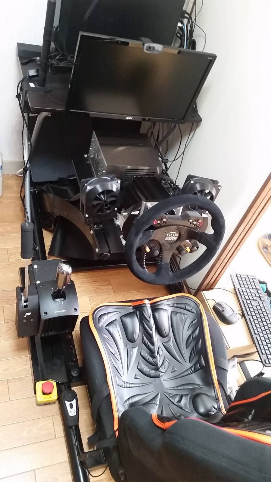

    I was asked in the Intro thread to make a project thread for my build, so here we are!
    Background: This rig is used exclusively for iRacing in VR. I mainly drive GT cars, and do a bit of endurance racing.
    My build as it currentlys stands is a Rosso Modello GTD-RS frame w/ the optional TV tray and shifter mount. I drilled some new holes in it to fit the Fanatec CSS1.5 and Augury control box/servo mount. The only other customization to the frame is a replacement bucket seat, as the original sports car style one developed a 10 degree twist due to braking forces.

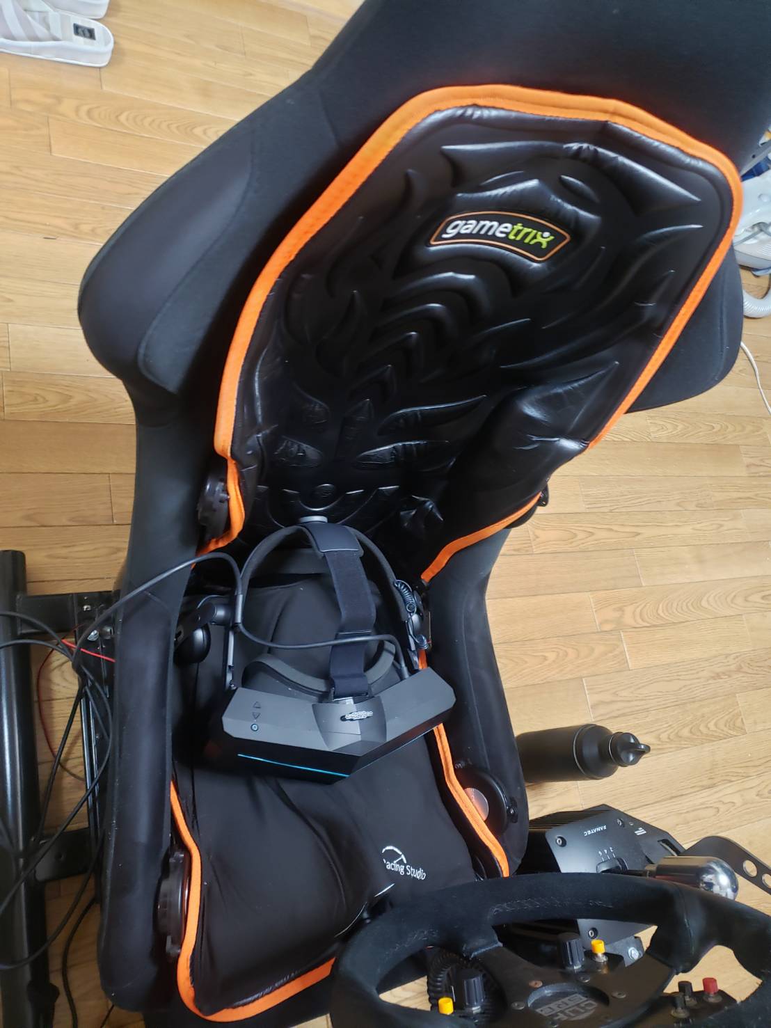

    At the moment, the only tactile feedback I have is vibration. I started out with a Jetseat, then added a Shakeseat as well. I had a spare Shakeseat, which I pulled apart and put longer wires on so it could be spred out more. As a result my seat has 8 ERM vibration motors and 8 Dayton bass transducers, with 14 independent channels between them.
    I'm a big fan of driver-side bass tactile feedback (as in, shakers etc in direct contact with the driver, rather than being mounted to the cockpit frame). It allows for cheaper/lower power hardware, noise-cancels without the need to isolate the rig, and ensures you can easily tell where each effect is coming from.
    The next step is motion, hence this thread. I have a Sim-lab P1-X on order to replace the RM frame (it has a ton of flex and would not hold up to motion), which I'll be adding the three-actuator setup from PT-Actuators to.
    I'll update the thread as things start arriving!

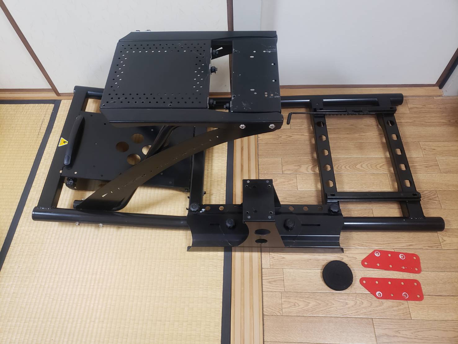

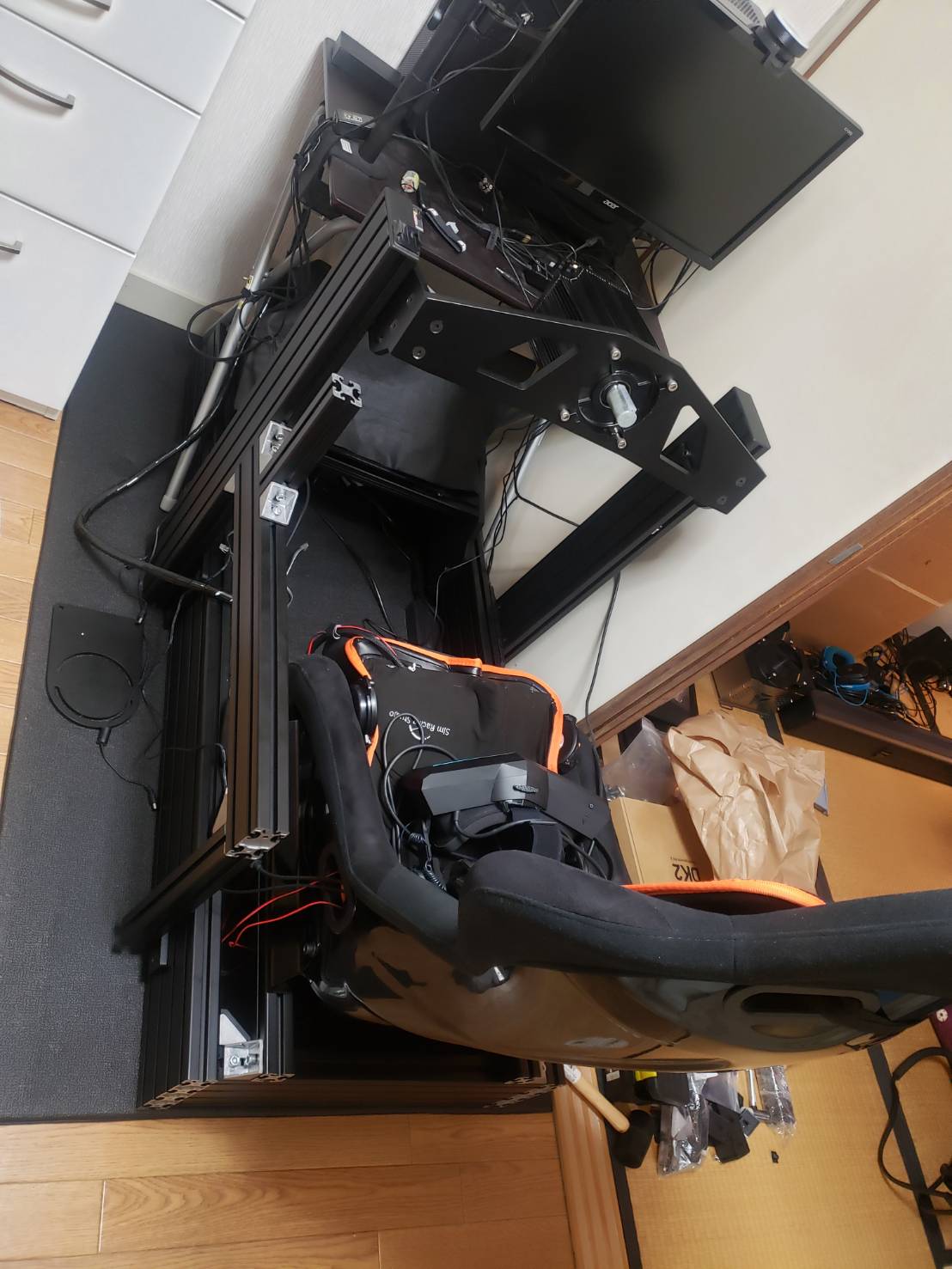

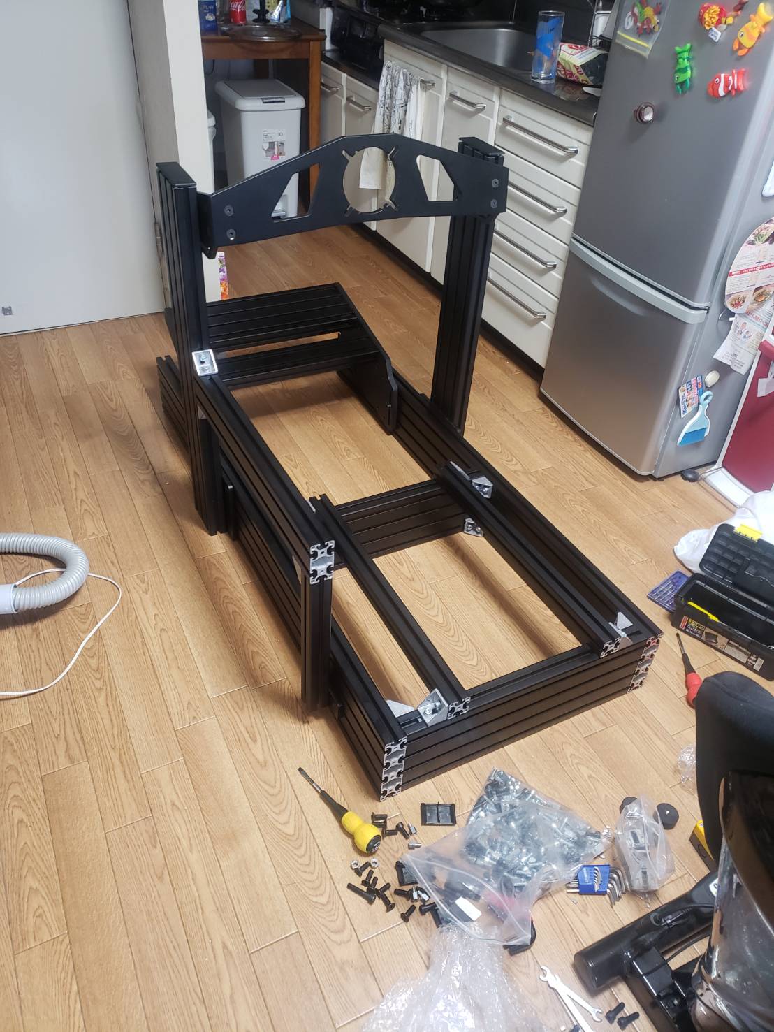

    Out with the old 10629048291554.jpg and in with
    the new!
    Gradually getting everything reattached to it... very, very solid piece of furniture, the P1-X.
    With my old rig, if I'd yanked upwards on the wheel deck, I could've torn the entire thing in half.
    With the new one I can pick it up by the wheel deck and carry it.
