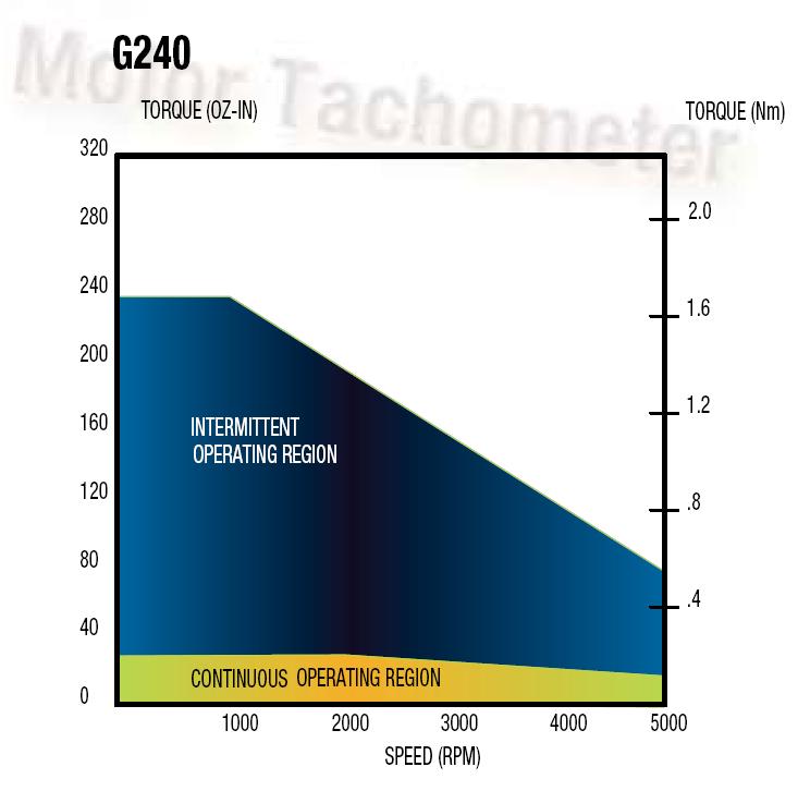

    They dont show you rpm/torque graf
    edit: now i try do some math for S28-400 and:
    if they have peak torque 3720 oz-in and torque const. (Kt) 6.57 oz-in/Amp so peak current is 566 A ! is it possible ? What power source you must have ...
    Force Dynamics probably use AC servo motor which are better (and mutch expensive).
