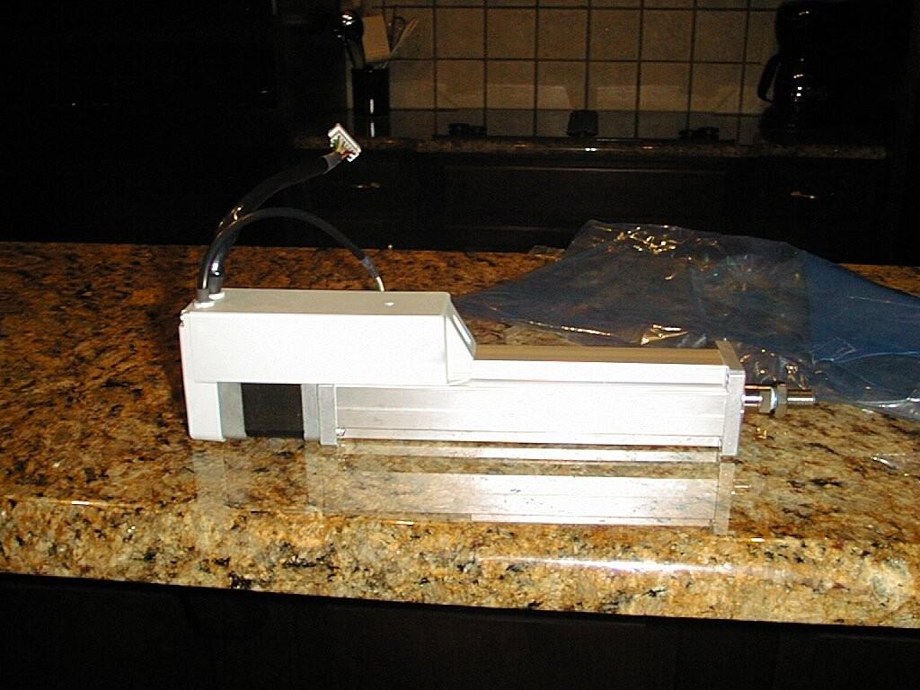

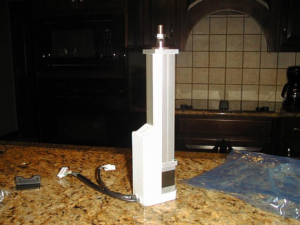

    SCN 5 Actuator Pictures

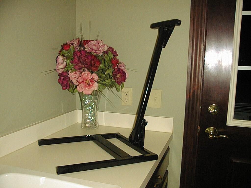

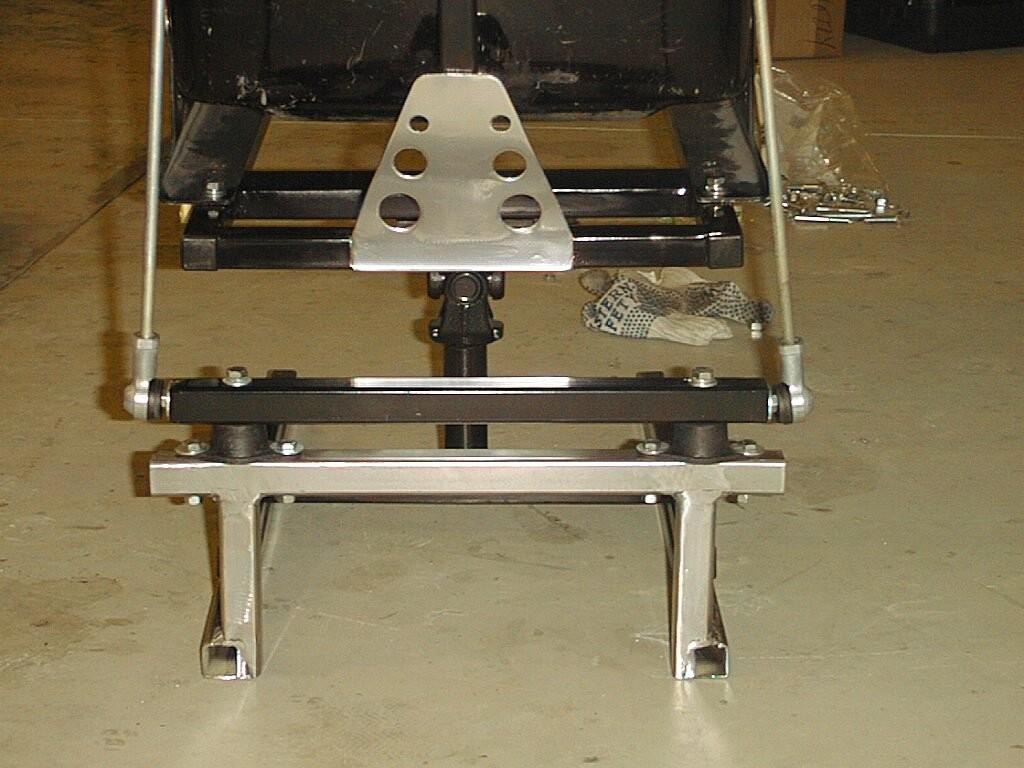

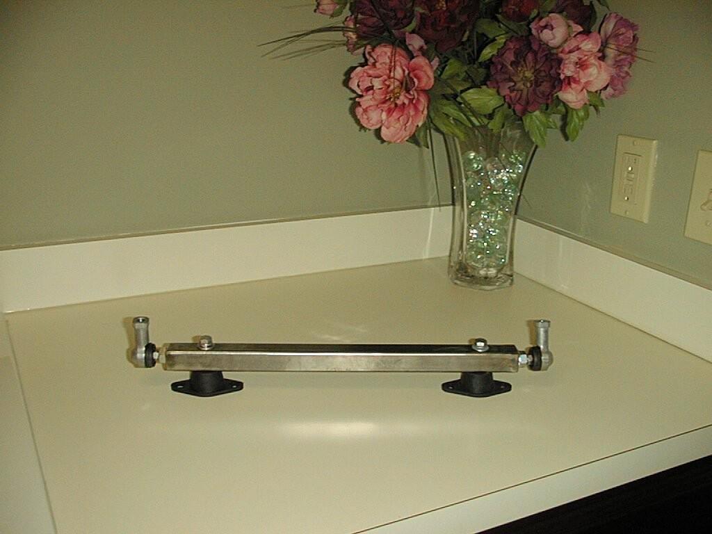

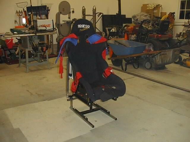

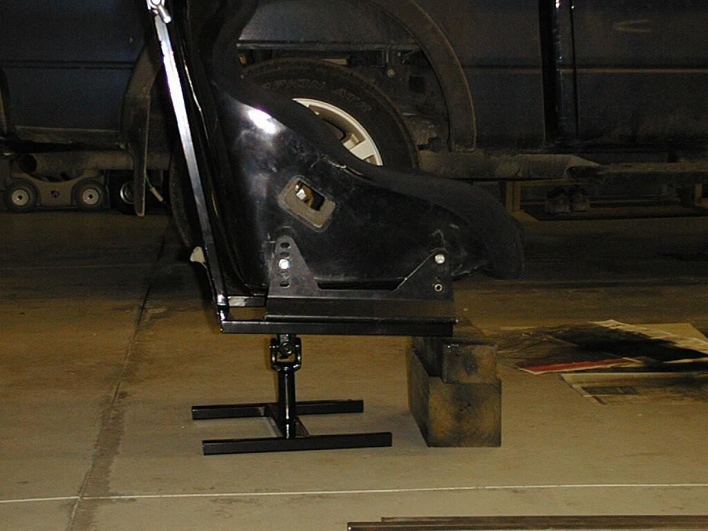

    Motion Base Being Built and On Temporary Frame
    Note, the base will go into my wooden driving simulator above once I have the final details worked out and the software is ready.

    Looks very clean - I made a mess everywhere when working on it - , did you weld all the stuff yourself?

    Thanks. Yes, I welded it myself, ang then used a grinder to smooth everything out before painting. As a finishing touch, I bought some plastic end-caps for the square stock steel and drilled and painted a few parts silver.

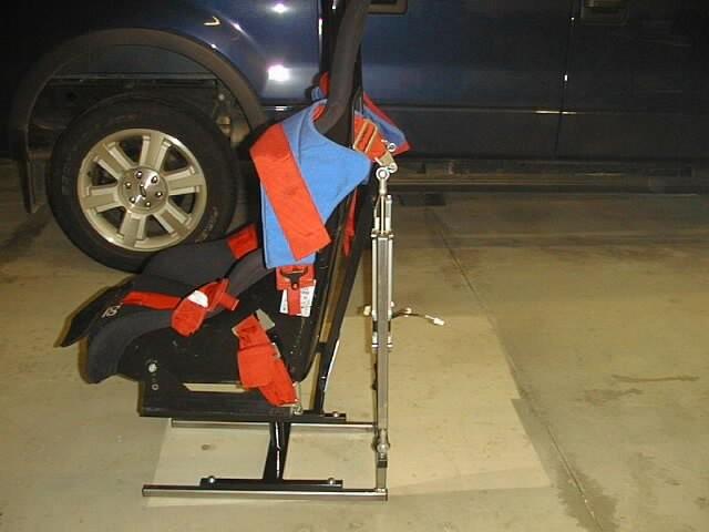

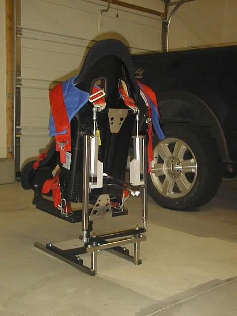

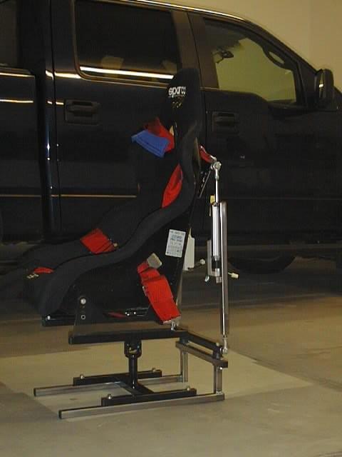

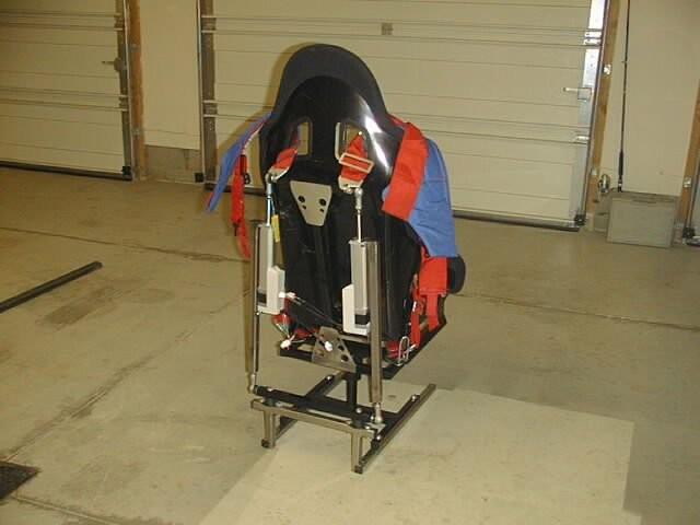

    Here are some more pics of my 2DOF with SCN5's on it's temporary base. It looks akward because it is sitting so high due to the temporary base. I designed it that way to fit in to my current non-motion simulator above once testing is completed.

    I like your idea with the damping bar :thbup:

    I think that your actuators can`t working accurate because the optimal push-pull position of your actuator-bars should not be vertical.
  10. Ringorumble
    Ringorumble Active Member
    Jan 20, 2008
    178
    190Coins
    +48 / 1 / -0
    Thats right, move the seat 5 -10 cm forward

    I have considered the seating position carefully. The silver part of the seat base is temporary and is for quick testing only. You are right, the actuators are more vertical than I would like them. When the remaining (black portion) of the seat design gets mounted into my wooden simulator (pictured at the beginning of this post), the bottom mounting bracket will be moved a few inches backward.
    However, do you really think that it wont work as pictured, even for a few days testing?
    I expected that it would and plan to test it as soon as my replacement actuator gets here. :( One of my actuators was DOA :(

    It will maybe work, maybe you will hear strange noises coming from the scn, this means too much stress for it so better do it right

    Thanks for the input. I'm trying to understand how you calculate this optimal push-pull value? I would appreciate any insight that you can provide.
    From what I can tell, the weakest link in my 150mm SCN5's is their radial load handling capability of only 5N / 1.12lbs. This would lead me to believe that the more vertical the actuators were, the less radial load there would be, and the longer they would last.
    The only reason that I can see why Frex has mounted theirs at such an angle is to provide stability. My unit will be bolted into another much large frame, so stability is not a concern.

    I think you are wrong in this point. You have to see the whole construction. Your SCN5 seem to push vertical in your setup, but as the construction, which is fixed to it, connects to the pivot-joint on the seat bottom, they have to translate the vertical motion into horizontal motion, which stresses the actuator.

    I see what you guys are saying, but do not agree.
    I would like to take a scientific approach to proving this out. I have already modified the actuator arm mounts to be able to function in the debated position (pictured), and 4 inches further back (as recommended by several of you). I am thinking of installing a small fuse panel and placing a 2.1 amp fuse per actuator. I am then planning to measure the amp draw of the actuator motors in both scenarios. I would have the fuses as a backup in case I am wrong to prevent damage to the actuators.
    I have a few questions that maybe someone could help me with.

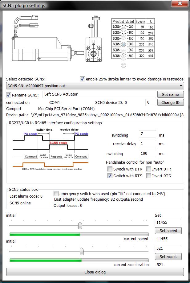

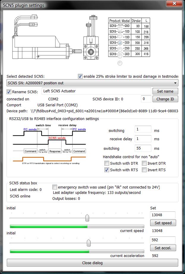

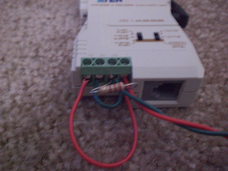

    I've been testing with the ATEN USB<-->RS485 adapters, and while they were a little unusual to wire up for half-duplex communication, they do work well. Here's a modified version of ego's diagram.
    With regard to the adapter:
    Left-Side Switch -> T-RTS/R-RTS
    Right Side Switch -> DCE
    180Ohm Resistor Between T+ and T- (1 and 2 according to the labels)
    Place a small jumper wires between T+ and R+
    Place a small jumper wire between R- and T-
    With regard To SCN5 Plugin Settings
    Uncheck all of the checkboxes in the 'Handshake control for non-auto' section except for 'Switch using DTS'
    NOTES:
    -This configuration does not include a kill switch. You should include one!
    -If you are using serial cables other than the ones I mentioned at the beginning of this post, these settings may not be the same for you since some cables reverse transmit and receive wires and others do not.
    -You should not attempt this without first fully reading the SCN5 Hardware and software threads in this forum.

    I ran my first tests with the Devantec USB<-->RS485 adapter that I purchased from TrossenElectronics.com. It seems to perform well and is achieving 139 outputs a second according to the SCN5 plugin. When I first started it up, it was only getting 43 outputs a second so I toyed with the timing numbers to get it up to the 139 outputs/sec.
    **EDIT - I'm no longer certain that the timing numbers cause the increase in outputs. With this USB adapter, the output/sec rate seems to vary much more so than the ATEN adapter. I'm a little confused about this and need to investigate further.
    I haven't had time yet to toy with the timing numbers of my ATEN adapter, but at the same default settings, they achieved 86 outputs a sec vs the USB solutions 43. It will be interesting to see which will provide the best perfomance.
    Does anyone know how many updates per second are reasonable, and at what number would the actuators become jerky?
    I will post the setup pictures sometime tomorrow. My camera batteries are dead.
