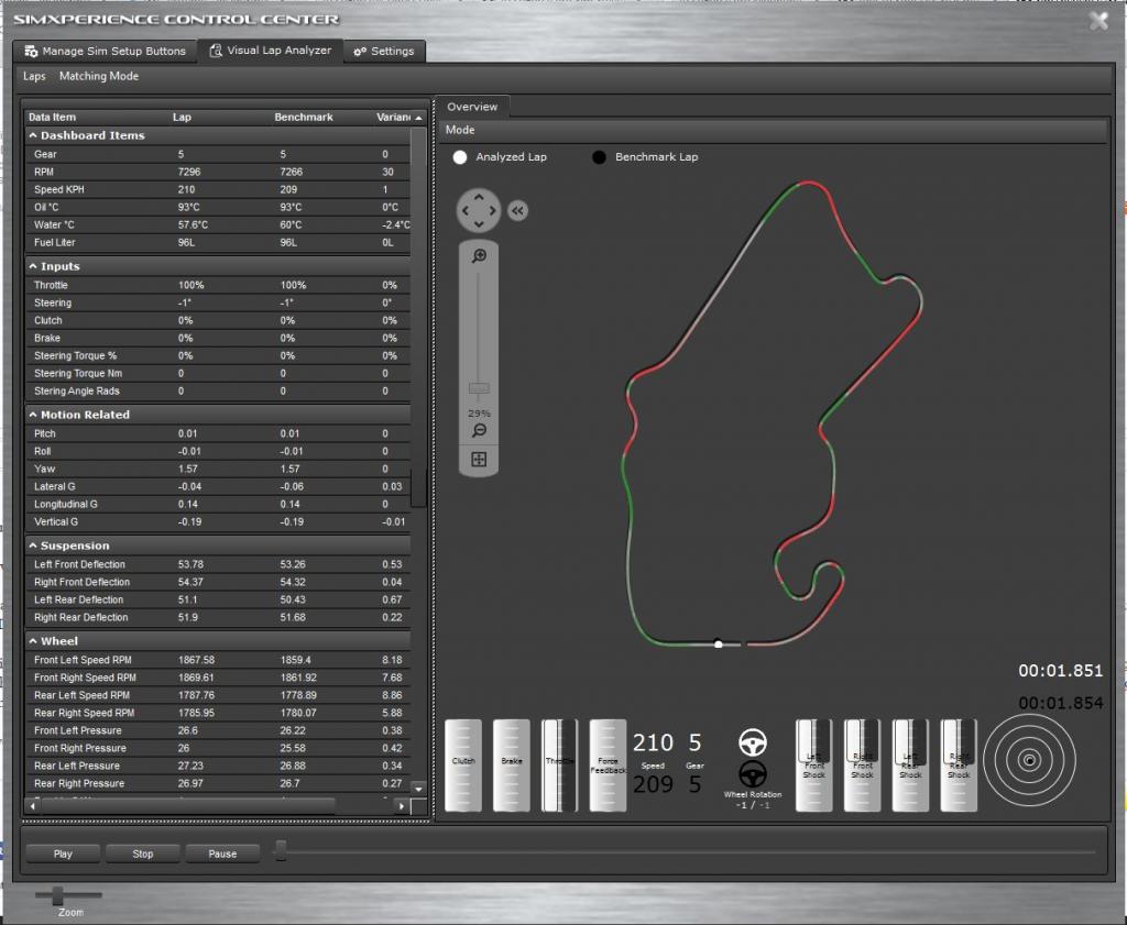

    Sim Commander does a really great job of the GS-4 but it also has a lot of other features that I like i.e SimVibe, in game on screen HUD overlay, a visual lap analyzer which records and analyses your laps then lets you play them back and compare them to other laps. Great for improving your lap times.
    Here is a screenshot of the lap analyzer, there is like another page of telemetry data also if you scroll down.

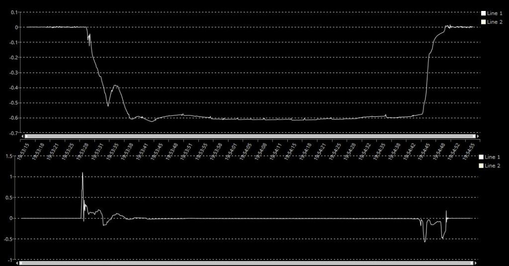

    It also has a really good graphing utility which I also use for setting my motion parameters. This is the SRF in iRacing on the skid pad, the top graph is the lateral G-Force and the bottom graph is the longitudinal G-forces but you can add pretty much any aspect of the game or telemetry to a graph.
