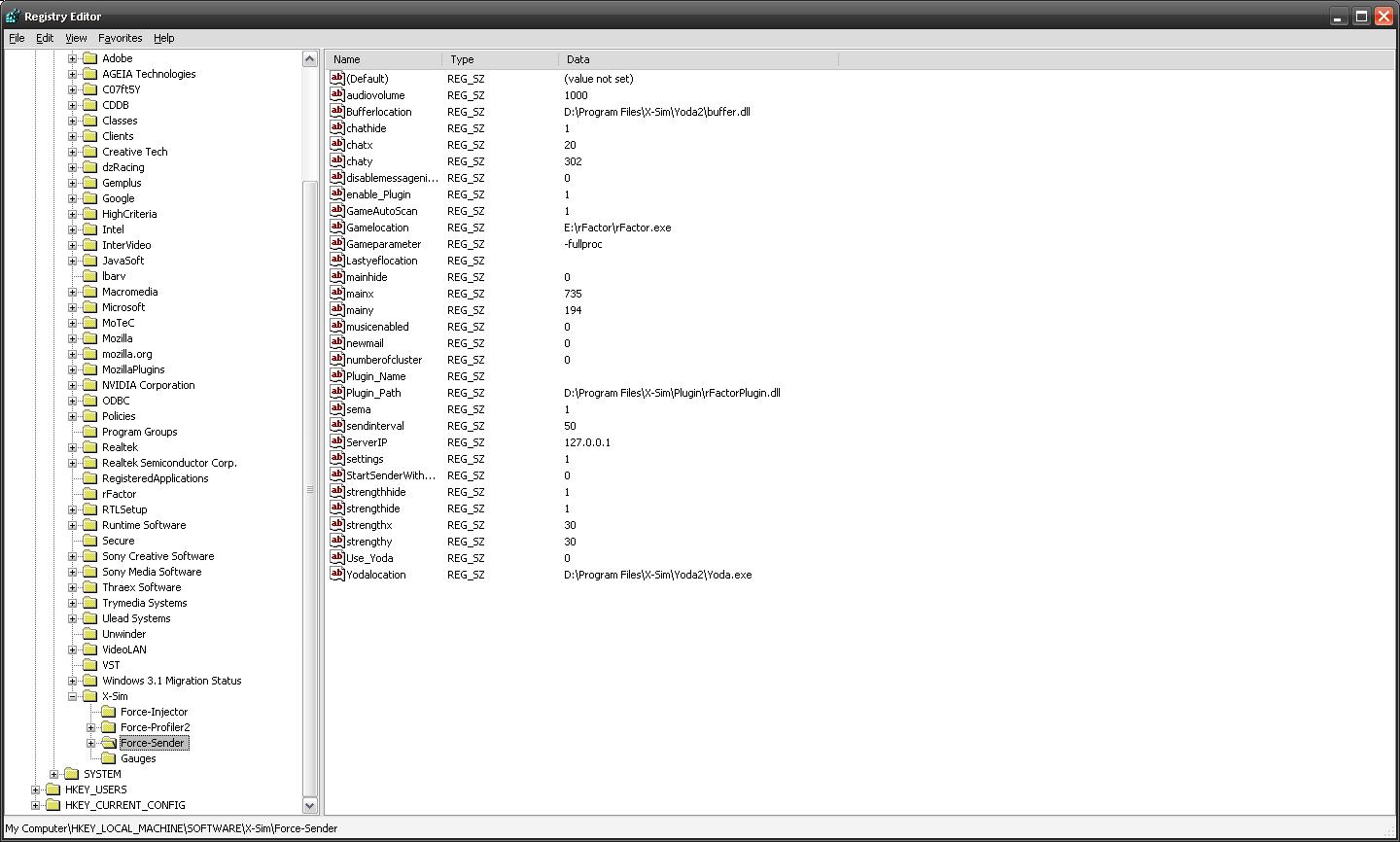

    BTW, I am just keeping this version of x-Sim to see if we can sort this out...
    Otherwise, I would have installed the old version back.

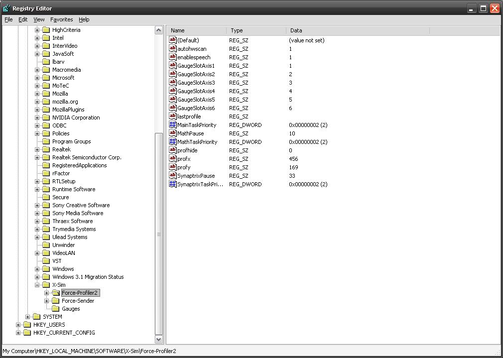

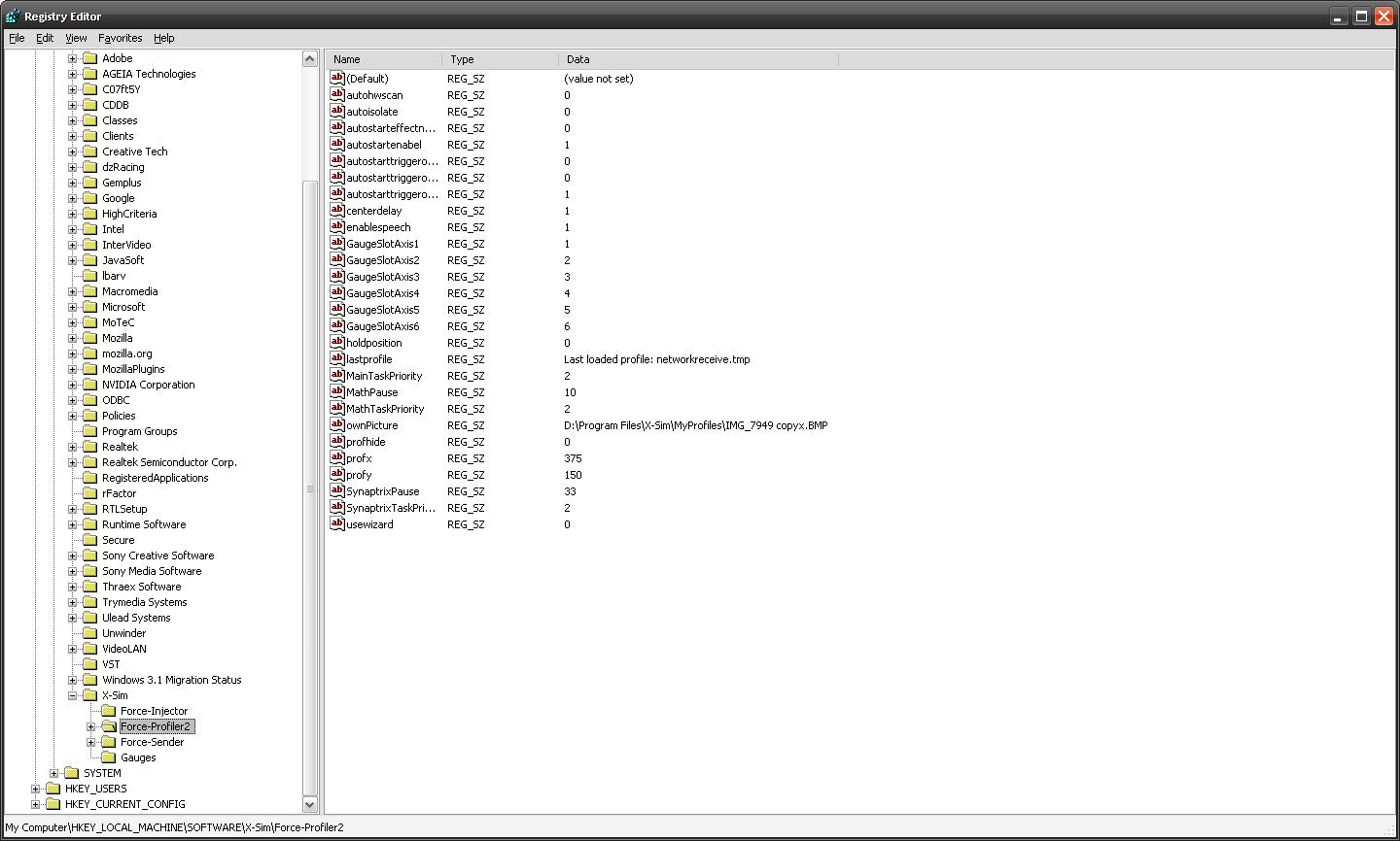

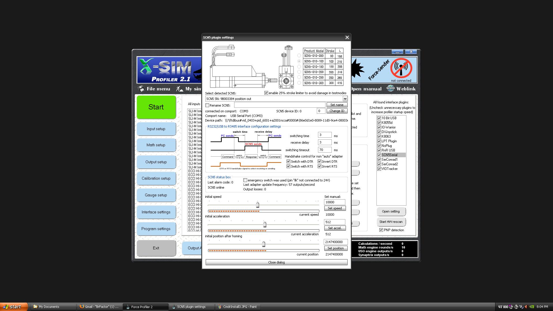

    @MasterYoda
    I began reviewing your settings, and it seems that with a few exceptions) almost every setting is contradictory to the settings recommended for use with the Commander software. I was under the impression that when you installed the Commander that you chose the 2DOF SCN5 Based Simulator settings option, but this is definitely not the case. It appears that you chose the 'Use My Current X-Sim Settings' option.
    This is obvious for several reasons:
    1.) You have every plugin enabled. The Commanders recommended settings automatically disable all unused plugins to improve the load time of the profiler.
    2.) Your timing settings are both uneven and higher than recommended.
    3.) The autoscan section appears to be manually modified. Your setting reads D:\\Program Files\\X-Sim\\MyProfiles\\SimXTemp\\SimXperienceFSDOutput.fsd which is indicative of an entry created by the Sender menu due to the unecessary double slashes. When the Commander makes this entry, it does not place the unecessary slash in the path. Were this entry created by the Commander, it would read D:\Program Files\X-Sim\MyProfiles\SimXTemp\SimXperienceFSDOutput.fsd.
    4.) Speech is enabled, and the Commander settings would have disabled it.
    5.) Your initial position settings are uneven, which will cause your seat to calibrate to an uneven position unless it is intended to compensate for an uneven physical design in your simulator hardware.
    I deleted my X-Sim registry settings and imported yours. With the exception of the Exchange dialog box (which will cause alot of problems and is yet another reason for the Commander provided standardized settings), everything worked well here. All lof this leads me to believe that you may not have the latest Commander update, or that your issue is related to the exchange dialog box.
    Do you see an exchange dialog box when launching a game from the commander? If not, we may still be facing some kind of no c: access issue that I have not yet discovered. I was going to configure one of my test machines to not have a c: drive, but I'm not sure how to do this. Even when I install to the d: drive, I am still able to see the c: drive. Can you give me some additional info on how to configure a PC this way.
    Finally, I would like to suggest that you give the Commanders settings a try. I think you will find that they are an all around improvement for you.
    Thanks again for your feedback. I'm looking forward to getting this core stabilized so that I can begin releasing some of the cool stuff (like in-game menus...a recent development that I'm excited about) for testing.
    EDIT: Please ensure that in your Commander X-Sim settings section that the following three checkboxes are checked(1-Single PC Setup, 2-Start Profiler, 3-Start Sender).
    EDIT: Also, in the profiler, when using your settings, I see an IP address of 0.0.0.0. This is incorrect, and should report an IP address of 127.0.0.1, or the actual IP of your machine. Please try entering 127.0.0.1 as the IP address for a single PC setup in the Force Sender 'manage network cluster' dialog box. Also, your send interval is 50ms!! This will cause you to miss alot of subtle effects. This number should match your timing numbers in the profiler in order to achieve optimal performance IMHO. Again, the Commanders recommended settings (gotten by selecting the 2DOF SCN5 based simulator option during initial Commander setup) would have set this optimally for you.

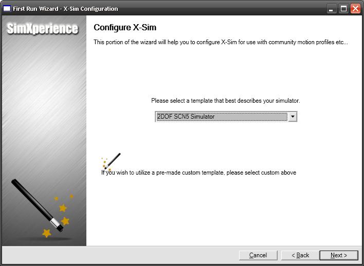

    Bernard,
    I DID select the 2DOF SCN5 Based Simulator settings option during installation.
    There was probably an installation problem form the Cmdr which did not set my Profiler properly.
    This would explain all these things you reported.
    I can try to remove everything and see if this newer version will do it right.
    3. Are you saying I typed \\ manually? I didn't even knew there was this temp FSD path, etc...
    The game autoscan does not work and requires that we point the game path. Would that be an error created by Cmdr during that manual game exe selection?
    Not sure about the exchange box? Pics?
    IP is ok here for the Profilem shows 127.0.0.1, remember, the profile works fine and comms with sender properly.
    Cheers,
    Erick
    P.S.: My installation is C drive with Windows 7, D drive with Win XP pro SP3. They are both two separate drives and WinXP is not able to change the C drive letter or write to as it is locked by W7.

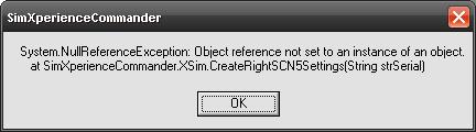

    Bernard,]

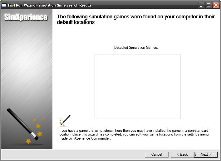

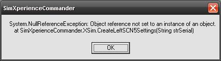

    Today, I did the following experiment.
    Removed the X-Sim and Cmdr completely.
    Deleted the x-Sim registry entry that remained there.
    New Boot and Cmdr 1002 fresh installation from zero.
    x-Sim 2102 was installed by Cmdr (although install screen says 2072 will be installed, not sure).
    No games were automatically detected (as I reported before):

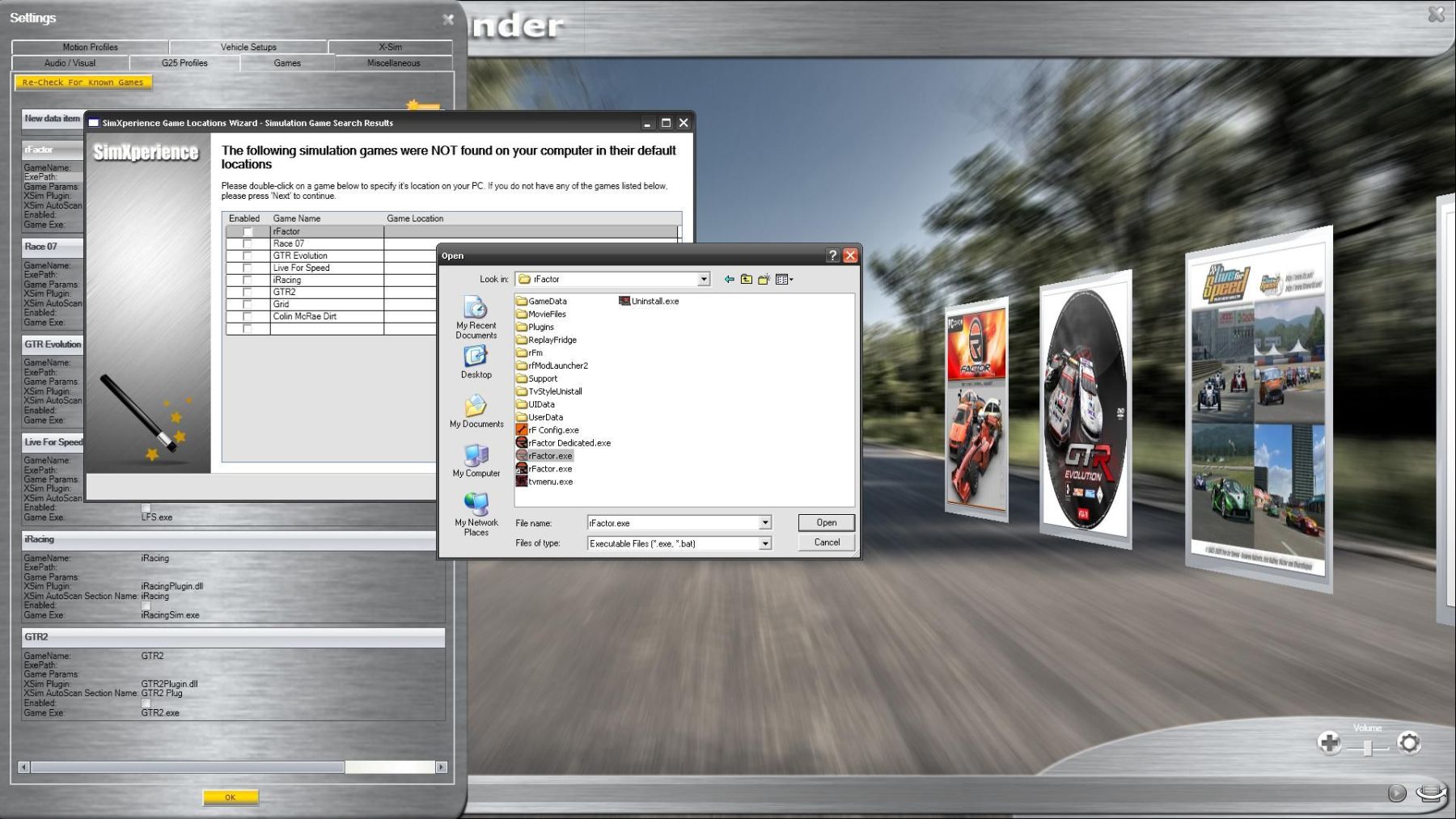

    2DOF SCN5 Simulator template selected (as before):
    Got two error msgs by the end of the installation (don't recall seeing them before):
    After running Cmdr for the first time, selected rfactor.exe location manually:

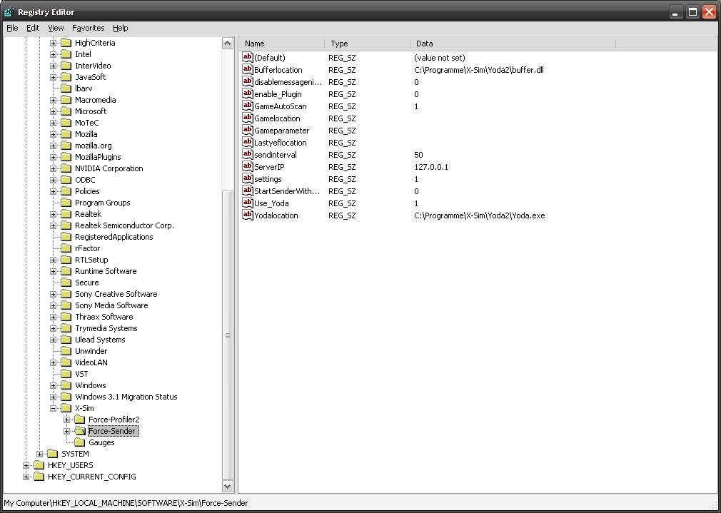

    As you can see, there we no changes at all on stock x-Sim registry settings, even the actuators names were not properly set, see the send interval, etc...
    Hope these details help explaining what is going on here.
    So, do you thing these issues can be worked around or should I forget until I have a regular Windows installation? :?
    Thanks.
    Erick
  9. bvillersjr
    bvillersjr Active Member
    Oct 11, 2008
    1,174
    Ohio, USA
    437Coins
    +22 / 1 / -0
    Thanks for the feedback Erick That finally makes the problem clear! Even though it is related to your unusual installation, the use of the Commander under these circumstances is a scenario that I believe to be reasonable and one that I am willing to support. I am grateful to you for your troubleshooting efforts! I will have a bug-fix prepared sometime tomorrow evening.
