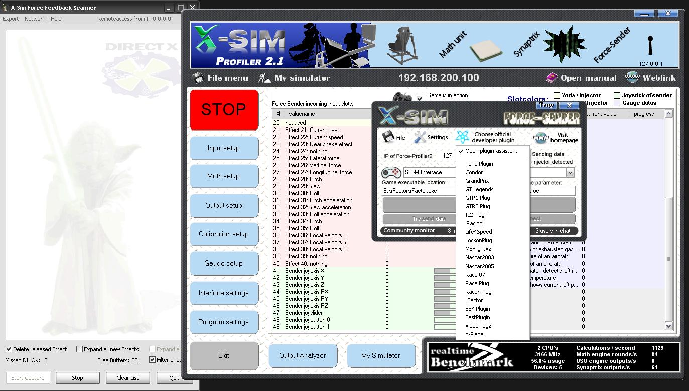

    Bernard,
    Still, the Cmdr is not able to make the motion start.
    When I alt+tab, everything seems to be ok, but for the Open plug-in assistant selected! Is that normal?
    Thanks.
    Erick

    Look, after the previous problem.
    I don't leave the track, I alt+tab, close the sender and open a new instance.
    Then, everything works fine, but I can see that rfactor plugin is properly selected...

    Hi! Bernard,
    After you click a quick launch button, the Commander generates an FSD file and launches it. At this time, the game is also launched. If you ALt-Tab out of the game, you should expect to see the correct plugin selected in the Force sender, and for the 'Try Send Data' button to be gray because it has already been pressed for you.
    That is exactly what I mean, I alt+tab from the game (car in the track) and there is no plugin selected.
    he only way that I know of for this to go bad is if you added a game yourself, and did not properly enter the name of the plugin dll that should be used when launching the game.
    Can you please provide some more detail as to the exact steps taken?
    The only thing already selected is the default FSD for rFactor (this is set in the plug in assistant).
    As I said, it works fine if Cmdr is not in control.
    Let me know what you think.

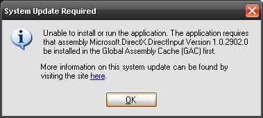

    Sorry Bernard, but I got an error msg trying to update the Cmdr:
    I have Dx 9.0c (4.09.0000.0904) installed.
    Does it mean I need something newer than that?
    Thanks!
    Cheers,
    Erick

    I will check into this dependency tonight. This assembly is being used to determine what game controllers are installed so that we can have customized functionality for each steering wheel type.
    This is the first attempt at deploying this. I apologize for the inconvenience.

    Corrected and available via automatic update. Thanks for the feedback!

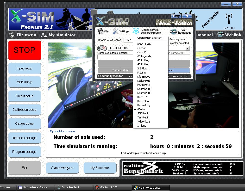

    Bernard,
    Still same issue here.
    No motion, when I alt+tab from the track, the open plugin assistant is selcted, no plugin.
    I can hear a chime, I believe the Profiler is trying to open the Plugin Assistant, indeed.
    It may not have been able to correlate the fsd to the game.
    But the Assistant is NOT visible to me.
    I tried to send my setting to the cmdr support using the new button, but it said, not yet implemented.
    Let me know if you need additional details.
    Thanks.
    Erick
