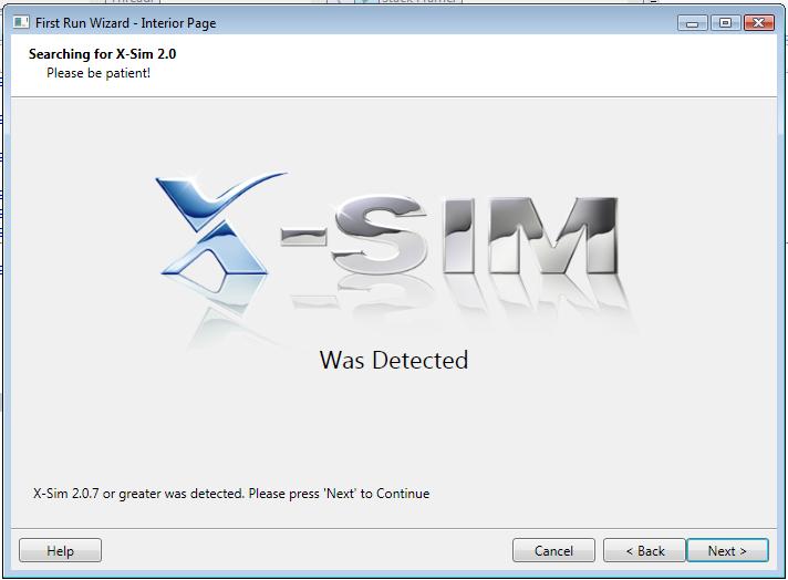

    Making Setup Easier
    I have developed a wizard that will install X-Sim and allow users to choose from X-Sim configuration templates. In this way, we can eliminate much of the technical work for non-technical users by pre-packaging most of the X-Sim registry entries and file configurations in a templated fashion.
    Here is a video of the pre-alpha wizard, which highlights my intent for this wizard: http://www.simxperience.com/files/SimXCommanderVids/FirstRunWizard/FirstRunWizard.html

    Hi Bernhard,
    please use the blue X-SIM Logo...the green one is not the right one!
    You can download it here. It´s psd. There are layers, so you can switch of the grey background. If you need background modification or another format, i will help you:
    post10353.html#p10353
    Kind regards
    René

    Done. Thanks for reminding me about the blue logo. I think this one looks better.

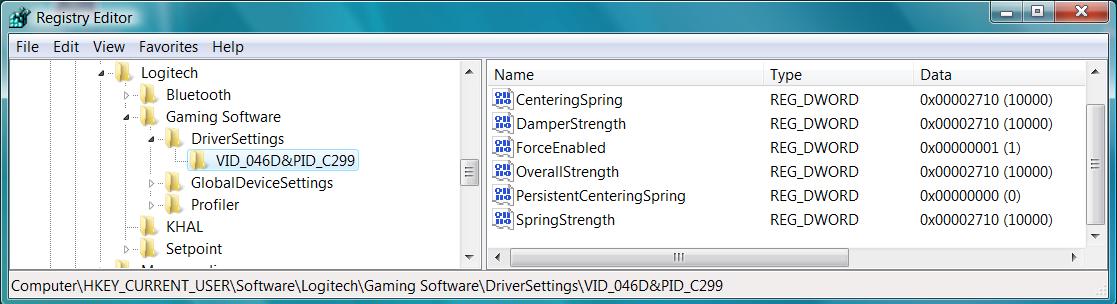

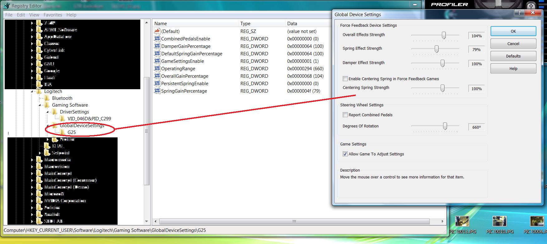

    Alright, so I'm not going to offer a tutorial because I don't know enough yet to be certain and I dont want to be responsible for anyone damaging their G25. I will tell you what I know so far.
    There are two registry sections that pertain to the G25. The first is the same section that you see when you edit the global settings in the Logitech gaming software. Here they are:
    The above are not really the Global settings. They are simply % gain values over the real settings. The real driver settings can be found in the following registry section.
    Use this information at your own risk.
    Here are a few notes from what I know so far:
    -By my approximation, the maximum values here are 15000. I have not tried any settings beyond this yet.
    -In order to prevent the shaking mentioned above, you must have the right balance between the damper value and strength value
    -Turning the damper up too high negates an increase in the strength value
    I have not found the best balance yet. I was able to turn up the overall strength to 15000 and not increase the damper value. Of course this causes crazy shaking. I am working on modified game FFB files that will reduce this shaking wihile leaving the increased strength.
    If I am successful in this then it would workout well as an addition to the Commander because we could launch all of these settings simultaneously.
    So many projects....so little time :eek:
    EDIT: Also, the settings shown above are defaults intentionally. Until I understand these values better, I do not want to publish numbers that others will copy/paste into their registry and cause possible damage.
