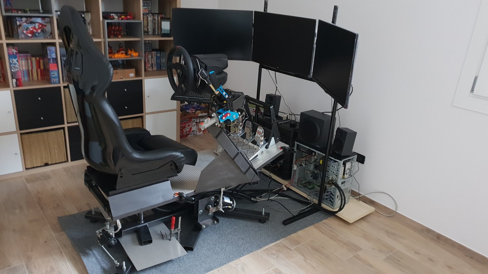

Simulatore 3 DOF Velleman/Arduino/Sabertooth

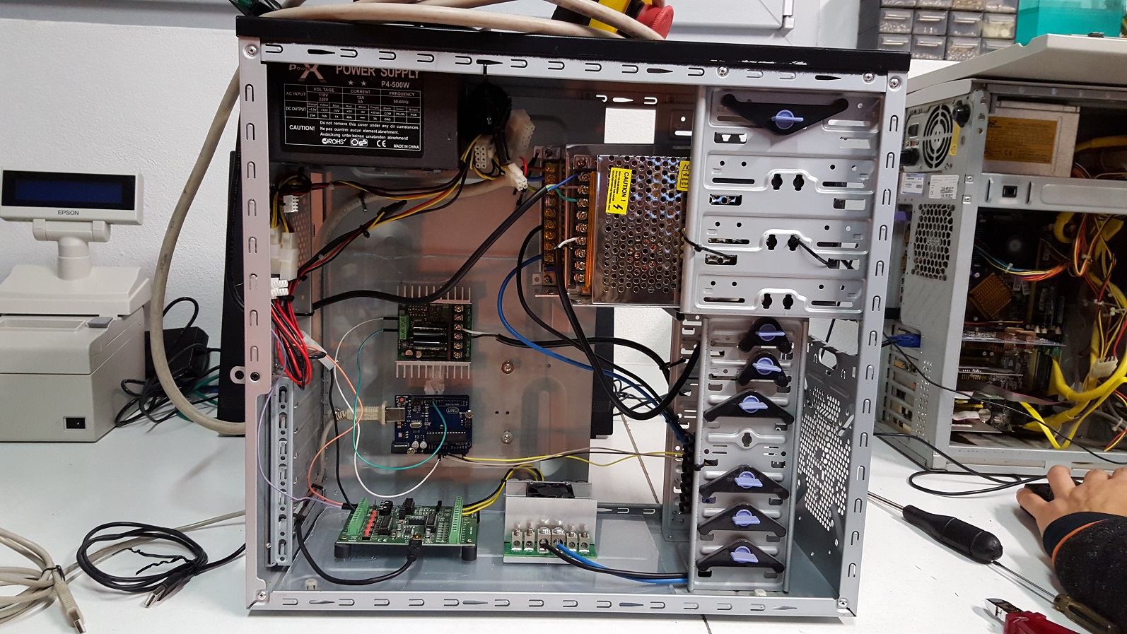

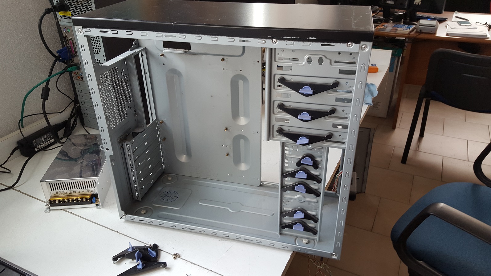

    ... a pc case to contain all the electronics
    For front engines:
    Velleman k8055 - Sabertooth 2x 60 -Power Supply 12v
    For the rear engine:
    Arduino UNO - Sabertooth 2 x 25 - Power Supply 24v

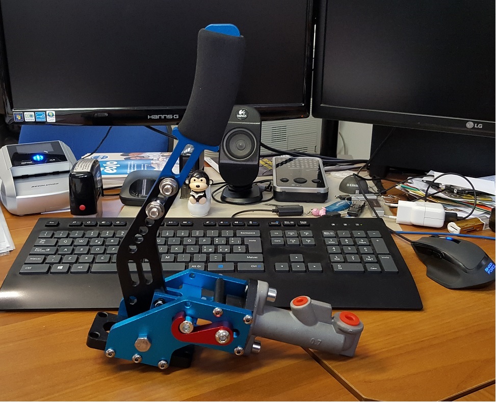

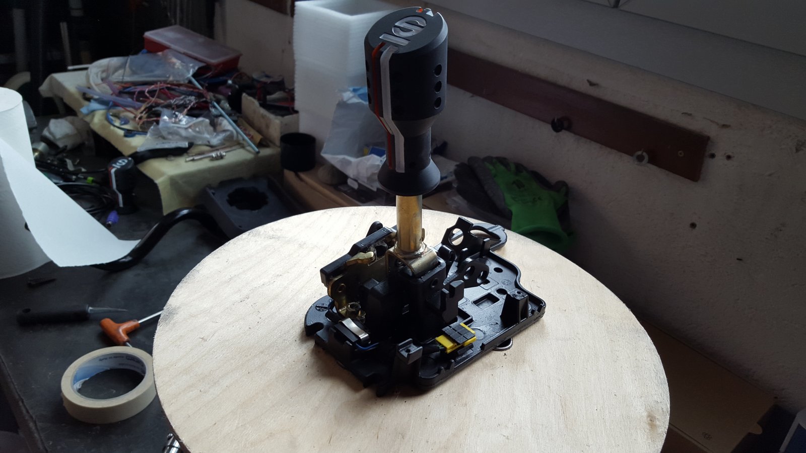

    Bmw sequential gearbox:

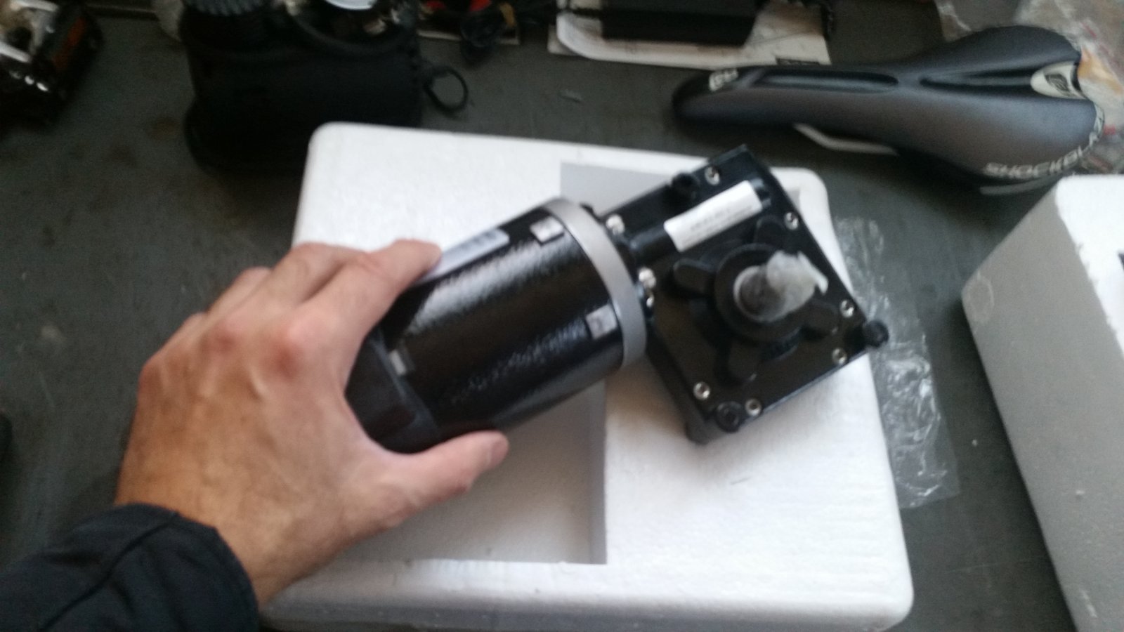

    the engines of the old simulator:
